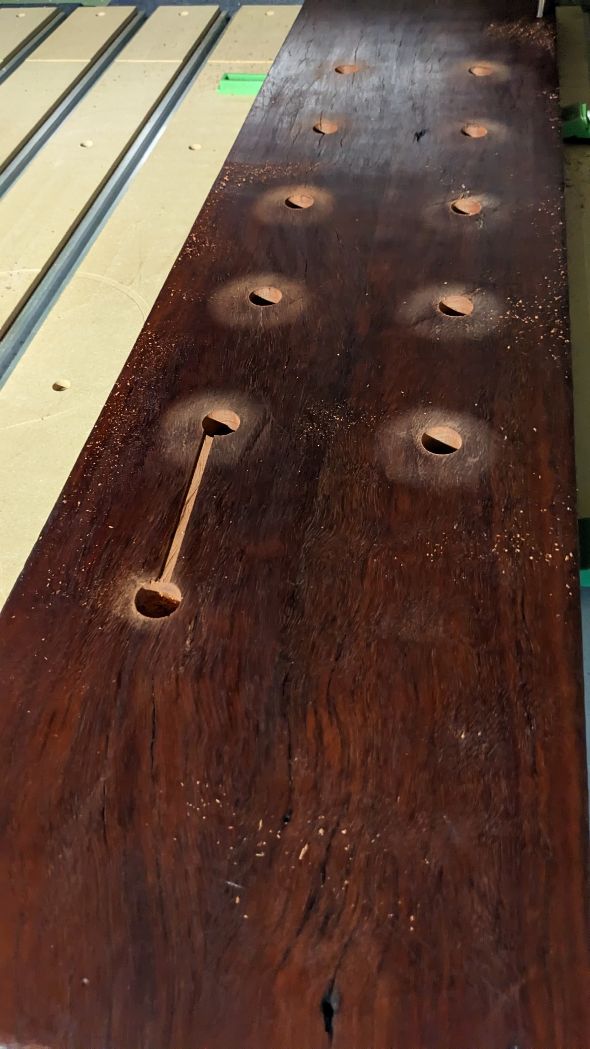

I was drilling out dog holes on a beautiful thick hardwood slab I’m turning into a bench. I’ve been lovingly hand planing and scraping and oiling this wood for weeks… It’s all going swimmingly until all of a sudden it just decides to cut a move a couple of mm right into my material.

I don’t understand why this has happened. The preview seems fine. All the holes are the same operation.
I
Ran the bit along from front to back and if anything it gets slightly higher at the back.

Possible reasons are:
Work lifted from work holding temporarily.
Cutter loose in collet and dropped.
Z axis needs servicing and didn’t move the required number of steps.

Here are several reasons that come to mind.
If you are using a down cutting bit there could be a build up of chips under the material when you reach the spoil board. I see from the picture the clamps are on the side and being clamped like that there is no or not enough down pressure to keep the material down.
If the Z axis skipped steps I would check the wiring and connections for problems.
The bit could have slipped in the collet. check for a build up of sawdust in the slots of the collet and in the router shaft.
I would also give the machine a mechanical check and verify all fasteners are tight.
There is a very slight chance the supports for the gantry or the Z assembly could be lose and shifted in the last move.
All the above and more could be the issue. Check for chips under the material, do a mechanical check and use the jog function to move the machine without the router running and listen to the sounds of the motors for any changes.

The stock didn’t budge. I was using a straight cut, and it’s well secure. It’s also some of the heaviest wood in existence, picture that in bricks, and the bottom isn’t smooth. I can shove my body weight against it from front to back (where there are no clamps) and she doesn’t budge.
The bit likewise is well secure.
Each hole is progressively deeper so I reckon maybe it was grinding on the hard end stop just a tad with each retraction and that built up over time until disaster.
Is there a way to tell the shapoko to stop any job if a soft end stop is triggered? It’s honestly always baffled me why it even will run a job that tries to send the machine outside the build volume… But yeah. What’s the point of having end stops if they don’t trigger the job to stop? :woman_shrugging:

Ultimately, you need to have the retract/safe height set correctly. You only need to set it high enough to clear any workholding, if any is above the stock. If I’m side clamping then I’ll set it for like 1/8"… less if I know the material is dead flat and level.

I had set the retract to 3mm, so the same as you suggest. It’s not dead flat, I hand planed it.

When this error happened did the bit plunge into the spoil board. Did you stop the machine when you noticed the problem?
My first thought still is an issue with the Z axis and it was skipping steps/losing steps. Can you operate the machine without the router running and move the spindle in all directions and wiggle the connections while doing this and see if the machine skips steps or the motor changes sound when doing this.

I stopped the job, it didn’t plunge through dunno if it would have, but it did seem like each hole was deeper (they didn’t go all the way through) so I think my “barely grinding on the hard z endstop with each Z hop” hypothesis makes sense.

Taking a closer look at your picture, the material is short enough that 3mm is not enough to hit the Z homing switch. It has a good 4" of Z travel, and judging by the heights of the clamps, it looks to be 2"-ish. If that’s the case, then 2" x 3mm is under the amount of travel that it should hit the Z. Unless you had a lot of endmill stickout and didn’t reposition your router upwards in the mount to account for the long tool.
If you are running close to limits on things and a low retract/safe height, then your material needs to be flat. That’s just the math of things.
