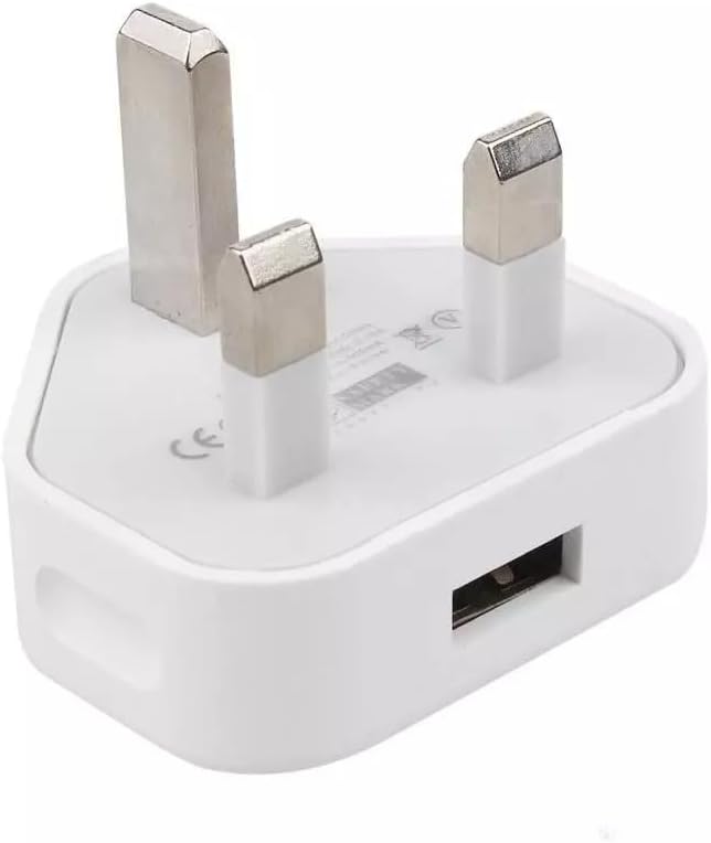

So I live in the UK and we use 3-pin plug’s that looks like this:

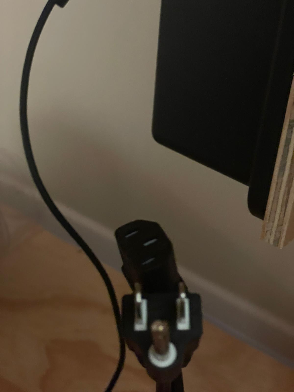

I have seen that the power cables for (a) the Controller and (b) the Chiller have an american-style plug that look like this:

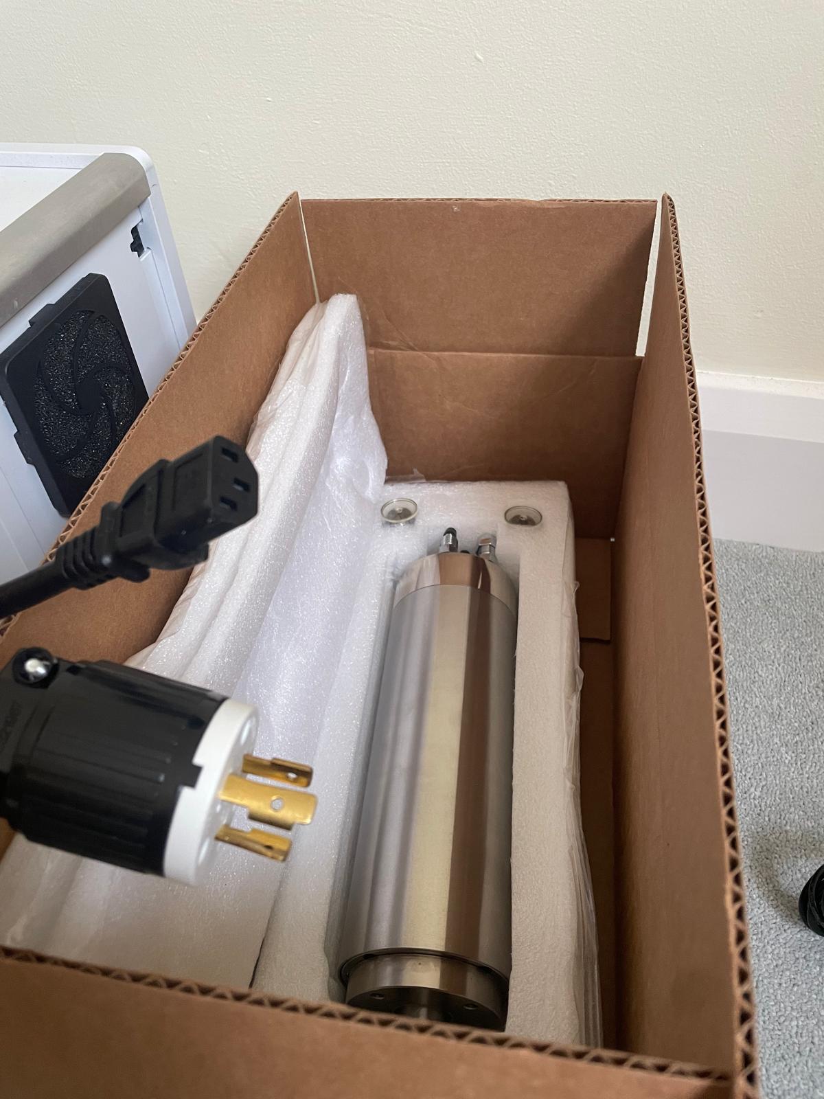

and (c) the 220V 80mm Spindle has an american industrial-looking connector, that look like this:

@Luke So, just to be 100% absolutely crystal-clear in my mind here so I know we’re on the same page:
I CAN buy 3x this same kettle cable (from the amazon link I shared above) and use this said cable for all of the items mentioned as viable power cable replacements to the ones sent from carbide3D:
  • the 80mm spindle (220V) - really my main reason for my asking for crystal-clarity
  • the chiller,
  • the controller, yeah?
I apologise for being so pedantic about it but its just so I know I’ve communicated this properly and there’s no misunderstanding.
If so, I’ll get those on order immediately with great haste and relief! :grin:
That “American style plug” is actually an “international” IEC C13 plug. So C13 is the term to search for a compatible cable. Add in “UK” if you want to filter out the cables with an actual “American” NEMA 5-15 plug on the other end.
The cable you found will work for the chiller and controller, and will probably work for the spindle, but it’s fused for 10A. If you ever run too close to full power (which admittedly almost never happens), you may blow that fuse. You should ideally get a heavier duty cable for the spindle if you want to avoid problems.

I’ll do that with this cable but I’ll look for a better replacement in the meantime. I can’t find any cables that are all: (a) directly IEC C13, to (b) directly UK plug and (c) wire thicknesses rated above 10amps. There’s some that say ‘13 amp fused’ but the wire guages themselves are still only rated for 10amp, so that’s more dangerous than just having the normal 10amp ones. Therefore, I’ll purchase the following as their wires are 1.5mm^2 making them rated to 13 amps, I believe (the 10 amp ones are between 0.75mm^2 - 1mm^2
C13 to C20 power cable
C20 to UK Plug Power Cable - would prefer this to be 2M instead of 3 but it’s the only listing I’ve seen so far that actively states the 1.5mm^2 wire thickness, without me having to buy it and look at the decal printed on the side of the wire
