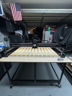

We walked through the troubleshooting prior to posting and still are having the same issue. All switches are working and tested. No debris, All connectors and wiring looks good. I’ve read on a few other posts that removing the existing zip ties may unbind a particular wire, but given the switches all work, not sure thats the next purdent step. Still waiting on support to get back to us. Hoping they have some additional suggestions.
Picture of set up:

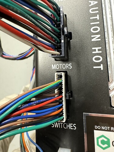

Problem solved.
After following all the trouble shooting and back and forth with support with the issue persisting, I decided to test all the individual wires for connectivity and found one of the black wire’s terminal was not pushed all the way into the switches pin connector.
Initialized and ready to go.
