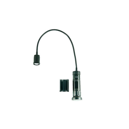

I dont have an led strip under my SO3 XXL and am considering getting some as well. However I do have a Rikon LED portable light with a magnetic base that I use so I can see the marks for a center x and y positioning. I have found it very useful for a lot of things around the shop.
The mounting piece is magnetic as well as the bottom of the light. I just clip it on the front left corner of my Shapeoko and turn the flexible light so I can see the marks on my material.

Love it :slight_smile: I have 2 articulating LED flashlights with a magnet in the butt end. they live attached to the I-beam curtain rod that my vacuum hose is suspended from. I can articulate them to where I want or I just pull them off. :slight_smile: Love the Rikon LED portable light. I will have to look at an upgrade :slight_smile:
