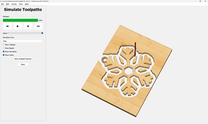

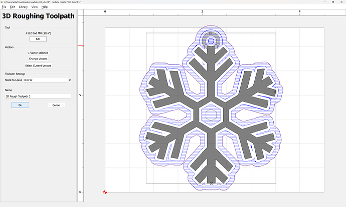

You have modeled this to be higher than the stock (indicated by red):
Kind of mystified by why you are using 3D.
If you have the 2D geometry:
It’s trivial to just offset to the outside:
Apply
Then cut as a pocket:
twice:
which previews as:
Unfortunately, a smaller tool will need to be used:
Uploaded as a v8 file.
snowflake-03_v8.c2d (540 KB)
For the surfacing of 3D areas, if you create things to match the stock thickness:
then the top will not be cut when roughing:
but for finishing, that seems to be intrinsic to the 3D process:
