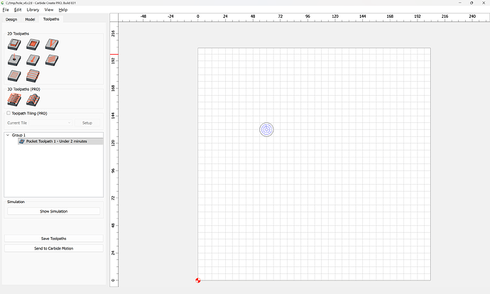

I downloaded the latest Carbide Create for my Nomad 883, build 831. Then I create this file:
http://www.frank-buss.de/tmp/hole.c2d
and saved the toolpaths to the same file, since the G-Code export is not free anymore now. Then I installed the latest Carbide Motion, build 649, and it doesn’t load the file, says a lot of “unknown character” messages. How to fix this?

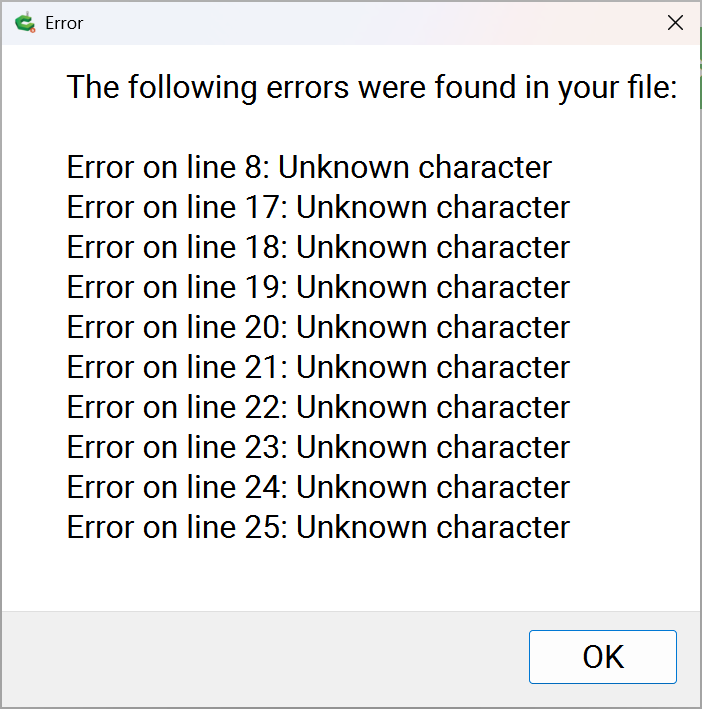

The error message I get is:
when loading from
"C:\tmp\hole.c2d"

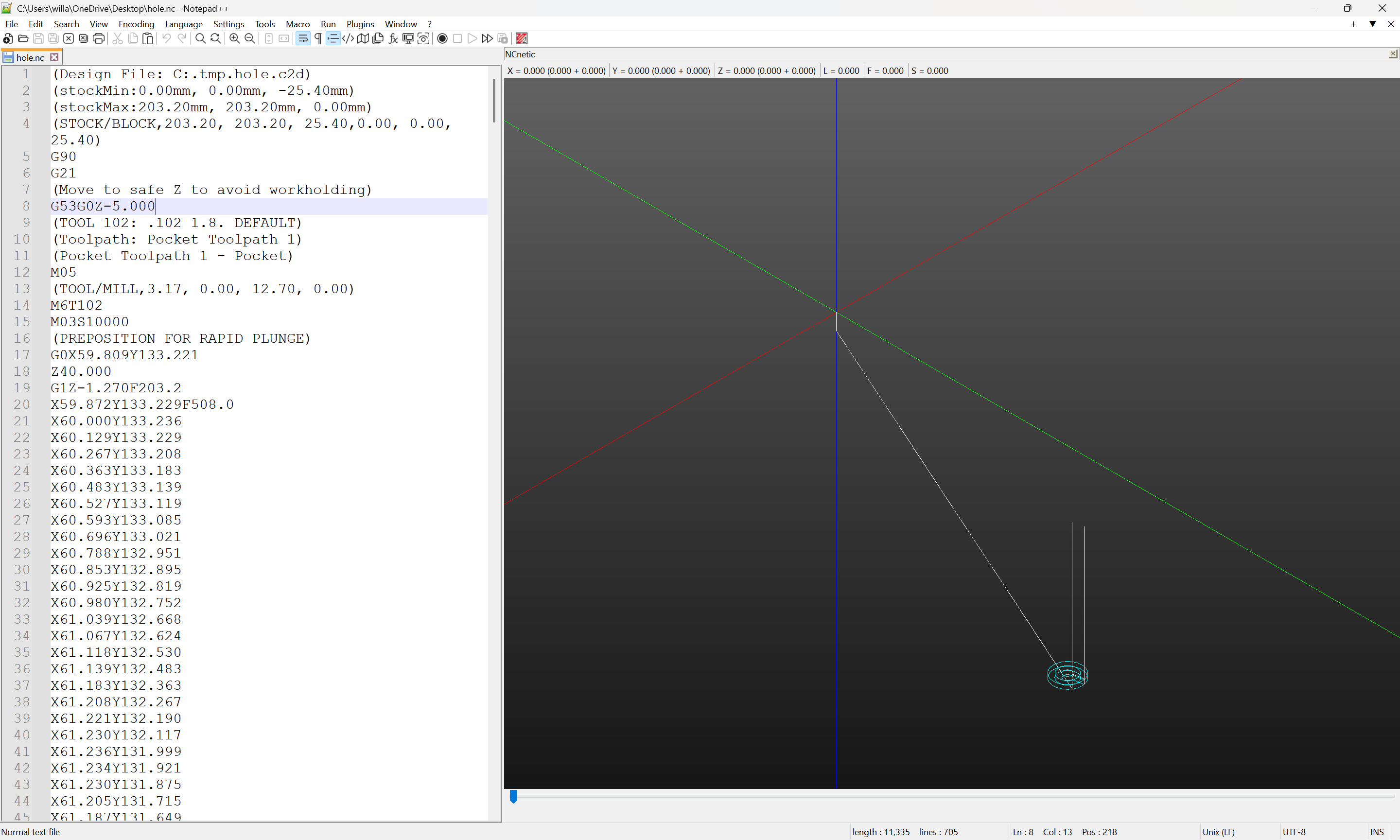

Exporting G-code doesn’t show anything unusual on those lines:
and the exported file:
hole.nc (11.1 KB)

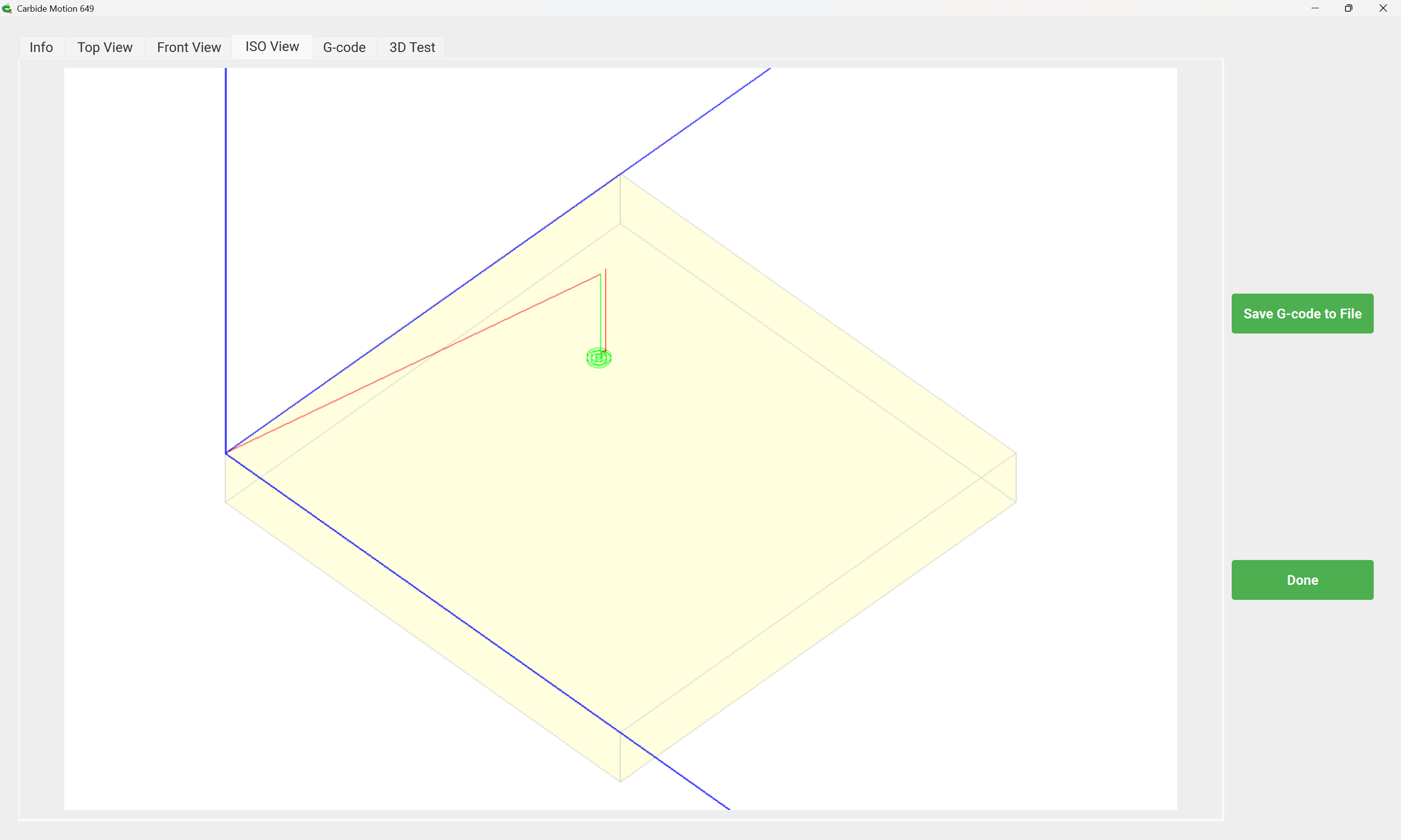

loaded as expected:
Opening the file in Carbide Create and writing out the toolpaths as a .c2d file:
hole_v8.c2d (44 KB)
also loaded as expected:
so there would seem to be some sort of problem on your computer with how toolpaths are being generated and saved into a .c2d file.
If you have this problem again, please send the file in to support@carbide3d.com and we will do our best to look into it.
EDIT: I did have one thought — what is your decimal separator set to? If comma, please change to period, re-save the file and try again.
Thanks, this was the problem with the decimal separator. I guess because I tried to open an old C2D file, which failed, that somehow it was set to comma after this. I started Carbide Creator new, create a new file from scratch, and it works now here, too.
If the commas are already in the file, there’s not much we can do, but this beta might handle one edge case a little better, if this was something that came up in 831:
EDIT- You’ll need to reload and save the file in that new build of Carbide Create.
