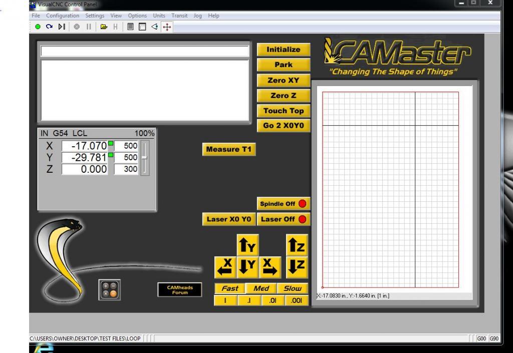

But why do you need to do it in two steps? Why not just one step? Is there some process that makes the first step useful without the second one?
The first is just to select the zeros screen. The second is to deal with actually zeroing the machine. One is just a UI choice, it’s the “Zero All” that you’re hitting that does the work.
Depending on how one is zeroing, setting the zero may take 3 separate jog and set operations - one per axis. UI choices are largely at issue here. On other systems, all of this is on one screen - but then it looks scary and complex.
mark
P.S.
This is the control screen of my CAMaster. It does everything that CM does… and more… but complexity is exposed.
