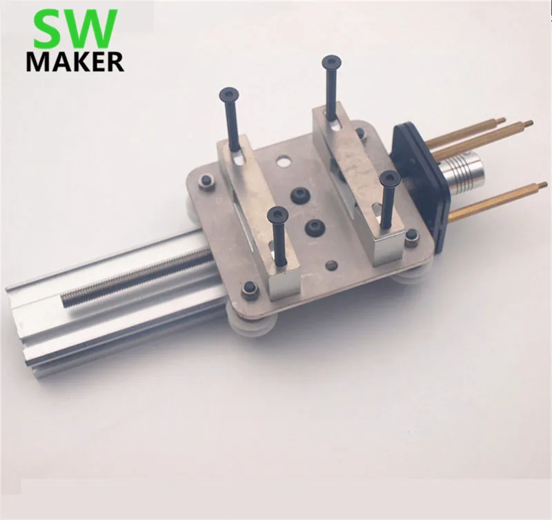

I too have the standard belt driven Z for my Shapeoko. I came across this interesting Z axis router kit and I’m wondering if anyone has replace their belt drive with this. The price makes it interesting.
It looks rather sketchy to me, a very generic part for cheap import machines throwing around the Shapeoko name to get credibility by association. Dropping down a motor frame size (you also need to buy a NEMA 17 motor) and switching to a lead screw of unknown pitch with no information about the nut (style or material) may leave you in an unhappy place. You will end up with a Z axis that is slower and that may not have enough torque to handle any spindle upgrades. I would save up for the Z Plus or HDZ.
Indeed,
I looked at the part and Ewwww, I don’t think that’s really an upgrade to even the old belt driven Z, the C3D Z plus would definitely be substantially better.
The V wheels on that part are the softer versions, closer together so there’ll be more deflection and play, as Lester says, teeny stepper. I don’t think you’d be very happy with the result.
I am sure someone on the forum here has an Z+ gathering dust from upgrading to a HDZ.
Thanks for your honest opinion. I agree with you and will probably spend my hard earned money on a proven part rather than an unknown knock off.
