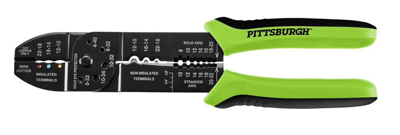

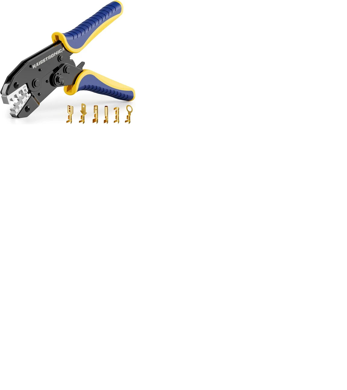

I have these crimping pliers that you change out the jaws for different kinds of connectors. They are fantastic and work well but are expensive.
For years I used these cheap type and can work but it is a crap shoot if you get a good connection.

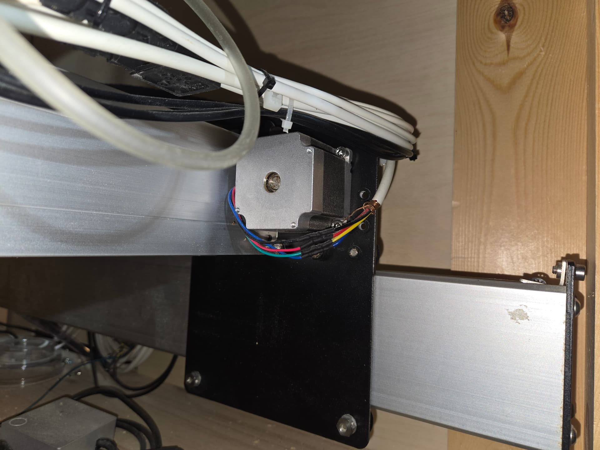

Maybe mine are odd, but I replaced the cables and removed and soldered my connections back in late 2019 or early 2020.
I have not had a wiring issue since then, but it has only been 5 or 6 years ago.
Thank you for the good quality guidance Gdon_2003. I have the crimper you label as good. I’ve used it to crimp wire on to connectors from SparkFun that look a lot like the connectors on my SO4. My experience is that they fail to hold very well with motion and have a single digit to low double digit number of connect/disconnect cycles before they are too loose to have enough friction to hold the connection together.

Between laser and milling and general goofing around I cant even guess at hours used. Some months maybe only 20 - 30 hours. Some months maybe a hundred hours or so. Some months very little.

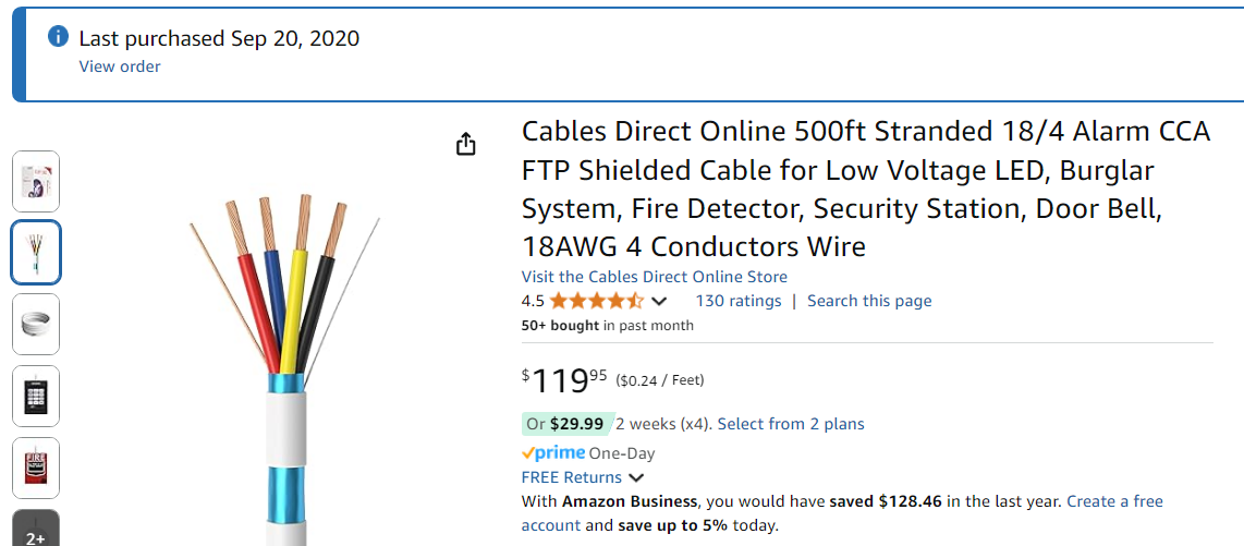

Well that clears up when I changed it, Sep 20 2020, or within a few days.
Also, I did use heat shrink tubing as well, cut to around 1 inch lengths.

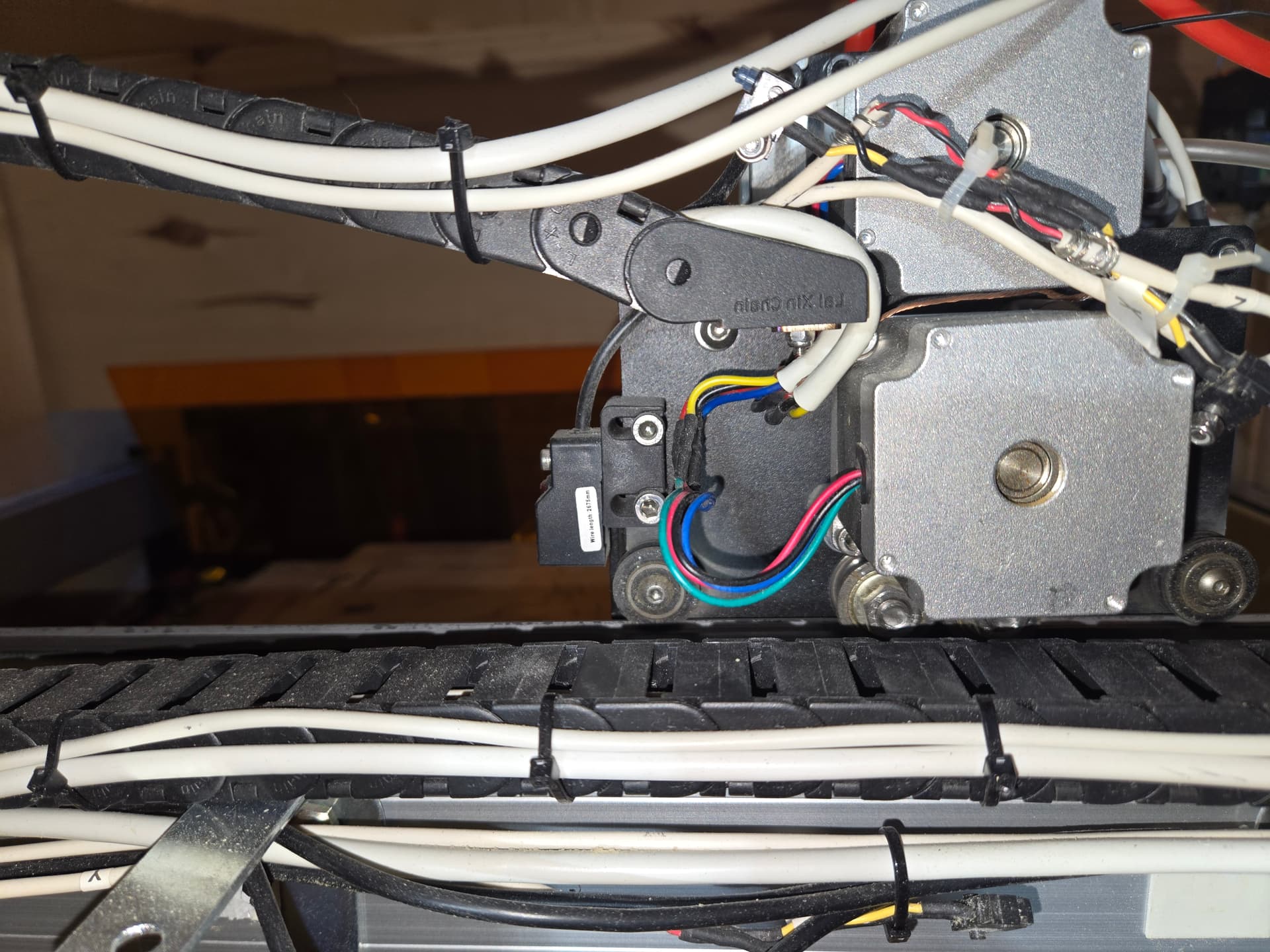

My first thought when I saw the beefy cable was how did it fit in the chain. I see you zip tied it and it worked just fine. Thank you for taking the time to give me guidance on rewiring.

The cables for the steppers and both sets of limit switches fit into the cable chain fine as long as you lay them in neatly. The two cables zip tied outside the cable chain are separate power and PWM for the laser.
