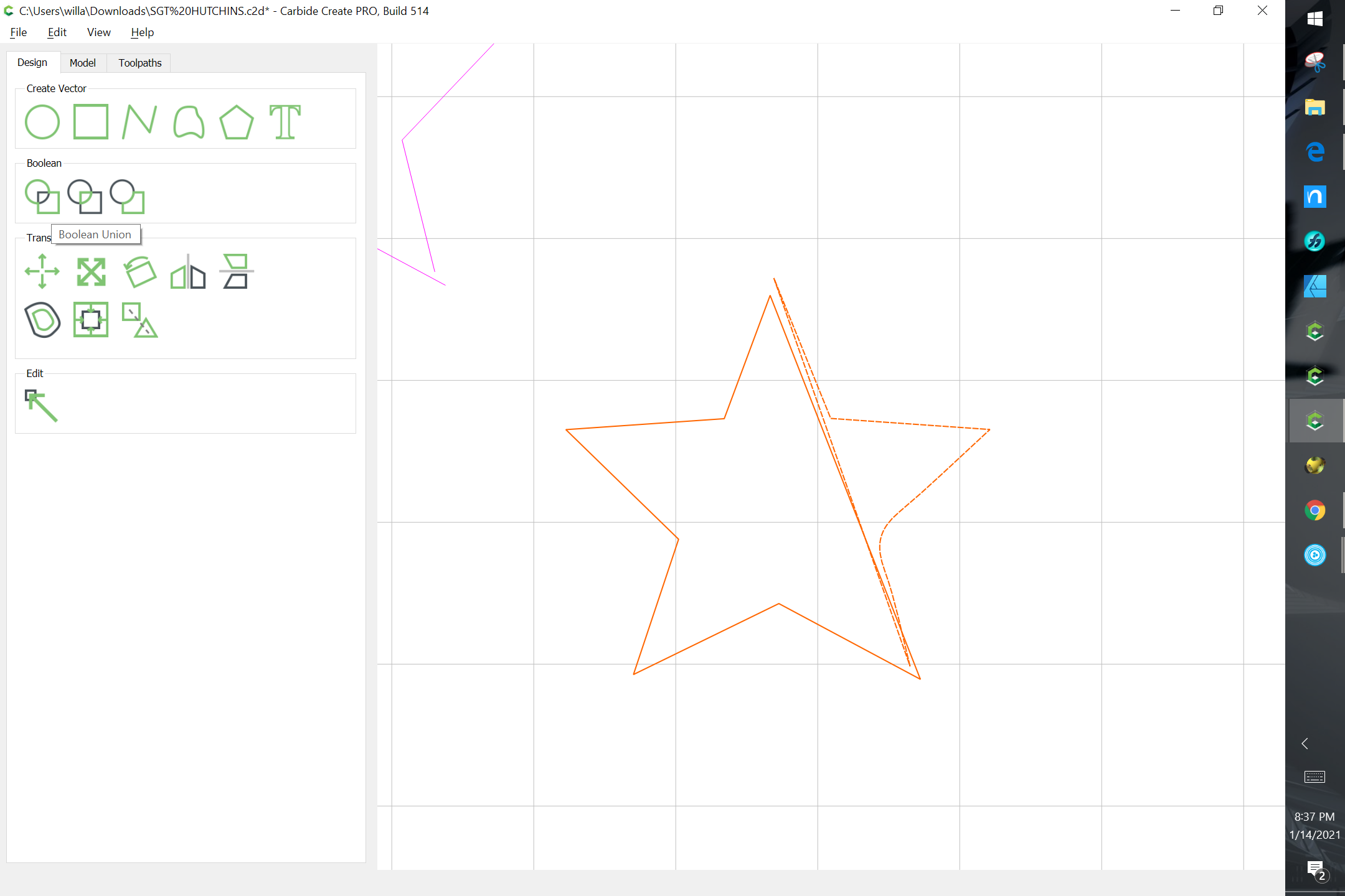

Magenta indicates the geometry is open:
Select each and click on the “Join” icon to close them:
Where they don’t connect:
close each:
and edit them so that they overlap:
Then select both and Boolean Union:
and then delete the nodes (or you could draw in geometry and Boolean union):
You’ll need to ungroup anything which is grouped:
Again, if things are multiple parts close each:
and union them:
Repeat for all the other stars, or dupe the fixed one and place I where all the others are.

Where need be, subtract one from the other:
until one arrives at:
Attached.
