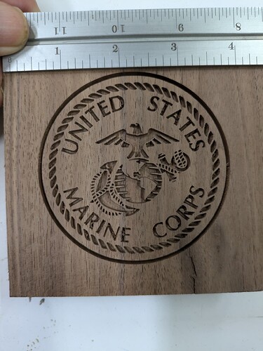

My question is on the outside right and left side I am going to vcarve the Marine Corp Logo and the work MARINES on both sides.
So should I paint the carving or fill it with epoxy?
Here is a close up of the Marine Corp emblem carved in Walnut as a test. I wanted to make sure that the logo was a good carve before carving it on the actual sides. It was an advanced vcarve with a 1/32" bit and a 20 degree vee bit.
Here is the simulation from the CC application.
The side is 4.5" wide and 38" long. The carving is .1" deep
So paint or epoxy?

In the mean time I mixed up some MAS Table Top Pro epoxy. 2 Fluid ounces and put 4 drops of Transtint Red dye in. The color looks good but once I sand off the overfill sometimes red looks black or dark. Tomorrow that will be dry and I will sand off the excess and see how it looks.
Still waiting to see what suggestions I get on paint vs epoxy. I just could not do a half and half on the trial Marine Corp Logo. So I just filled the whole thing and will see tomorrow,
I gotta say that logo looks really good as is, without paint or epoxy.
I wonder how just clear epoxy would look?
I’ve never seen an EGA colored all red. Interested to see how it turns out.
I might consider gold or black.?? I do like how clean & professional epoxy looks over paint.
I did a Chris Craft boat logo with red epoxy on mahogany and the red came out dark.
I wonder if mixing a little white tint, or painting the letters white before pouring the red would make the red brighter??

I will still carve the MARINES down the other side. Still deciding to paint that carve or epoxy. Last night while carving the first side I took my test and added MAS Table Top Pro Epoxy. I mixed up 2 fluid ozs and added 4 drops of Transtint dye.
Here is the raw epoxy after sanding off the over fill.
Here is the epoxy fill with mineral spirits on it.
So 4 drops per 2 oz is too much. I will try 2 drops per 2 oz. The CC Pro volume estimation for the MARINES only is confusing. Here is a screen shot. I took the extra % down to 0 just see the estimation.
Last night I mixed up 2 oz of epoxy for just the EGA and had some left over but this says I need about .9 oz. Do you think they mean .9oz for each letter?
The text is Arial Black 3" tall and .1" deep.

Made more progress. Got both sides of the “Marines” carved and a single coat of red paint. I put Zinsser Universal Sanding Sealer (Dewaxed Shellac) on before painting. Still have not decided on epoxy or just the paint. Also got my Marine Corp Logos from Amazon. They have an adhesive back so after finishing I will attach the metal logos. I will put another coat of acrylic red paint on tonight before I go to bed and see what it looks like in the morning.
Here is the metal medallion.
Sanded off t he excess paint today. I think I will just leave them as is and finish them with wipe on poly along with the rest of the cabinet. More and more progress.
