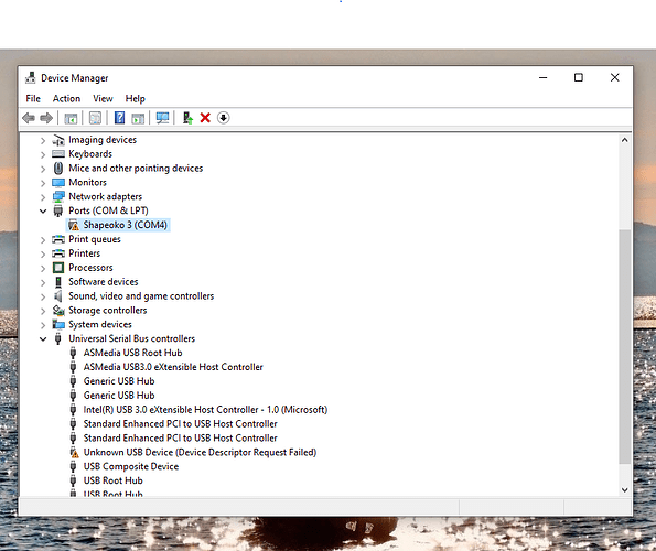

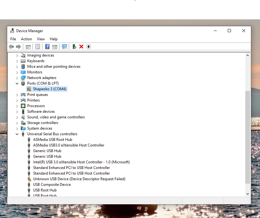

OK, so I have read through a number of the other “USB Device not Recognized” threads, but don’t seem to see anything similar to the situation I am facing. I have a Lenovo ThinkPad X1 Carbon running windows 11, which runs my Shapeoko 3XXL just fine with no USB issues at all. I also have a desktop PC in the shop which is running Windows 10, and I would really like to use that machine to run the CNC to keep the Laptop out of he dusty shop.
When i connect the USB to the desktop it returns the notification “USB device not Recognized” The Device Management page showed it in the USB seciton with an exclamation point. I selected it and chose the action menu to “add Legacy hardware” and chose Ports (COM & LPT), then selected “Carbide 3D LLC (carbide3d.com)” Are there any computer wizards in here who can help me get this computer playing nice with my Shapeoko?

What happens if you right-click on the USB port which has the exclamation/warning icon?
Does it report that the driver is loaded okay?
Try creating a new LOCAL admin user account and see if the driver loads in that?
If things still don’t work, check with the computer manufacturer.
right clicking shows the normal menu for a device. When i select the “update driver” it says “the best driver for your device is already installed”
I reinstalled drivers and also updated the Bios for the machine… no change with either.
Created local Admin account and attemped same. no changes.
Not quite sure what the issue is. all other USB devices keyboard, mouse, thumb drives, seem to work normally. for some reason its just the Shapeoko it doesn’t like.
