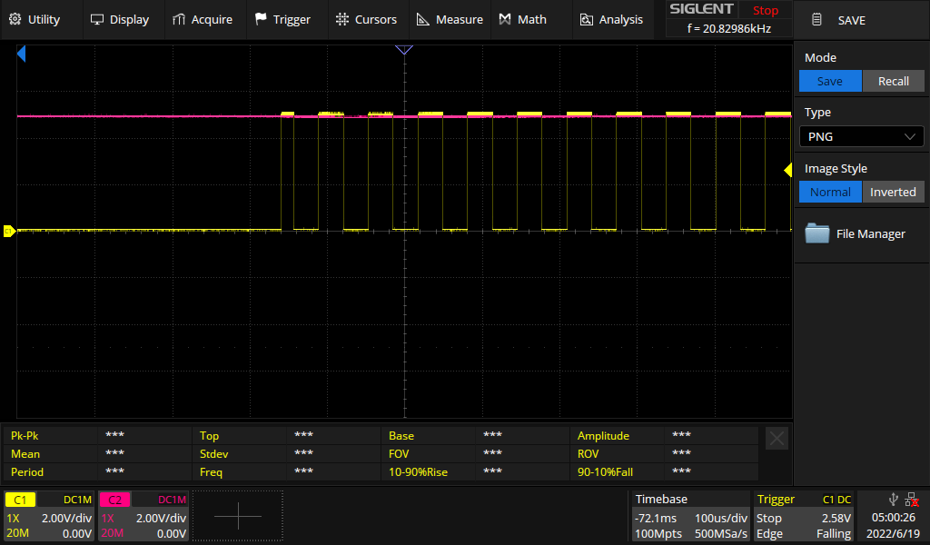

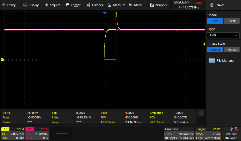

While connected to my MacBook and repeatedly triggering the bug with the motors disconnected, I scoped some signals on the Motion board. Purple is always DTR.
Yellow is TXO
Same as above, zoomed in
Yellow is RESET (from GRBL chip)

When not bugging, normally TXO and RXI are silent. RESET behaves the same in both cases. The fact that it spikes up above 5V is a bit disconcerting, though.
Again, in none of these experiments do I send any serial data over the USB connection. Just open the serial port and immediately close it. The Shapeoko is power cycled between each test.

In all cases tested I scoped both DTR and RESET (from GRBL’s chip). In all cases RESET behaves as depicted in my previous posted scope images. DTR going low causes RESET to immediately drop low to 0V, and then decay back to 5V. DTR going back to 5V causes RESET to spike up to 10V and then decay back to 5V. Decay time is 5ms.
There’s usually an RC circuit on RESET lines, so the decay is normal. 5ms matches the Uno schematic RC filter.
I also scoped by Uno, which is loaded with copies of the firmwares from the Motion board. I’ve never been able to trigger the bug on my Uno. And even varying DTR I’m still not able to. And while it shows a spike on RESET when DTR rises, it’s only up to 6V. That matches a quick simulation on falstad, so I guess that’s normal.
I’m a bit concerned that the Motion board’s RESET is spiking to 10V, though. The 328P can tolerate up to 13V on that pin, but still. Makes me wonder if that’s what is making it glitch out?
