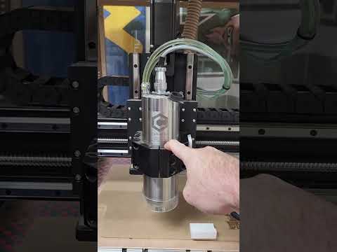

After seeing your video, I had to try again. I got it to budge by putting my full body weight into it, which is why I didn’t think it would budge. But that amount of force is akin to the force it would take to knock the machine of the table (I only have the small machine). If a failure could exert that kind of force, I think I’d have other things to worry about.
But I see your point.
You’d be surprised how much force a cutting tool rotating at many thousands of rpm will exert. Especially if it “bites” in a cut.
My professional and personal advice are in agreement here. It’s not a good idea, please don’t endanger yourself by trying. I’d be glad to share my trim router mount template that I posted above if it will help you not do this.
There is no “good” idea for using a CNC as a router table. Yes it “can” work but “can” and “do” are far apart here. This idea is just dangerous. I “can” drive with my eyes closed but it is not a very “good” idea. Anyone “can” do as they will but practically everyone in this thread has commented that using a CNC as a router table is a bad idea.
Let me repeat. Using a CNC for a router table is a BAD idea and should not be attempted.
I have to play devil’s advocate here. With the exception of the power outage issue and unlocking of the stepper motors, which I do view as a significant safety issue (I have tripped the breaker’s on my garage many times), all other safety issues brought up apply equally to table mounted routers.
If you look at the comments of that video it is quite the opposite of that here. But we can agree there are definitely safety issues they clearly are not addressing.
I’m sure all new machines are dangerous until safety considerations are addressed and safety mechanisms. If we discarded all ideas because initially they aren’t safe, our only mode of transportation would be walking and we wouldn’t have modern medicine.
So let me turn this into a hypothetical engineering question. What would it take to using a CNC as a router table safe (or at least as safe as a traditional router table)? (I do emphasize hypothetical)

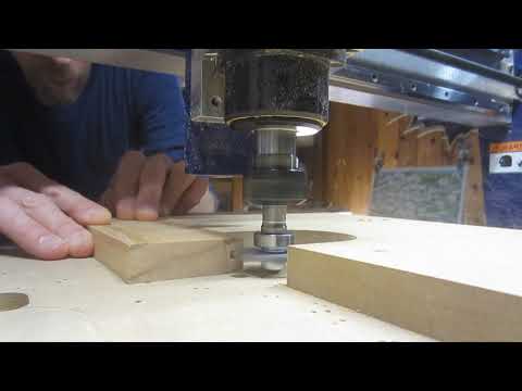

I’ll step in and say that I have done this (I didn’t want to admit it after seeing the responses). It was a one time, convenience thing. Everything went fine. It felt weird, and I can’t say that I can think of a reason why I would do it again if I have an option.

Now that you posted that. There is a reason overtable routing doesn’t look so foreign to me. I’ve done it before years ago. Before I had a trim router or router table (or CNC for that matter) I used to cut rabbets for shelving using my Shopsmith 510 in an overtable router configuration which is in fact advocated by Shopsmith, see Getting Started With The Router. Personally, I trust the robustness of the Shapeoko over my Shopsmith. That still doesn’t mean using a CNC over table is safe but it does mean there is nothing inherently more dangers about an over table router.
