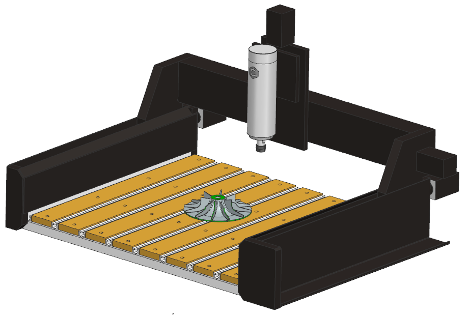

I work for Siemens on NX CAM. Primary jobs are programming postprocessors & creating machine simulations. So pretty much all segments of industry.
Otherwise, I couldn’t afford NX :smiley:
And yes, I have a complete post & sim for my HDM
