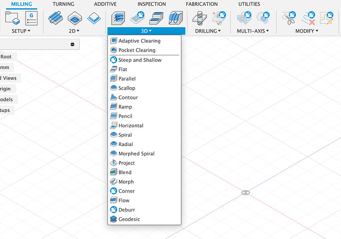

There’s honestly not much in it between the free & paid versions for these types of machines, there’s a comparison table here
But it’s more than a little misleading, many of the capabilities it lists, and most of the ones you’d actually want, come in one of the additional subscription packs such as the advanced machining, and those will quickly set you back Shapeoko money annually for the sub. As an example, last I looked it was going to be about £1,500 a year to get to 4 axis machining CAM to support a 4th axis on my machine.
I subscribed to the paid version because I was using it for work and fair is fair, if I’m earning money from their software I should pay for it.
Things I think I get that free licenses don’t are
  • Exporting PDFs or DXF drawings from Fusion to send out
  • Rapids within toolpaths (as Ben mentioned) but Neil Ferreri has a post-processor fix for this anyway if you need it
  • Ability to share 3D models with people online, which can be handy when they are not a Fusion user
  • I think there may be a couple of extra toolpath types enabled in the subscription version, but I’m not sure, I’ll add a screenshot of the options
HTH
See the screenshot, all the features with the plug symbol are disabled unless you rent the manufacturing extension on top of your existing Fusion subscription.
