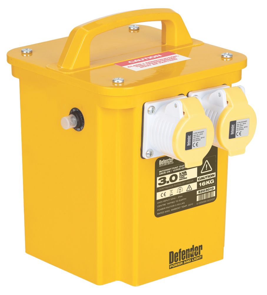

It appears I have bought a 110 volt trim router, any sugestions for using it on uk 240 volts
You could use a step-down transformer, but it would be much simpler to just source a Makita RT0700 which runs on 220V.
As Will says, probably easier to just buy a Makita but if you prefer to go the transformer route, there’s lots of "site transformer"s available such as this one as they’re commonly used in construction.

Thanks for the advice, I have ordered [200W Step Down Power Voltage Converter Transformer 220V/240V to 110V/120V, Intelligent Efficient Adapter Travel Power Adapter ] from Amazon.

I will note again, that I am running a 220V unit (Mafell FM 1000 WS) using a step-down transformer and it was able to draw sufficient current though the circuit which had been wired up so as to use the removable tab on an outlet to continue the circuit to completely burn out the outlet.
Since then, I’ve put it on a dedicated 20 amp circuit.

Just checking, you meant 2,000W not 200W ?
