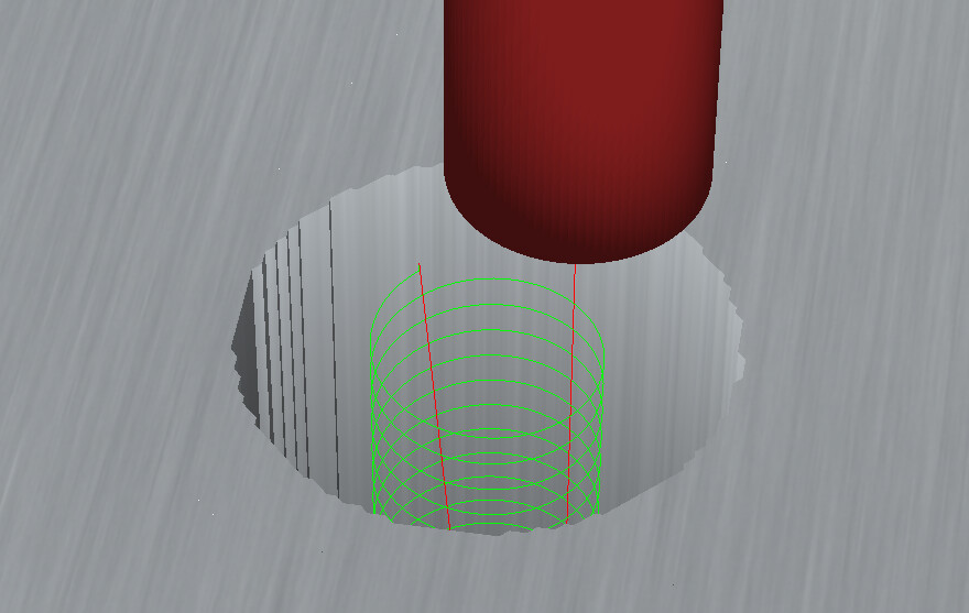

I prefer to “Hole Mill” if I can. Use a tool that is 50% - 75% the size of the hole & spiral (helical) feed to depth & make a planar finish pass.
In CC, use a contour path, inside offset, set the depth of cut greater than the max depth, set the plunge speed the same as the cut speed. Use ramping & adjust the angle to get the depth of cut you want with each revolution.

I just circle milled a bunch of through holes in Aluminum using the CC 1/8 " 274z bit. It worked well. Most of the holes were prepping for tapping and a few for clearance or bearing diameter.
I used the CC recommended recipe. The ramp angle was 2 degs @10ipm.

I was wondering if using a Mill drill to clear a through hole center, then circle mill the rest with a regular 1/8 end mill at full depth would be better.
Comments ?
Yes, if you have a mill-drill that works well. The other option would be to hole-mill a smaller hole, then the larger one.
