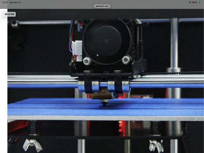

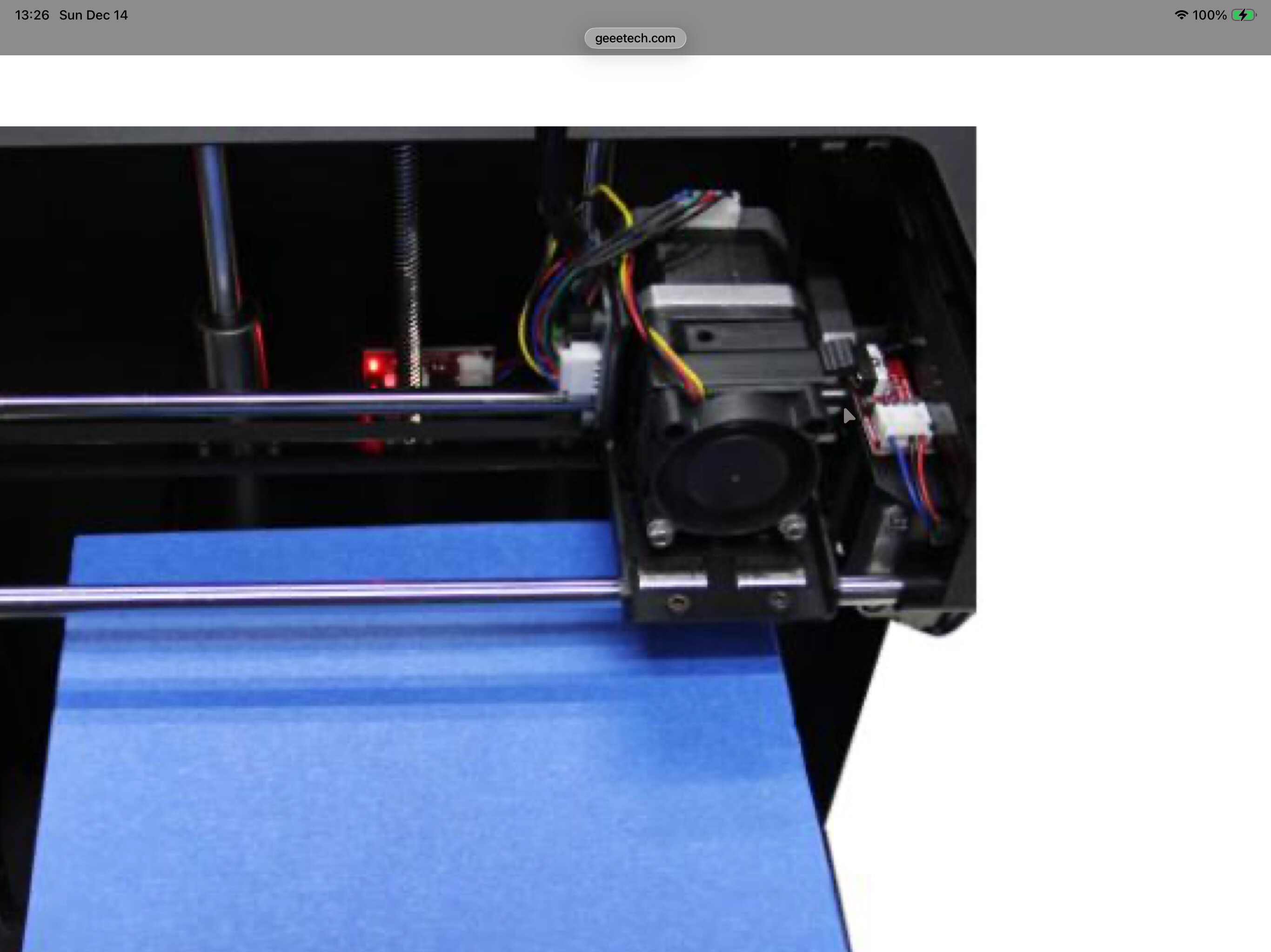

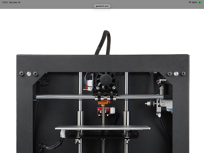

I have noticed something a bit odd with my printer though. There is this mounted box around the outside of the extruder. It looks like a printed piece unlike the other housing around the casing and circuit board up on the extruder head. The one side of this box comes super close to the printing surface as well and even grabs or drags some of the filament off the table. I looked even closer and realize there are four ports facing down towards the extruder that look like cooling vents. I am pretty sure this is not supposed to be a part of this machine from the factory.
When I was looking from beneath the machine up to the extruder head, I could see one of the cooling ports look like a printed port from maybe this machine. I can move strands of plastic like it has plastic hairs up around the opening. Plus, the box where it mounts is slightly bent to one side making the box come closer to the table on that side. Not having an actual picture of the machine on the closeup of the extruder head, I am not sure if it is even supposed to be a part of the machine head. There are screw holes with screws there, but the unit doesn’t fit into the side hole properly and it is crooked.
When I opened the manual @Jeffish linked here I took a screen shot. The fan is to cool the filament off when it comes out of the hot end (print head). It does not show an enclosure as you mention. There plenty of hacks on the net for a bunch of these machines and it could be causing a problem?

I saw the same pic you did. I removed this box around the extruder and it is clearly a 3D printed piece as an add-on, but it was completely poorly made. The Z height is off as well. I am working on checking table level and adjusting accordingly. I found the screws holding the Z homing switch were also loose. So, now I am going through checking all of the screws for tightness. The Z homing switch is up as high as it can go as well and now tight, and I will go check the clearance between the Z and table to see if it is at the right height now.
