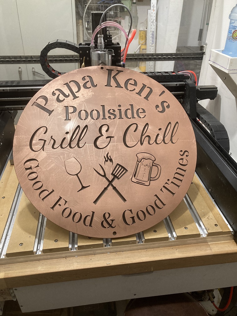

I rigged up my enclosure with a hole in the top that fits my dehydrator head. I can crank it up to 150° in there. I let it run overnight, let it cool off, then apply the Oramask.
Here’s one I applied the oramask too soon. Fortunately the customer liked the distressed look!

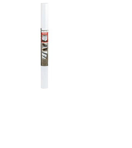

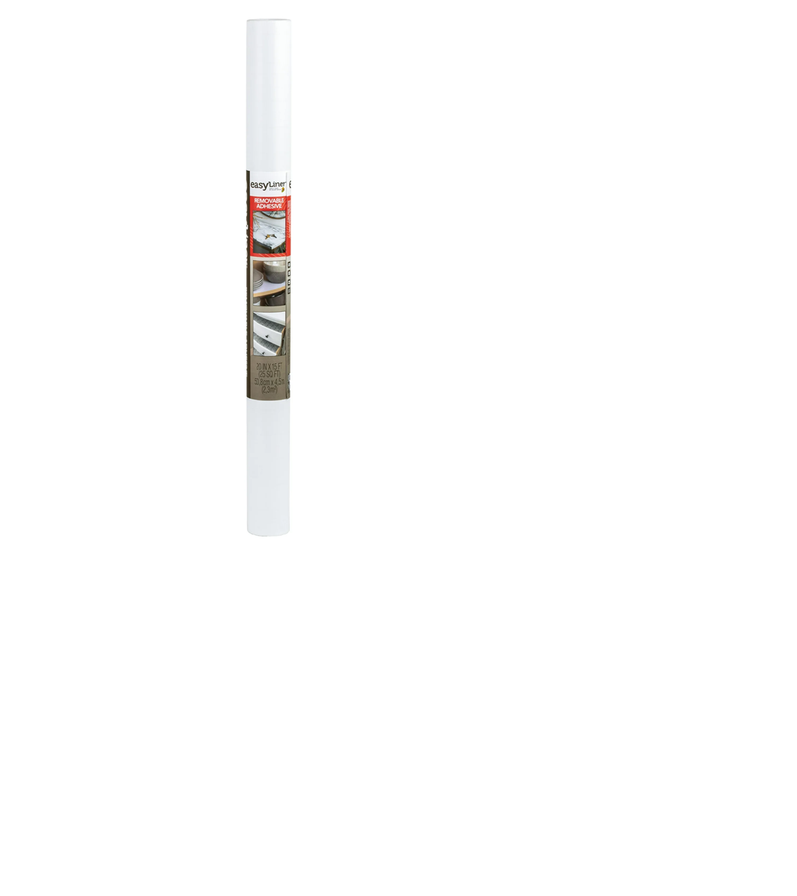

A lot of folks use various Oramask products. I have some but I seldom use it. Instead I use Easy Liner Adhesive Shelf Paper I get at Walmart and/or Lowes. It sticks well but does not seem to over stick. You could try some and it is relatively cheap compared to Oramask. Plus you can buy it locally if you need some.
