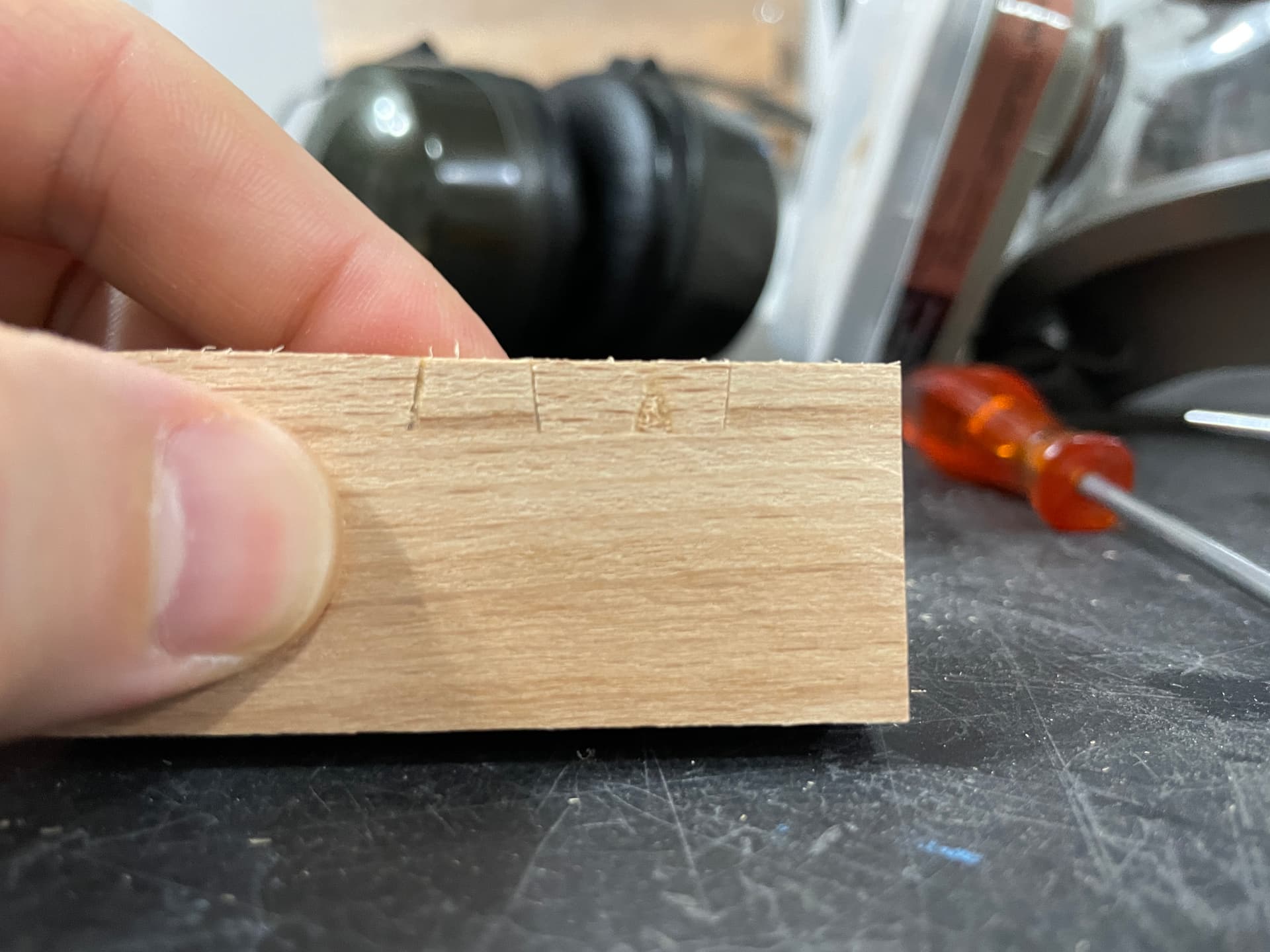

Hi Thomas, thank you for this video! It was very helpful for me. I have some problems and I’m not sure what I should be adjusting to fix it. As you can see in the pictures, there are still some small gaps between the inlay and the pocket. I also noticed when I cut it in half that there is no gap at the bottom, so, it couldn’t be pushed further down. What setting do I adjust to create a pocket for the glue at the bottom?
For the pocket I used:
Starting Depth (S) - 0
Max Depth (D) - 6mm
For the inlay I used:
Plug Depth (D) - 1.250mm
Top Gap (S) - 5.750mm
Appreciate your video and your help!
Hi Paul,
A couple of things. Can you tell me what bit you used for your inlay? I noticed you used the settings that I came up with for my bit in the video. Those settings work for me, using that particular bit (from the video) in end-grain. Also, are you cutting full depth on the face grain?
From your pictures, it looks like the plug is still bottoming out, and there also appears to be some chip-out.
For the chip out, it is recommended to run the TBN toolpath first, and then the clear out toolpath. That should reduce the possibility of chip-out. Face grain is a little more susceptible to chip out.
To rectify the plug bottoming out, Increase Top Gap and decrease Plug Depth. It should still be a total number of combined 7mm. So for example, change the plug depth to 0.75mm, and increase the top gap to 6.25 (.75 + 6.25 = 6 + 1)
The formula I used for determining the settings is:
Too loose: Increase Top Gap, Decrease Plug Depth = Pocket Depth + 1mm
Too Tight: Decrease Top Gap, Increase Plug Depth = Pocket Depth + 1 mm
The most important thing, is you cannot necessarily use the exact same settings, even if you have the same machine as I and use the same bit. The bits can have variances and tolerances, even within the same manufacturer.
I will play around with it some on face grain and see if I can come up with better setting specifically for face grain (I hate face grain inlays, LOL). Let me know what you come up with, and I will also try a couple of inlays on face grain and post results.
