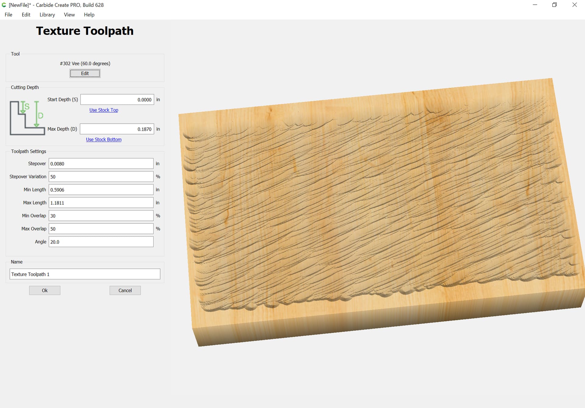

So I’m working my way through Carbide create trying to learn all the different features it has and I’m now messing around with texture. There are several settings like angle, step over and depth. There all somewhat self-explanatory. I’m think the best way to see how the different setting change the texture is to just play around with the settings and run a bunch of test pieces to see the outcome. Did not see any tutorials on texturing but did not look that hard. One question I had was can you use any end mill or is the ball end the standard for this operation?
Thanks,
Jack
You can use any endmill, including V endmills:
