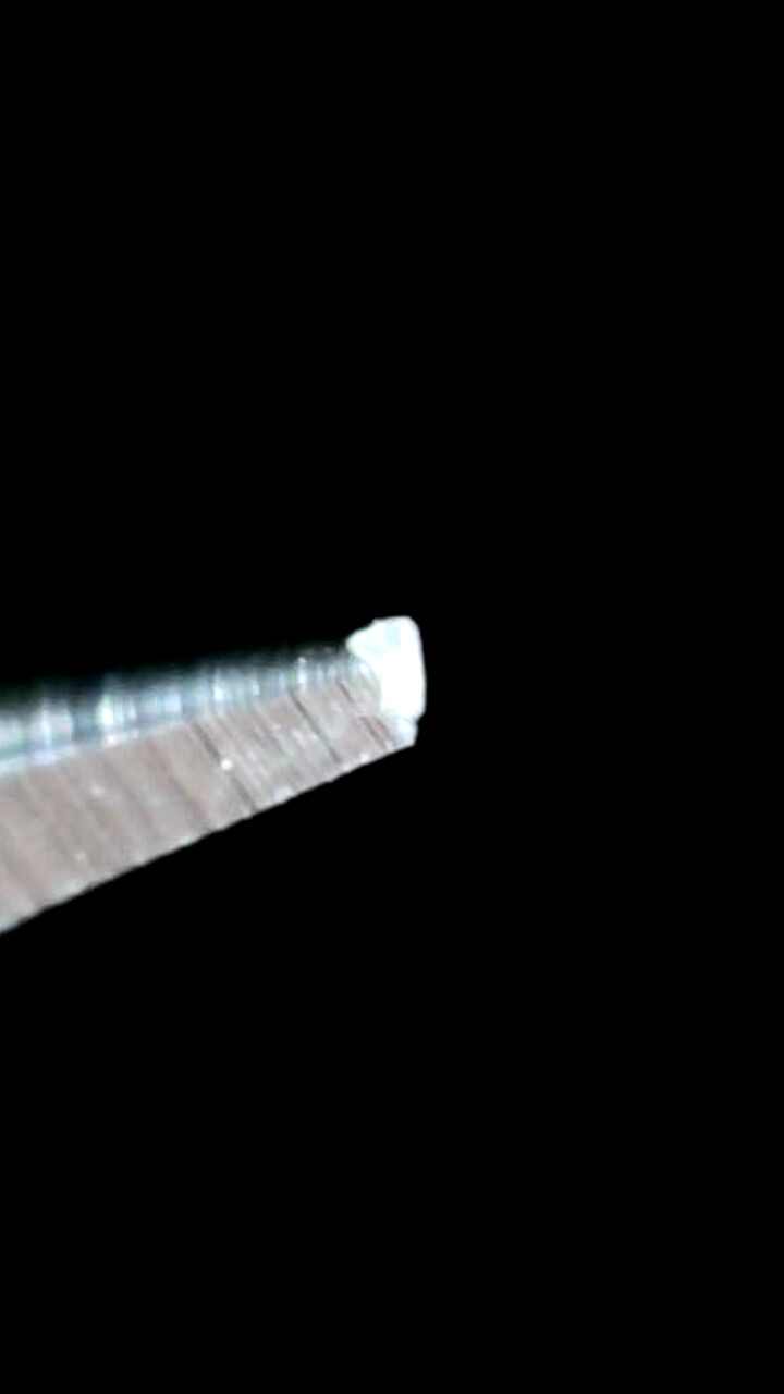

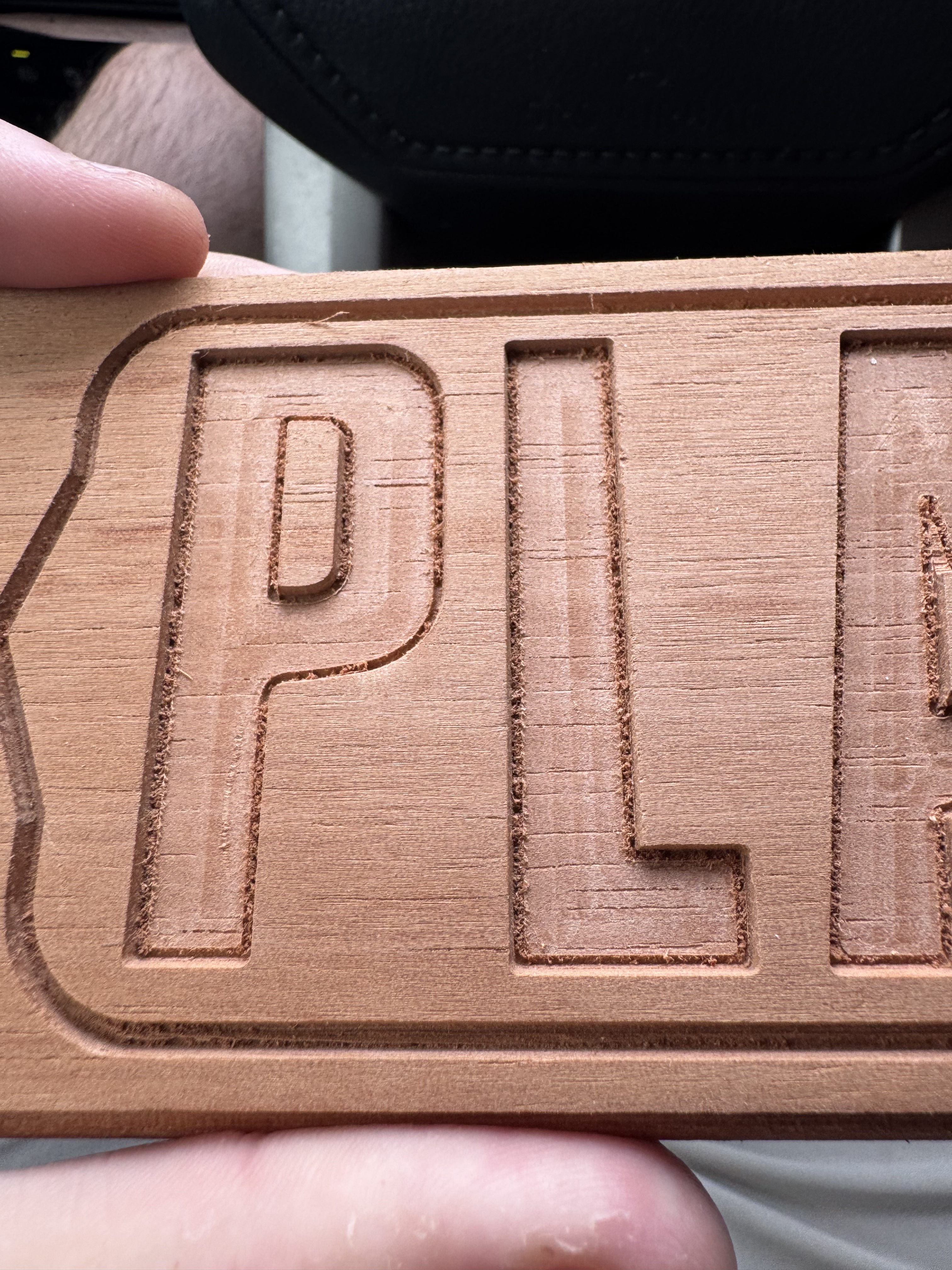

Hello everyone, this is my first post. I am stumped. For reference I have a shapeoko 5 pro. I am running an advanced Vcarve path with a 30 degree bit I purchased. I pocket out some letters with a 1/16” end mill, then come back with the v-bit to give it better detail. However, something weird keeps happening, the v-bit will go slightly deeper than the pocket area, even when using the bit setter. I do change collets from a 1/8” collet to a 1/4” collet when moving from end mill to v-bit. I do these types of processes all the time, never seem to have an issue except with the v bits. I have run into this with a 30 degree and 15 degree bit. I have attached pictures, I hope someone else has some thoughts. You can see at the edge of the pocket, the v-bit is deeper. I have checked, this bit is brand new and not rounded or broken.
Take a good look at your vee bit. Does it have a sharp point or is the point rounded over. If it has a sharp point that is what you want. If it has a rounded over nose then it will not cut correctly because the BitSetter thinks it has a sharp point but the round point is misinterpreted and so the bit cuts deeper than intended.
Some vee bits are rounded over from the factory and some have their tip broken off by dropping it or the edge is so fragile it gets broken off when cutting. Look at the bit very closely with a magnifying glass to verify if you have a rounded point or a sharp point.
I have a sharp point on the tip. On both tips actually where I have seen this problem actually.

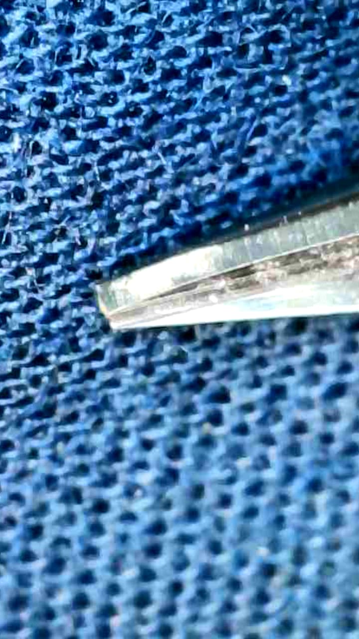

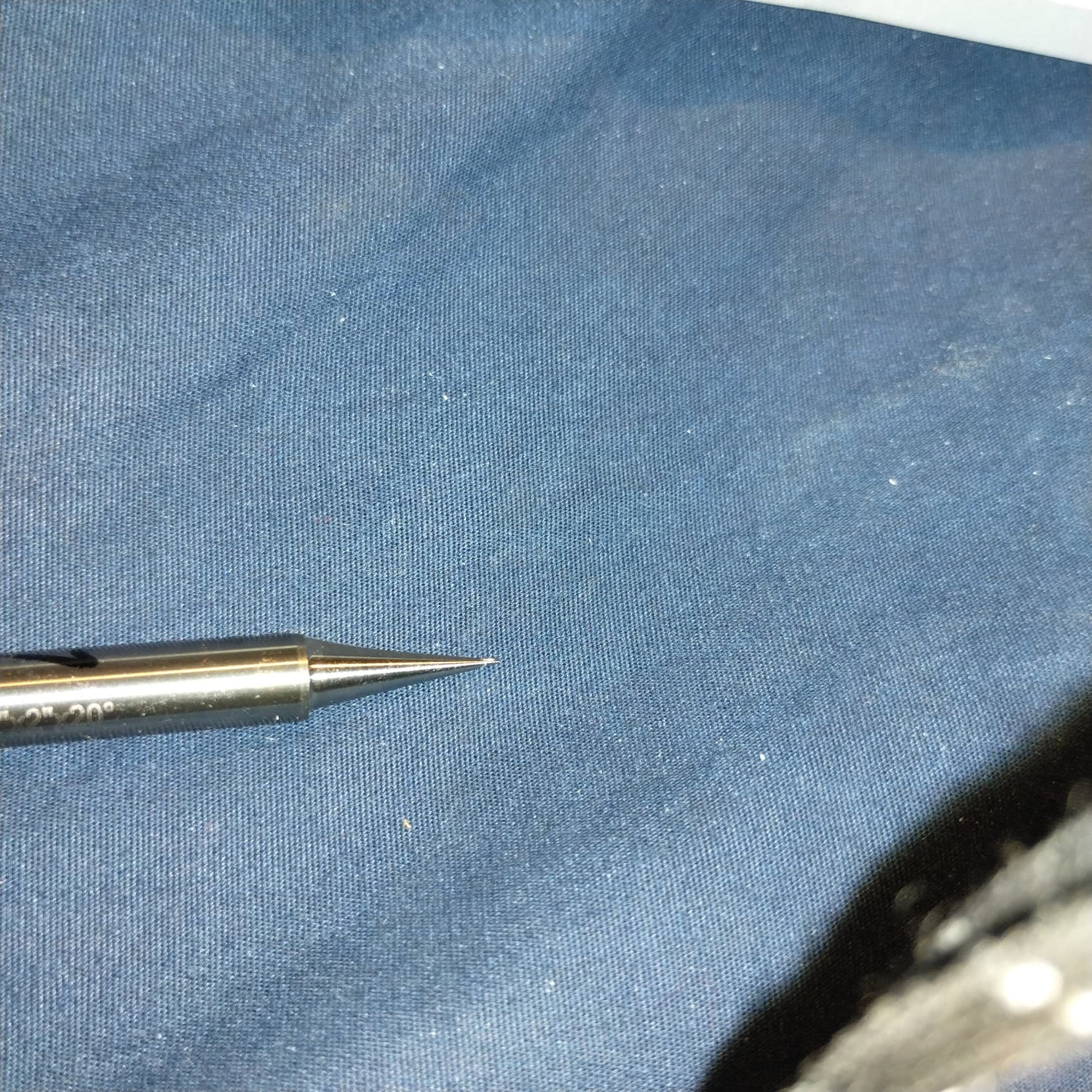

Joseph: look at the specifications, not at the tip. Had the same, a 0.1 tip looks sharp but is not. Needs really be a 0 tip one. And: even a 0 tip v carve wears off! I just have to send one to have it re-sharpened (Dinosaw in Hudson NY) after 8 inlay cutting boards hardwood endgrain, because it is not sharp any more. I use 0 tip ones:
looks pretty sharp with the phone, right?
not so much with the microscope:
GL with a new bit…

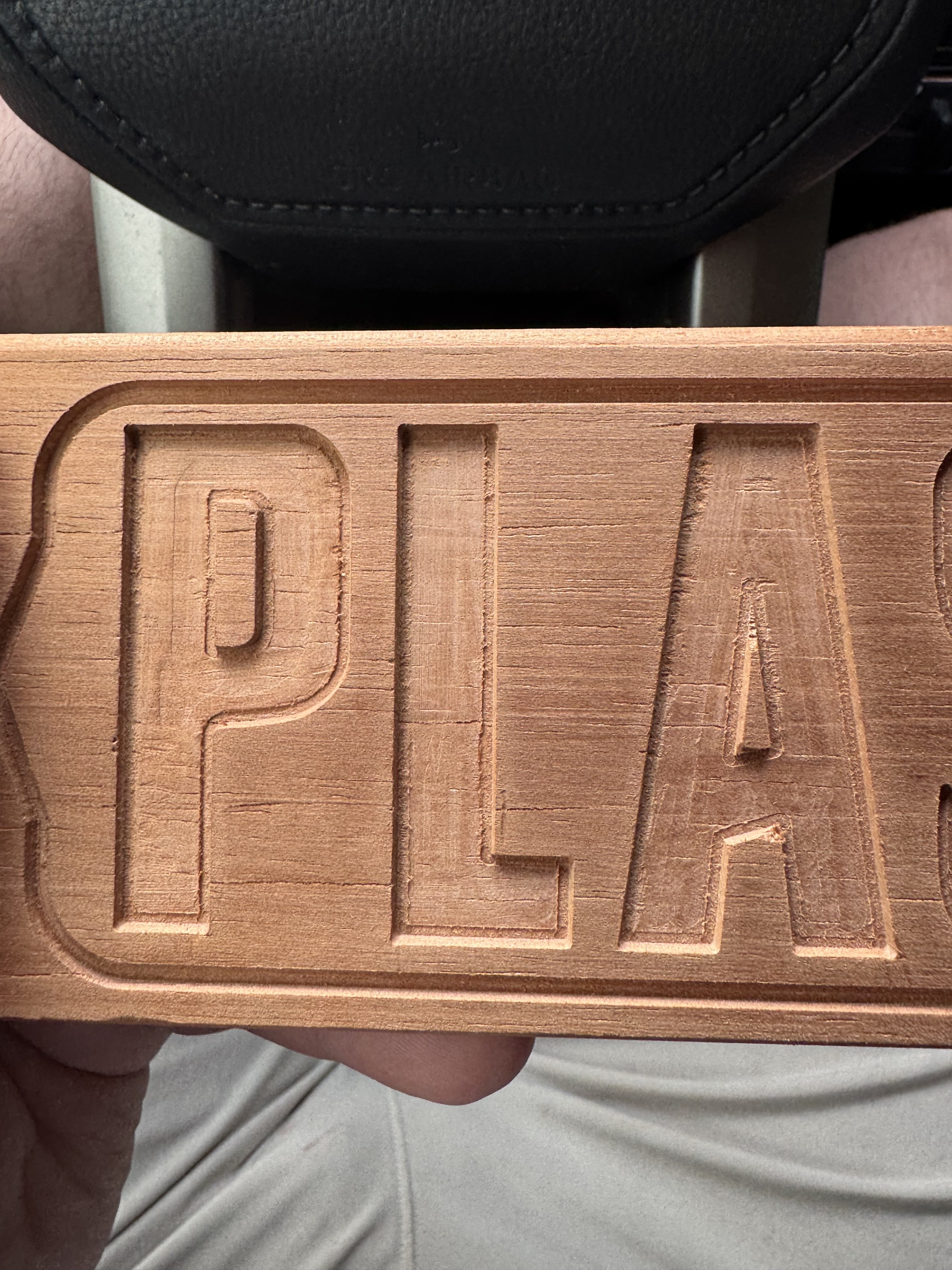

Thank you for chiming in, I appreciate all the help I can get. I see what you’re saying, this tip is actually is a diameter of 0.01 and I will see if I can get anything to zoom in a bit more. So I ran the program again, and I’m getting issues with a 1/32” end mill as well, when it finishes up the corners of the letters in the pocket, I will notice floors inside are a decent amount deeper. I know there’s going to be some tooling marks, but these are quite a bit deeper. Similar to the issues I get with the vee bits. Any thoughts?

Thank you also for chiming in. It’s the 80mm spindle from Carbide 3D. I will have to try this later in the week, for the mechanical stuff. I will say I notice it more on 1/8” shank bits. I did clean out the collet and made sure it’s tight. I will also note, it seems to get more and more off as the machine goes through the passes. As it starts the corners, it will be perfect, heck you can’t even really see tooling marks. As it gets more and more into the tool path, those marks become deeper and deeper for subsequent corners.
