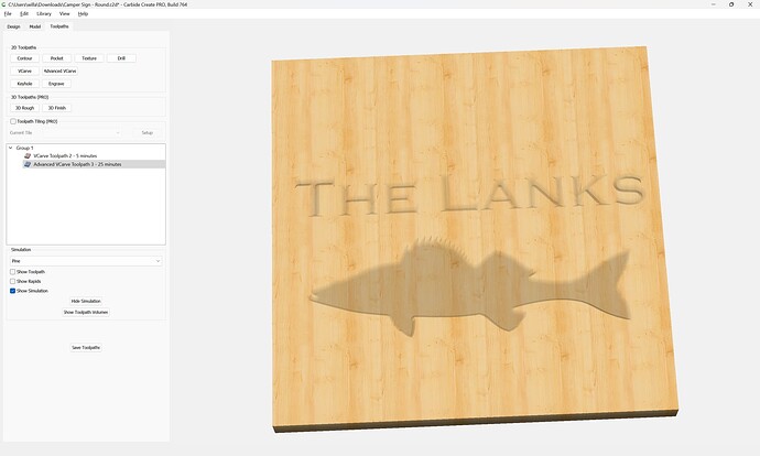

I am trying to create a sign with a fish V-Carved into it. I have tried both advanced v-carve and normal v-carve and I am just not getting what I expect from them. When I have used advanced in the past, I always got an outside line that matched up with the vector of what I am carving. However this time, it is not the case. The mouth and eye are hugely rounded and look like a weird cartoon and the thin part of the tail the V-bit is sinking all the way to the max depth causing a vertical carve straight down at the top, instead of only going partway to the max depth. Any ideas to what I am doing wrong? Also, it seems my simulation is extremely poor quality to what I see on others here, is that a benefit of upgrading carbide create pro?

For your advanced V-Carve, you are cutting 0.500 deep. Change that to 0.100 or even 0.050
You are cutting to a depth of 0.5":
with a #301 90 degree V tool which has a flute diameter of 0.5":
so can only cut:
0.25" deep.
If you reduce the Max Depth to w/in what the tool can cut, the appearance will be a bit better:
and will be further improved by using a more acute tool:
If the 0.5" depth is required you could use a larger tool such as the Amana RC-1148 from:
Thank you both for the quick response. Changed the max depth to 0.25 and it accomplished exactly what I wanted(combined with the prior run at max depth of 0.5!). I guess it was just my lack of understanding of the Advanced v-carve function…Now to try and figure out how to get the higher resolution simulation back. I am not seeing an option to change to high resolution on the job setup menu, only in the “View” menu at the top and it appears to do nothing.
