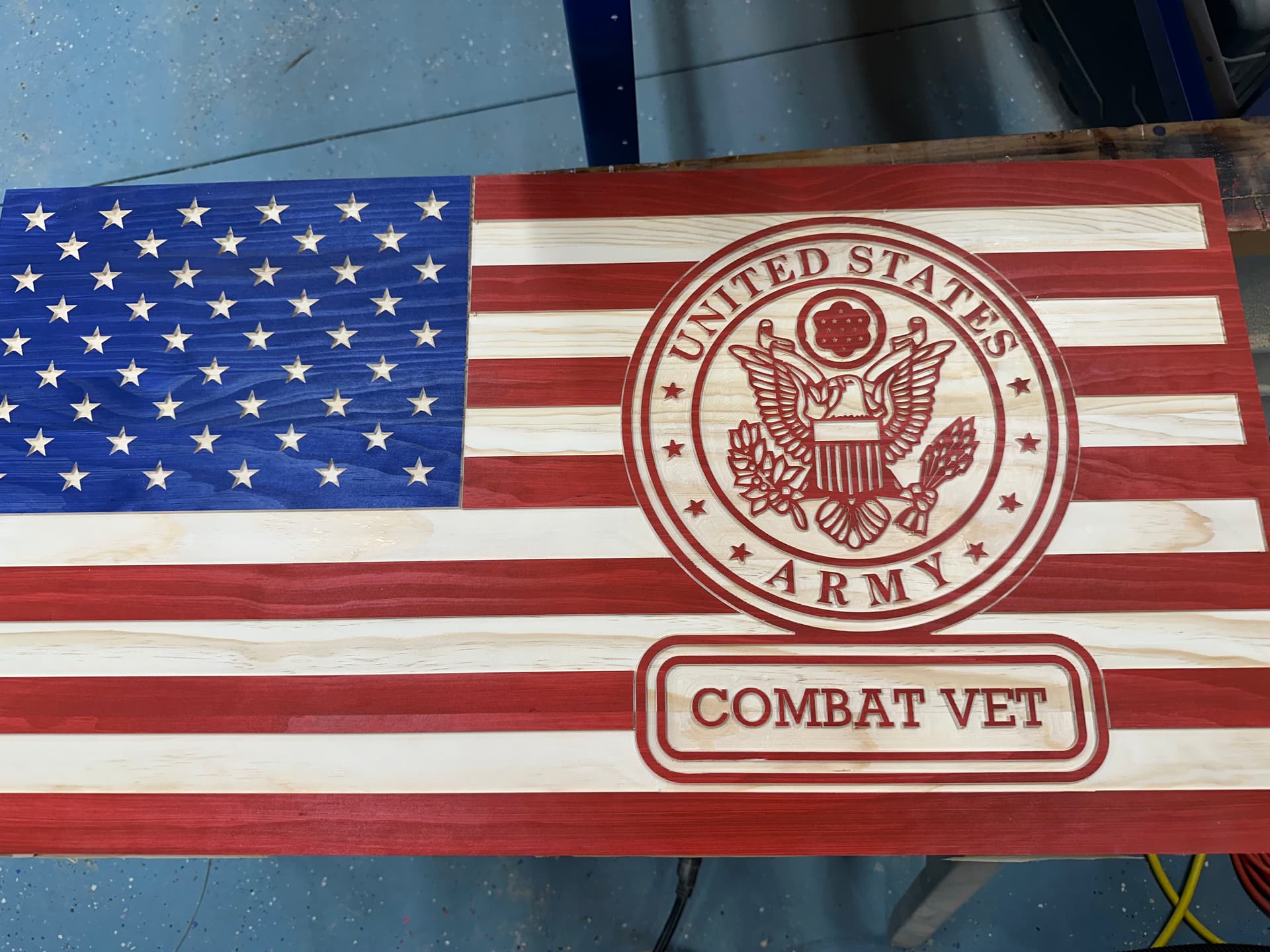

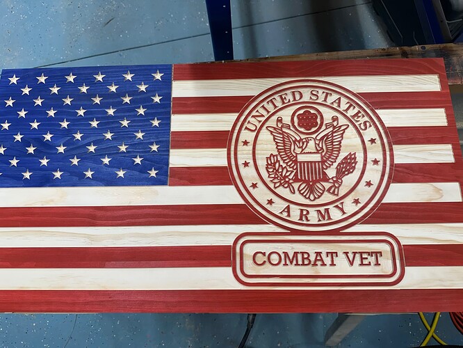

I’m trying to V-Carve the Army logo and I’m having issues with the stars and some of the lettering. I’m doing this in white pine. For the v-carve I used an 1/8" bit to pocket things out and a 30˚ bit (Amana 45771, Stepover 0.008, DPP 0.1, Feed Rate 40.0, RPM 18000) as the v-bit. Depth is set to 1/8".
What I would like is thoughts on how to prevent the chip-out you see around the stars and some of the letters. Would a different V bit work better? How about running the Vee code before the pocket code? Speeds? Any thoughts would be greatly appreciated.

So if I switch to something like maple, you think the tear out will go away?
It should be much reduced — that said, leaving a roughing clearance and taking a finishing pass is just good practice.

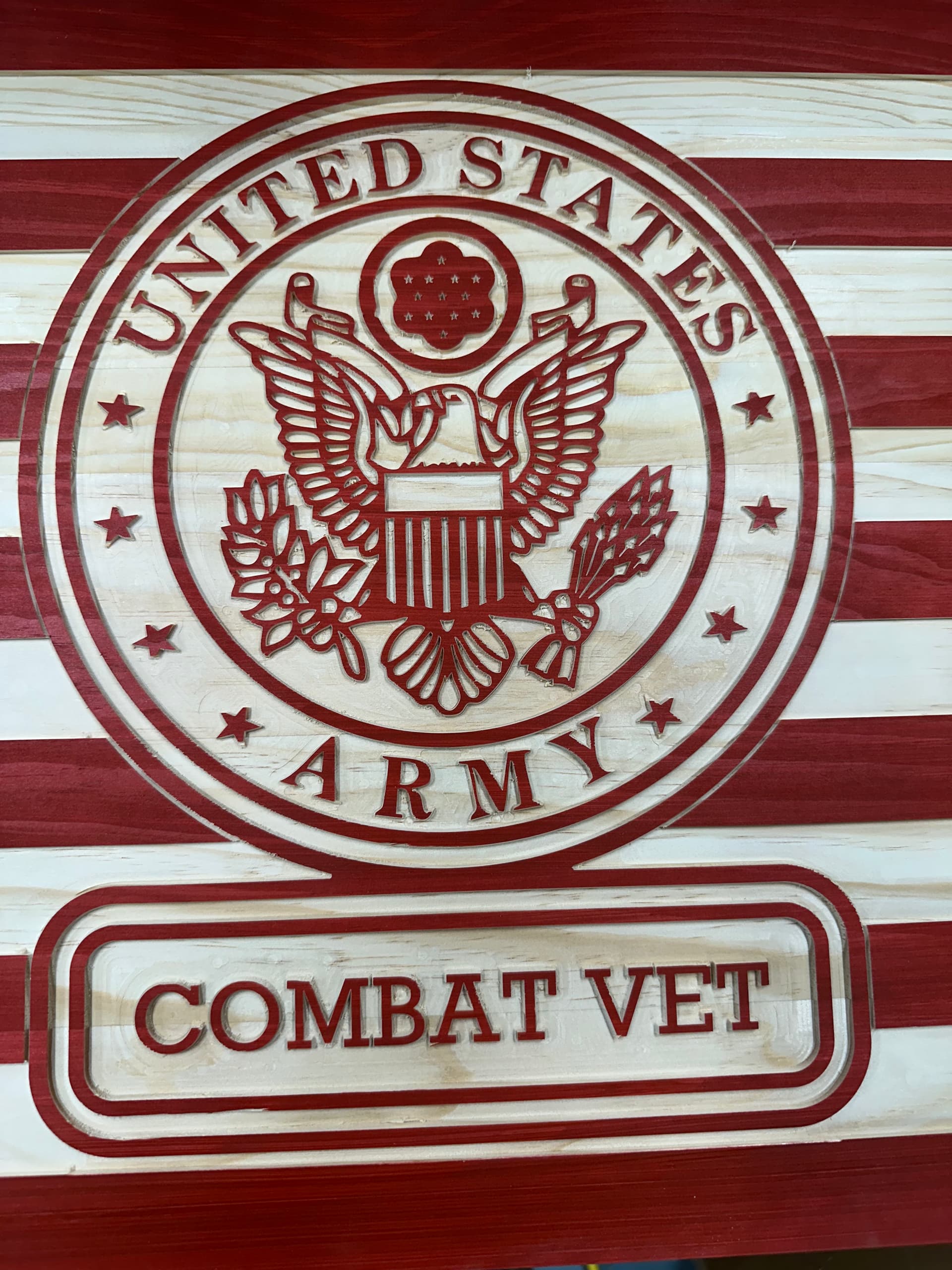

I do a lot of similar plaques using pine and feel your pain. I follow a lot of the advice others gave you.
Here is the order of operation I use once the panel is ready for paint and carving:
  • Heavy coat of shellac.
  • Paint the panel. I like using acrylic spray paint like Ironlak.
  • Carve. For similar logos and the stripes I use a depth of .04 -.06. I find using the v bit first reduces the chip out especially where the clearing bit may follow the grain like in the stripes.
Sharp edges like the stars in the logo and words are always tricky with pine. If your design allows it, you may want to see how it works inverting the original image so you carve the stars vs. pocket. This could save machining time too.
