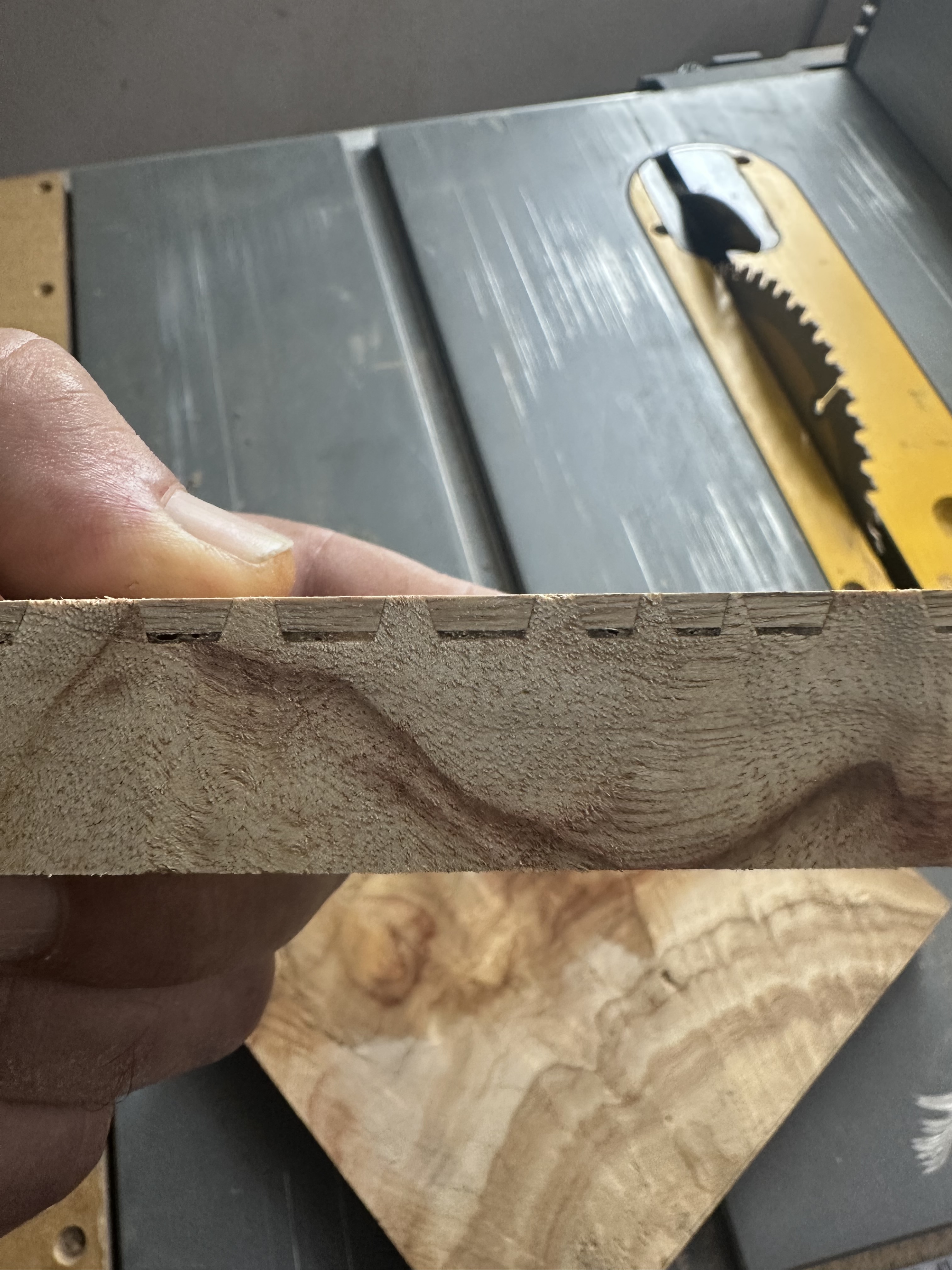

I’ll be curious to see tomorrow morning when I surface the plug if there any gaps. I’ll also slice the piece down the middle to see if there’s any gap under the plug too.
A 0.3mm flat spot will result in a 0.3mm gap between the pocket & plug if using the desired depths, I assume something like plug depth 3.5mm, top gap 1mm.
To adjust, the depth needs to be padded by about 1.2mm, and that’s just for the tool.
Take into account any slop, runout, deflection, clamping compression… your 0.0 plug depth is a good place to start.
After you cut it, subtract the difference between your desired glue gap and the actual glue gap.
So you may program plug depth 1mm, top gap 3.5mm…???

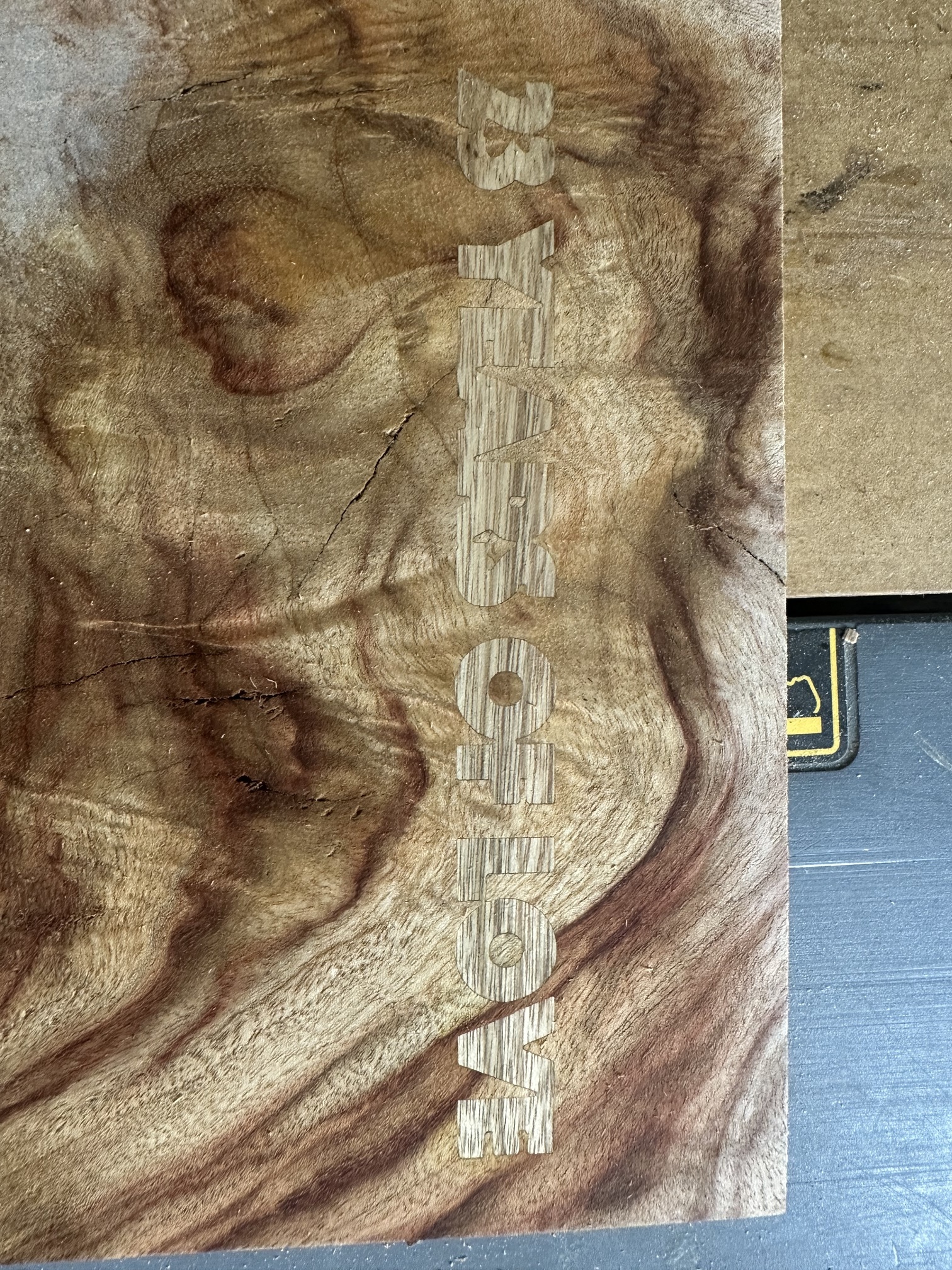

UPDATE: I cut the plug off this morning and it actually sits really good no gaps that I can see. I also sliced it down the centre to see the bottom gap and it appears to be about 1mm of glue gap. Pics attached.
I don’t know how it worked, but it seems to have worked.
Now fingers crossed the these settings will work for the main piece because I have til tomorrow to make my wife’s wedding anniversary gift :man_facepalming:
