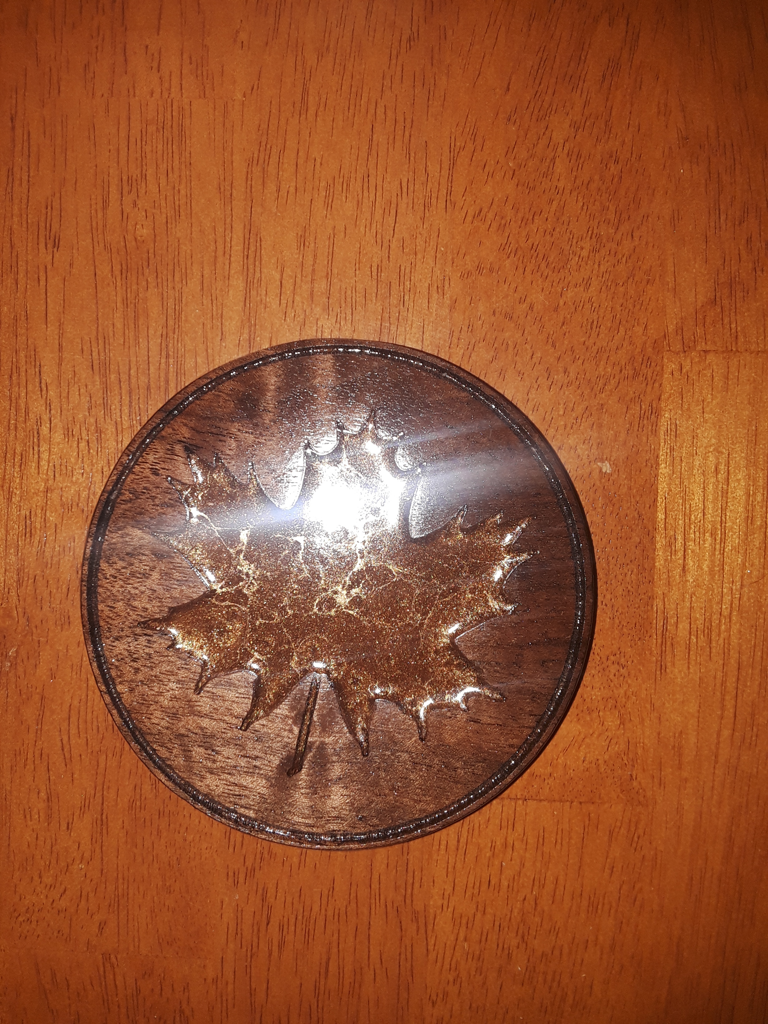

V-carve + resin inlay
I have been wanting to try epoxy resin inlay for a while, here is my very first attempt.
Not perfect, but it gave me all sorts of idea of where to go next with this technique, and it’s easy enough.

Looks good. What kind of resin did you use? Did you put it in carefully enough to not need to sand it?

I used a “Resin4Decor high gloss epoxy resin”. And I learned the “do not put too much resin” lesson the hard way, I had to sand off almost 1mm of epoxy and it took forever :slight_smile:
While I was at it I did a set of coasters, using beech. The resin bled a little bit in the wood, while I had zero bleeding with the bamboo. Interesting…

You can try painting on a very light coat of clear resin first then adding the colored resin after it dries. They look good in the photos.
Use a coat of sanding sealer on porous wood first.
How did you apply the resin? What depth did you use? It looks great!
I just poured the resin from a cup, but way too much. Next time I’ll use a syringe or something to be more precise and minimize the sanding. The depth is whatever the 90deg Vbit took to carve the features, about 3-4mm at the deepest places.
I found out that air bubbles could be formed in a resin inlay from raw wood. So I applied polycrylic to the inksyvfirstvto seal it. Worked perfectly.

Bamboo is just a grass and somehow bonded together to make “lumber” so I assume the bonding agent seals the bamboo in such a way to prevent bleeding. Inherent in regular wood is air and unless you seal it first there are bound to be air bubbles. However a heat gun or torch just after pouring the resin held about 6-8 inches above the piece will pop the air bubbles. I have had great success with a product called art 'N Glow clear casting resin. www.artnglow.com/resin
It makes perfect sense thanks (bamboo). I did use a torch on the second try, no bubbles. Next time I’ll be less lazy and apply a coating before pouring the resin and it should be all good
Julien, we must have some thoughts in common: I have just done a resin filled set of v-carved items, too! Used the art’N Glow resin to fill drink coaster inlays, and flower /herb inlays on some cutting boards. I ran into a “slight” problem on a couple of boards. When mixing the resin, I mixed equal parts of resin and…resin! Both are colorless, and my aging eyes allowed the dummy here to pour and mix pure resin and think it would harden. Whoa! Makes for a messy cleanup after the resin sits on end grain for a day or so. :sleepy:
