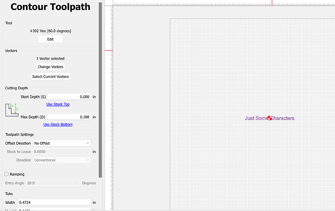

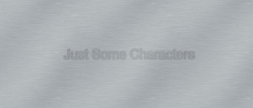

In CC v8 I put some .5" font up and tried a vcarve tool path with a #302 and a 15 degree vee bit and it was empty. However I deleted that and tried a contour with no offset at .1" and a #302 vee bit and it worked.
Here is the simulation.

Which version of CC are you using? My example above was CC v813 which is not quite the latest.
