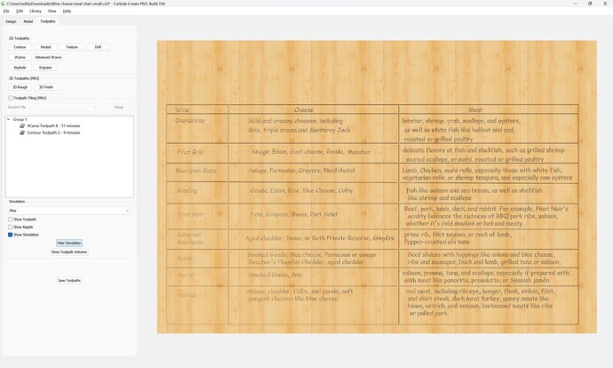

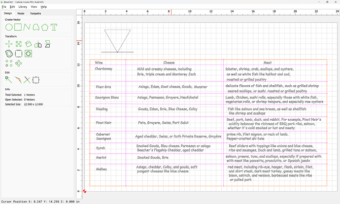

Given a mix of open and closed geometries:
which one wishes to V carve, doing so does not yield the desired result:
because only the closed geometry (the black rectangle) is used for the V carving while the open geometry (indicated by being magenta) is not cut.
One option would be to just use a No Offset Contour toolpath to the desired depth instead:
which will preview as:
which works well, save for the rounded corners — to achieve a “Normal” V carving it is necessary to adjust the geometry to match the perimeter of the desired V carving as closed regions — this requires a bit of drawing…

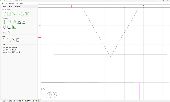

The first step is to either do the trigonometry, or draw the cut up in profile so that we will know how much to offset things — this will be done in v8:
Use Boolean Intersection:
OK
to get the profile of the cut geometry:

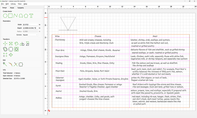

and draw a rectangle to measure:
and we see that we need to offset things by 0.0361 inside and out — sort of — we actually want to increase the rectangle by that dimension all around:
Unfortunately, it is not a rectangle asymmetric scaling could be used with this, but it’s easier to just use control-clicking to draw the rectangle:
Repeat this for the interior, but subtract:
