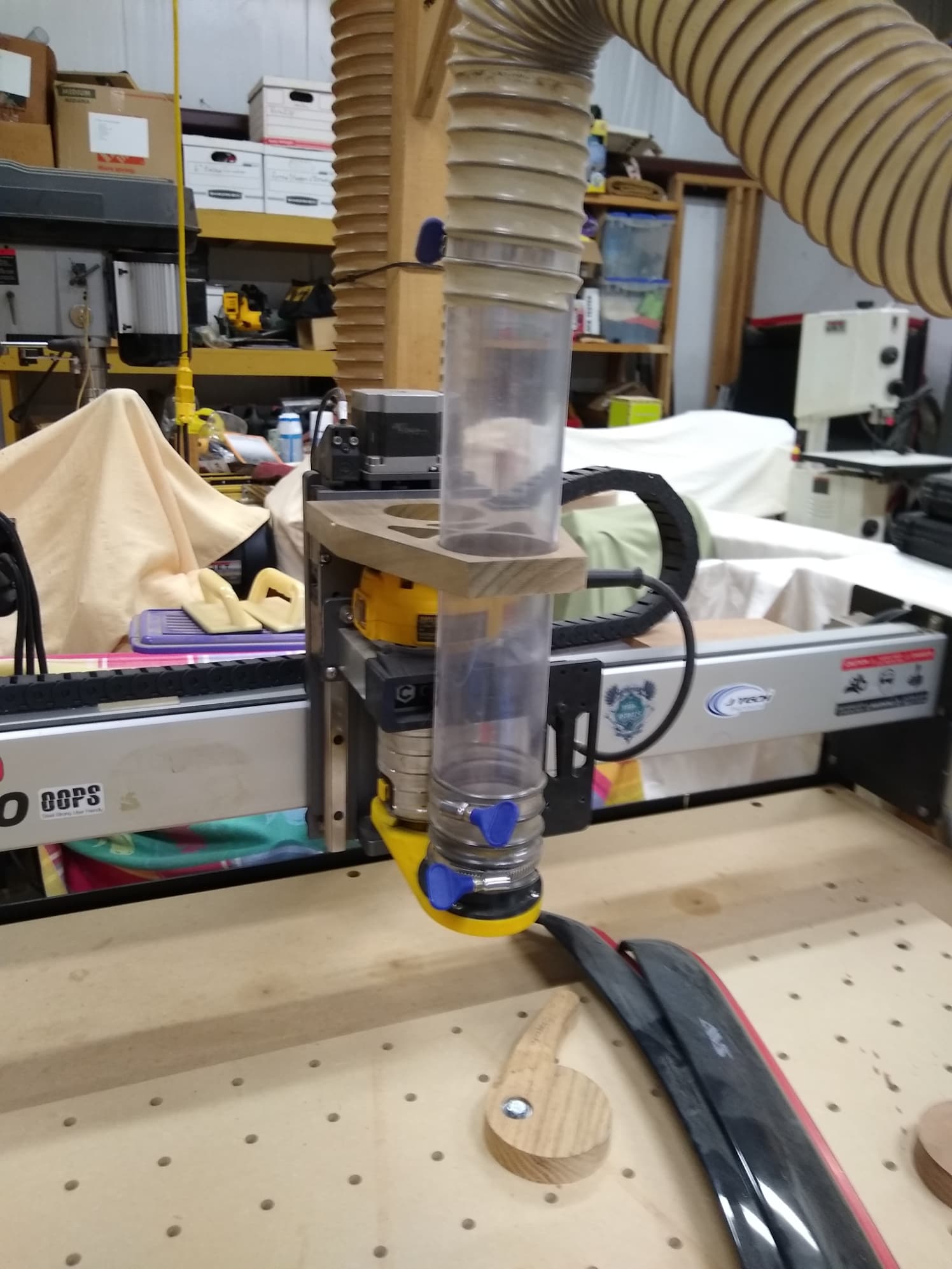

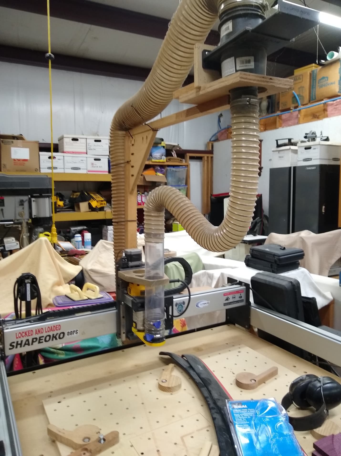

I have an SO3 with HDZ so it is not an SO5. However I made a custom mount to go above my router to hold a straight pipe that attaches to a flexible hose. The flexible hose if up high enough so it never gets caught on anything on the full motion of my machine. Also I have what I call the diving board where a 4" hose adapts to a 2.5" hose above do my dust collection hose is in the middle of my spoilboard. Maybe you can make something similar.

I originally had my hose mounted lower and used some bungee like string to try and keep it up out of the way of the gantry but it seemed like it was always getting kinked so I switched to this Frankenstein mess. It works really well, but I do plan to switch to a 4” blast gate mounted up near the main pipe and have that controlled by my iVac system. Then I can ditch the lower blast gate and clean things up at the router. This hose is flexible enough that I don’t have any issues. Looks like the same proposed by @CrookedWoodTex but shorter length.
Thats a very tidy looking vacuum set-up. Well done. Silly as it sounds im excited to do the vac project on mine. Thank yoi.
Thanks. I call it Frankenstein because there are three adapters plus’s a blast gate. Between the sweepy and the hose. Hopefully I can clean that up.

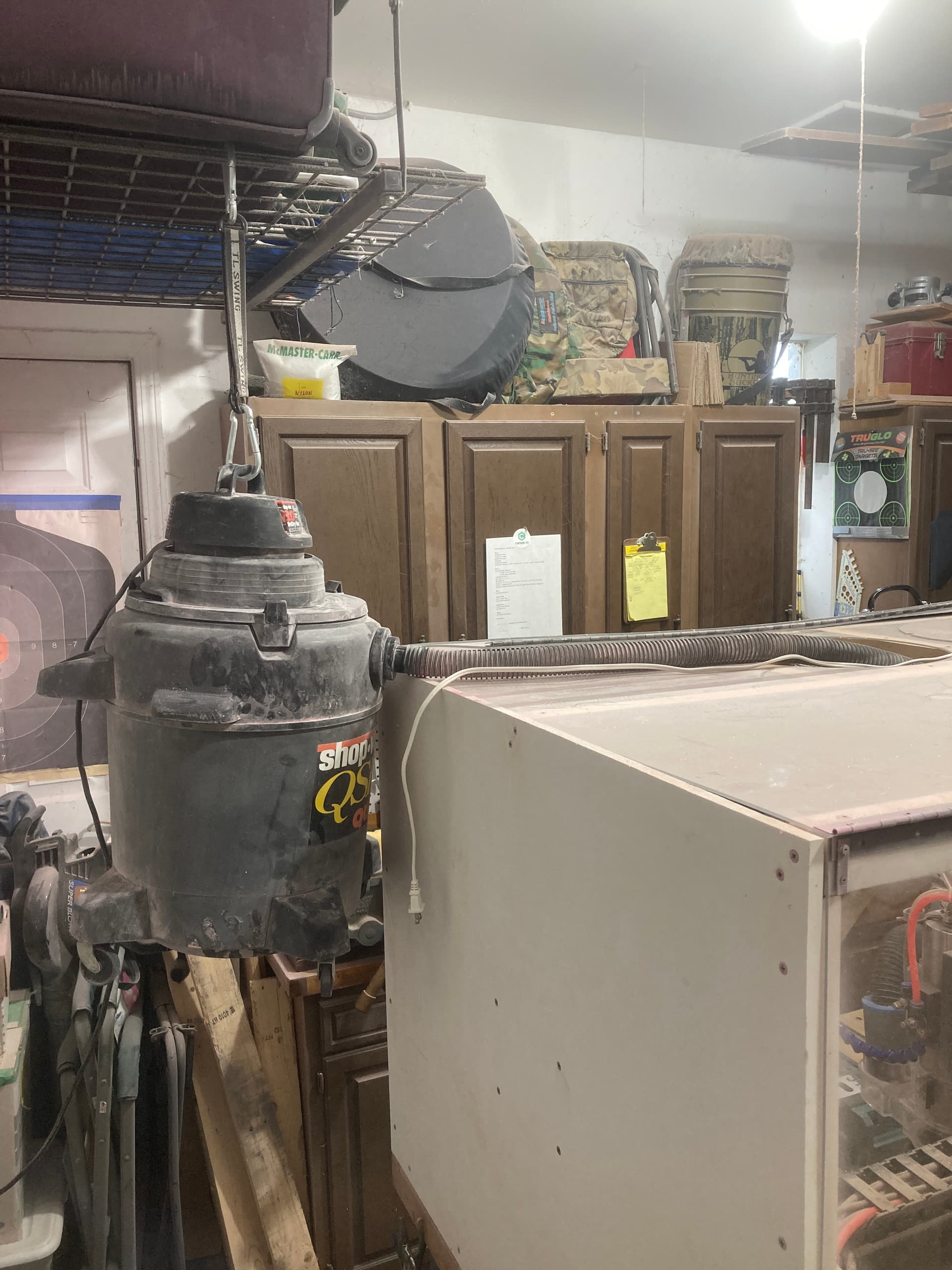

The hose on my shop vac wasn’t long enough, so I hung it from a ceiling rack next to the machine.

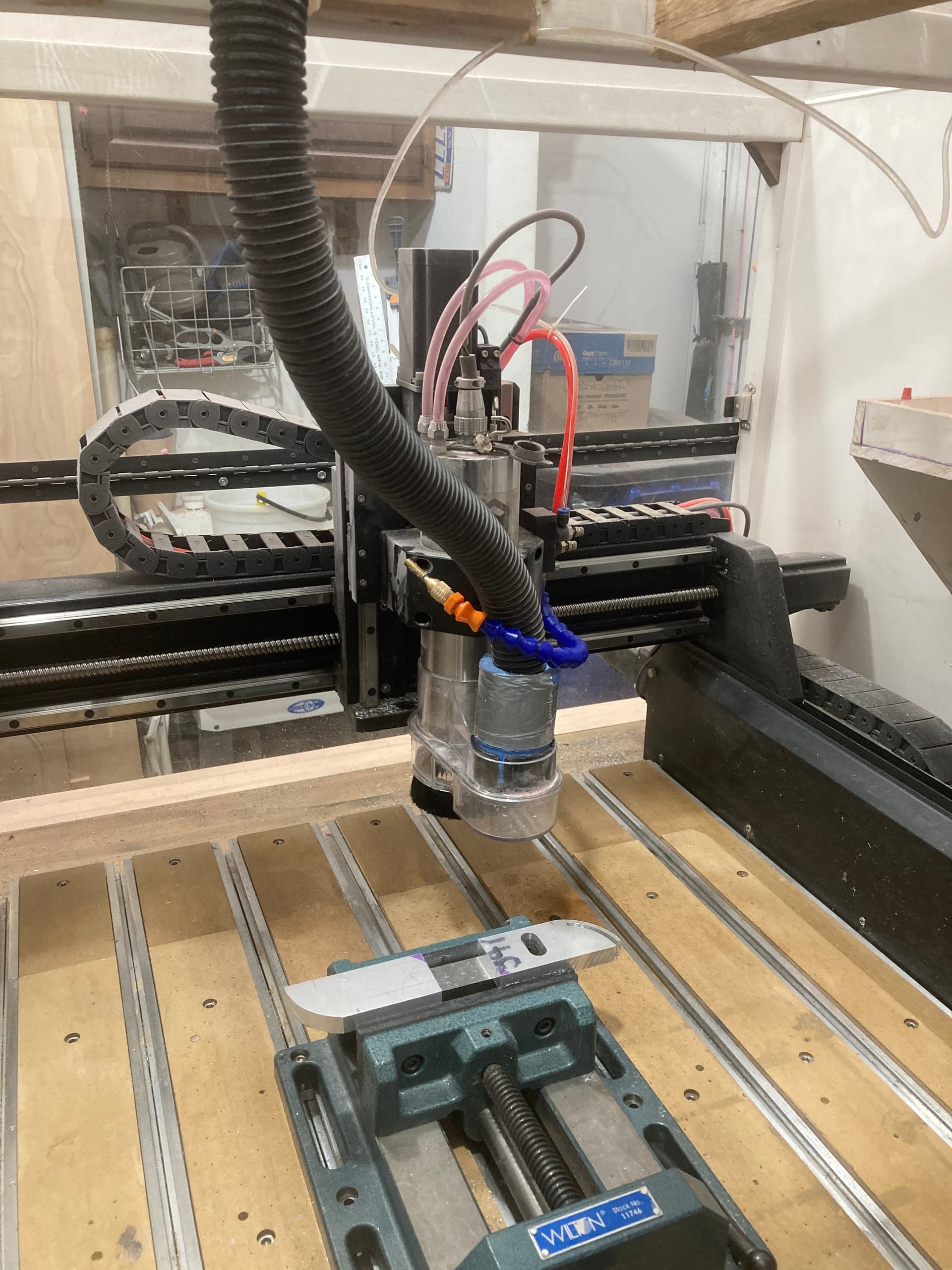

Pool noodle & duct tape for an adapter. I use the mist nozzle wrapped around the hose to stabilize it.
It works really well, except on deeper cuts I have to keep pausing & moving the sweepy up. It works best when the brush is no more than 1/2" away from the surface.
I may modify it so the sweepy is mounted to the X axis rather than the spindle, then I could set it to the surface height & it will stay there.

I love the levitating shop vac.
Yeah, sometimes I have the sweepy mount barely hanging on and other times I am afraid I am going to bottom out the plastic if I don’t pause and readjust. When cutting HDPE recently it seemed that it the bristles weren’t touching the surface then the chips would find a way out.
