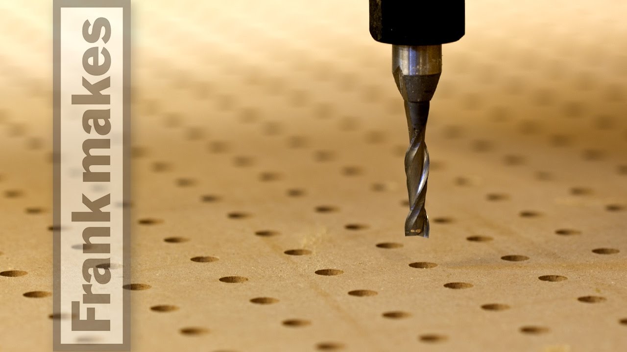

I am planning on using a shop vac. I only have access to MDF. The top I was planning on making look like an air hockey table. There are channels through the inside to those holes. I was kind of basing it off this video:
Some distributors call LDF other things like “lightweight MDF”. It isn’t super critical especially if you go with 1/2" thick MDF instead of 3/4" as the top plate.
I have generally avoided that style because they lose a bunch more suction if you uncover a hole while cutting vs a plain MDF top. Typically you have to put another thin layer of permeable material (such as Datron’s vac card or this: Black Box Grip-Lock Mat - Black Box Vacuum) on top in order to prevent loss of vacuum. You also must cover any unused area every time. I know that style can work and have used it in the past, it just takes more thought and planning to use. The industry standard on large machines is to use a plain MDF/LDF top because of the ease of use and lower CFM requirements to get the same level of vacuum. I’ll never go back now that I do it this way. You can see my Avid based machine with the table I made here: Chasing zeros on a Shapeoko 3 - #26 by nwallace
