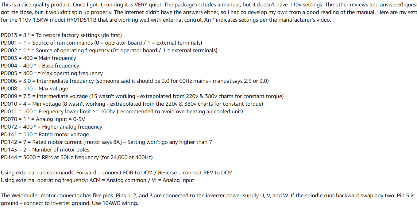

Installed a VFD that I got from Amazon and set up the settings as recommended by a review.

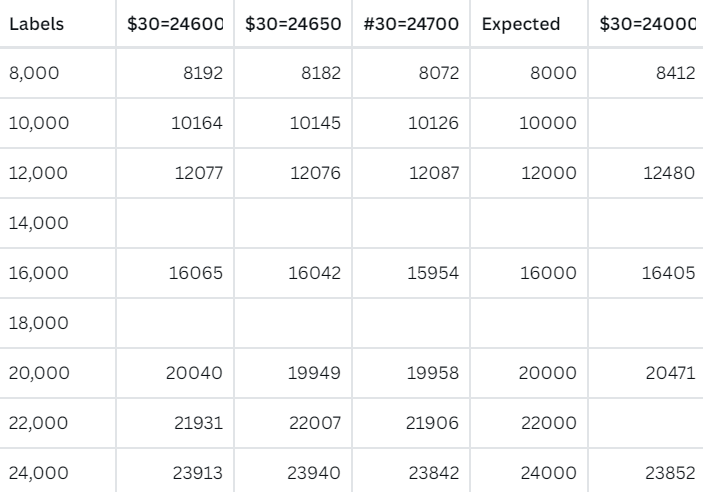

I verified that the $30 value is 24000. I ran a few tests with the M3 SXXXXX command and recorded the rpm with a tachometer.
6k → 6354
8k → 8412
12k → 12480
16k → 16405
20k → 20471
24k → 23852
Is there any way to tune the spindle speed or is this just a normal thing?

Made a small workaround for this issue. Set $30 to ~24650 and now 12k rpm is almost spot on. Other rpms are now within a 100-150 variance. Even 24k is still at about 23800. I think this is about as good as its going to get, probably wont make much of a difference when machining I hope.
In the controler there will be some settings that adjust what max input = max frequency. You can adjust this down to match the input. It will however skew all other inputs up slightly. My controller is different, but for example:
P03.11 - Analog Input 1 A/D Upper Limit - 0-1023 (A/D Count = 0-10Volts Input)
Mine is set to 5v, and my board puts out a true 5v @ S24000 with $30=24000. I believe my controller is set to 1020 which yields me 400hz output or max rpm. Look through your VFD manual settings and you should see a similar option. You can also set a minimum which will shift the entire thing up. All you are doing is adjusting the scale of output based on 0-5v (in this case) input.

I looked through the manual for the VFD and there is no option to change analog input level other than 0-5V or 0-10V. For now the best I can do is skew the max RPM in the GRBL settings to bring the other values closer. A $30=24650 seems to be the sweet spot with low RPMs being a tad on the high side. I doubt I will be running much at low speeds. I’m waiting for a response from C3D if I can get a replacement board with a true 5V output. Seems like the voltage regulator on the board is bad.
