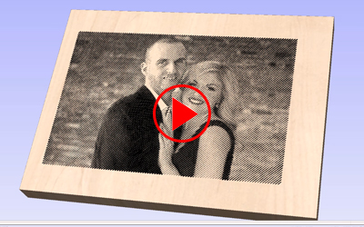

PhotoVCarving
Convert photographs and images into toolpaths producing stylised engraved designs. ![Optimizing Clearance Tools in VCarving]

PhotoVCarving
PhotoVCarving
