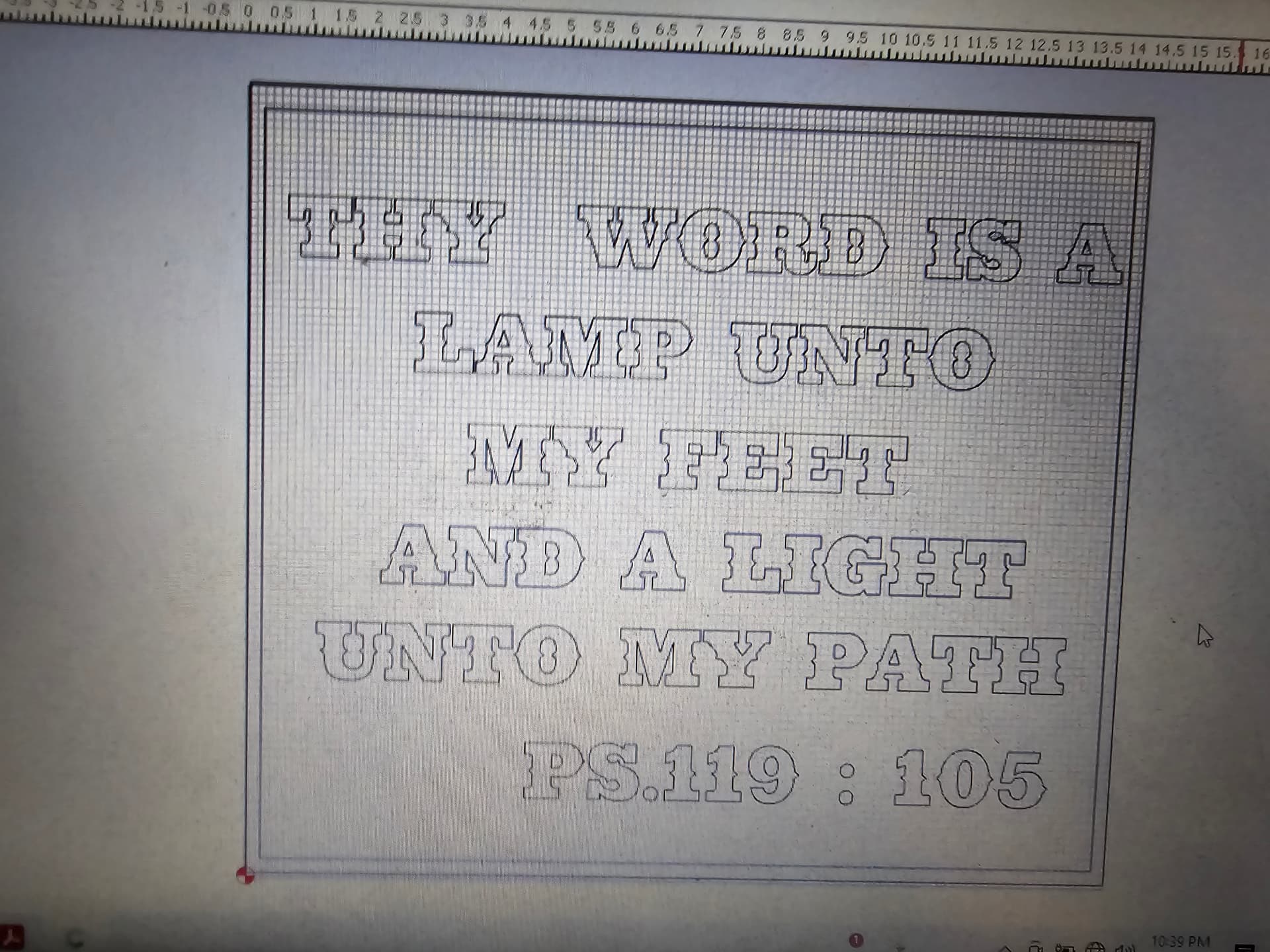

I setup a vcarve with just using a v bit and when a ran it it plunge strsight down cime right back up move some where else plunge down come back up over and over leaving little holes bssically if you know what i mean why is thst or is that normal

I didnt use a clearing tool only a v but or should i use a different toolpath im doing a bible verse
Even without the clearing tool, it goes through 3 of those steps. So the “sewing machine” moves are normal.
You can use a V tool at a constant depth with a contour path if your vectors/lines can all be the same width. Like with a single line font, or a pencil drawing.
Can you show a picture of what you’re carving?
Hhere ya go guys apologize for the long wait
That is a photo of the screen, not the actual .c2d file.

That’s enough to tell me a single line strategy won’t work. Looks like the letters/characters have widths of about 0.2" - 0.4". That would get you a max depth of about 0.2" with a 90° Vee, or almost 0.4" with a 60.
So, yes it’s going to poke / sewing machine a bit, then carve along the vectors, then pick out the sharper corners. In this case, you want the sharp corners picked out, so that’s the path you get.
