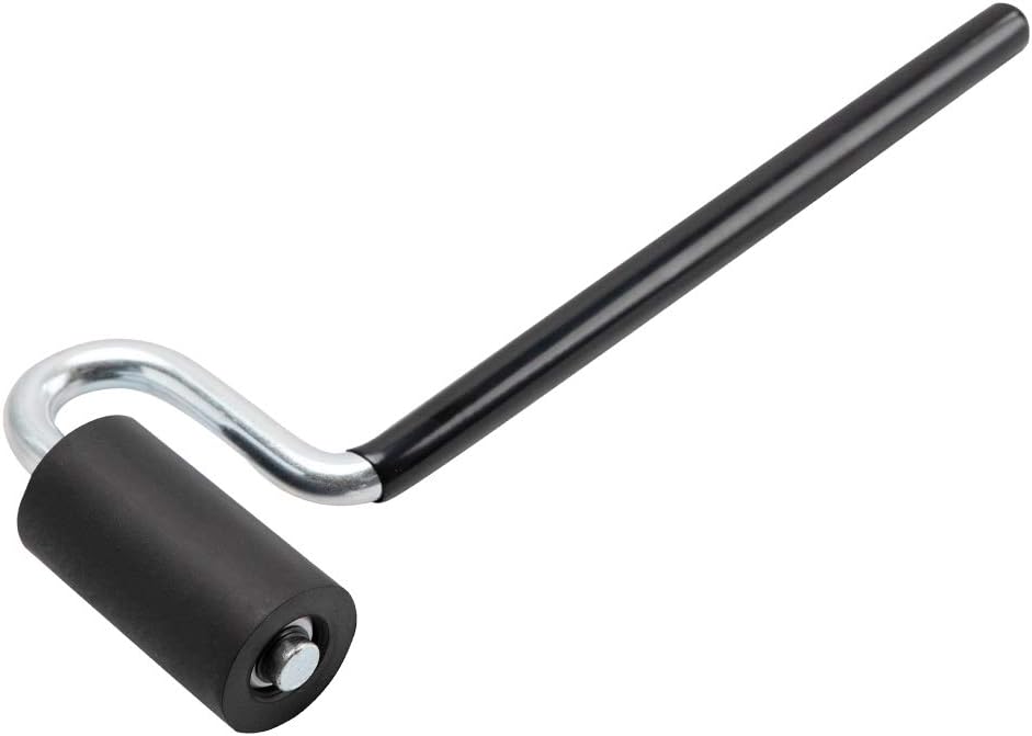

Any masking you use be sure to use a J roller to press it down to get good adhesion. Simply pressing down with your hand will not make it stick as good as a J roller.
