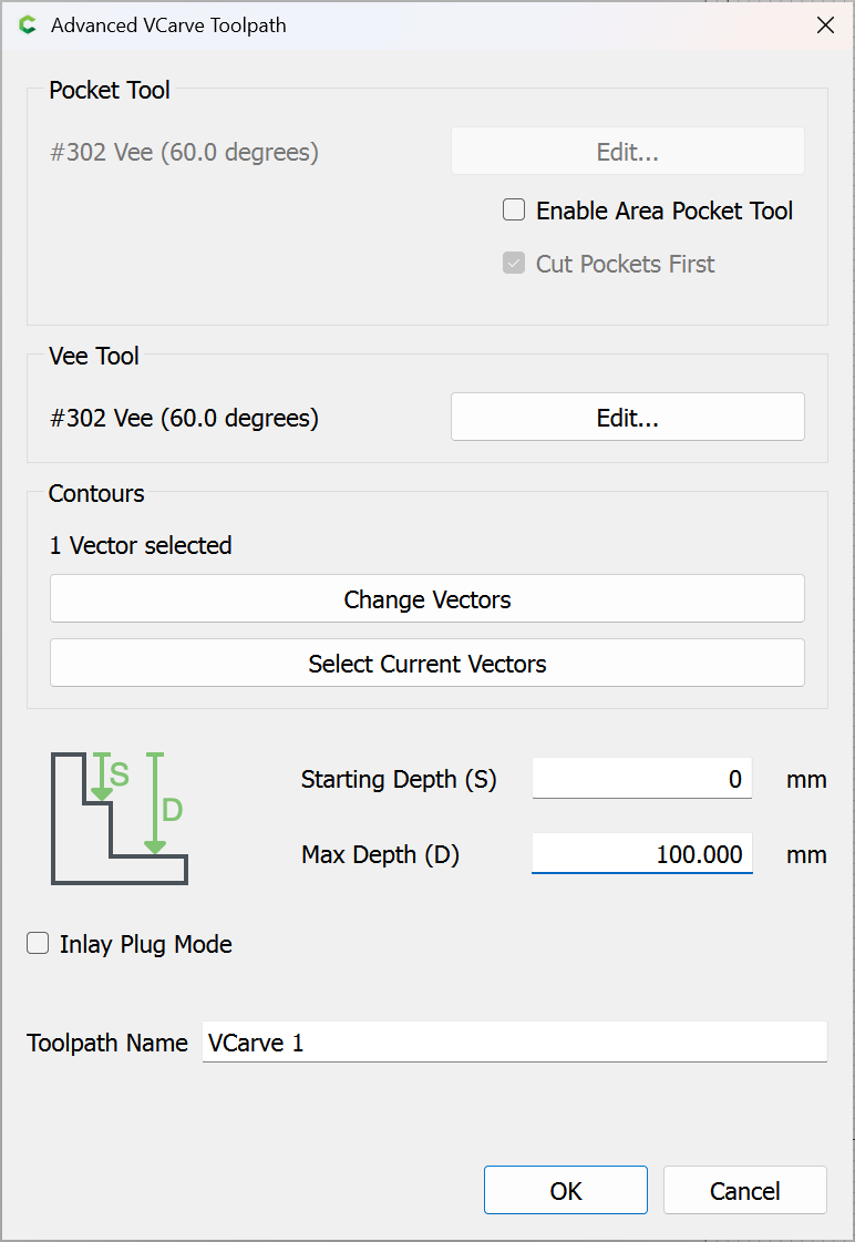

I have a post with a 100mm square cross-section but it is roughly hewn. I want to carve some text onto it. The highest point of the surface is where I have set Z to 0. However the lowest point on the surface is 9mm below that.

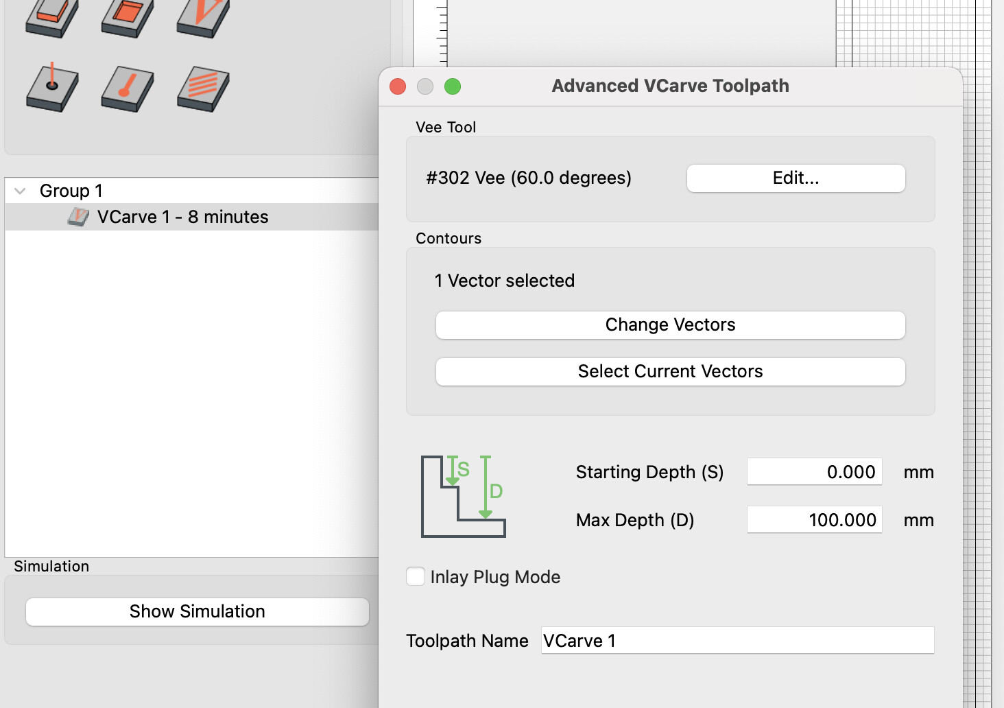

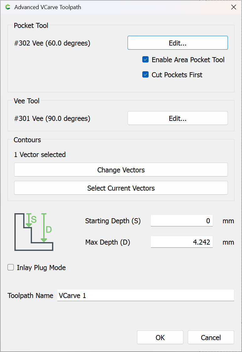

SO what I would like some help with is the “enable area pocket tool”. What would I set the start S and max D to be?
Or should I do a 9mm pocket first to get everything level and the just use vcarve without the area pocket tool, setting the S to 9 and the D to, say 15?
I should have mentioned I want embossed letters if possible rather than engraved letters, but either will do.
The “Enable Pocket Area” option is for the option of creating a flat bottom at the bottom of the V carve if the design is too wide/the toolpath too shallow for things to have the correct appearance.
The pocket first, then put the V carve at the bottom of the pocket is an expedient option, but will lose much of the character of the rough surface.

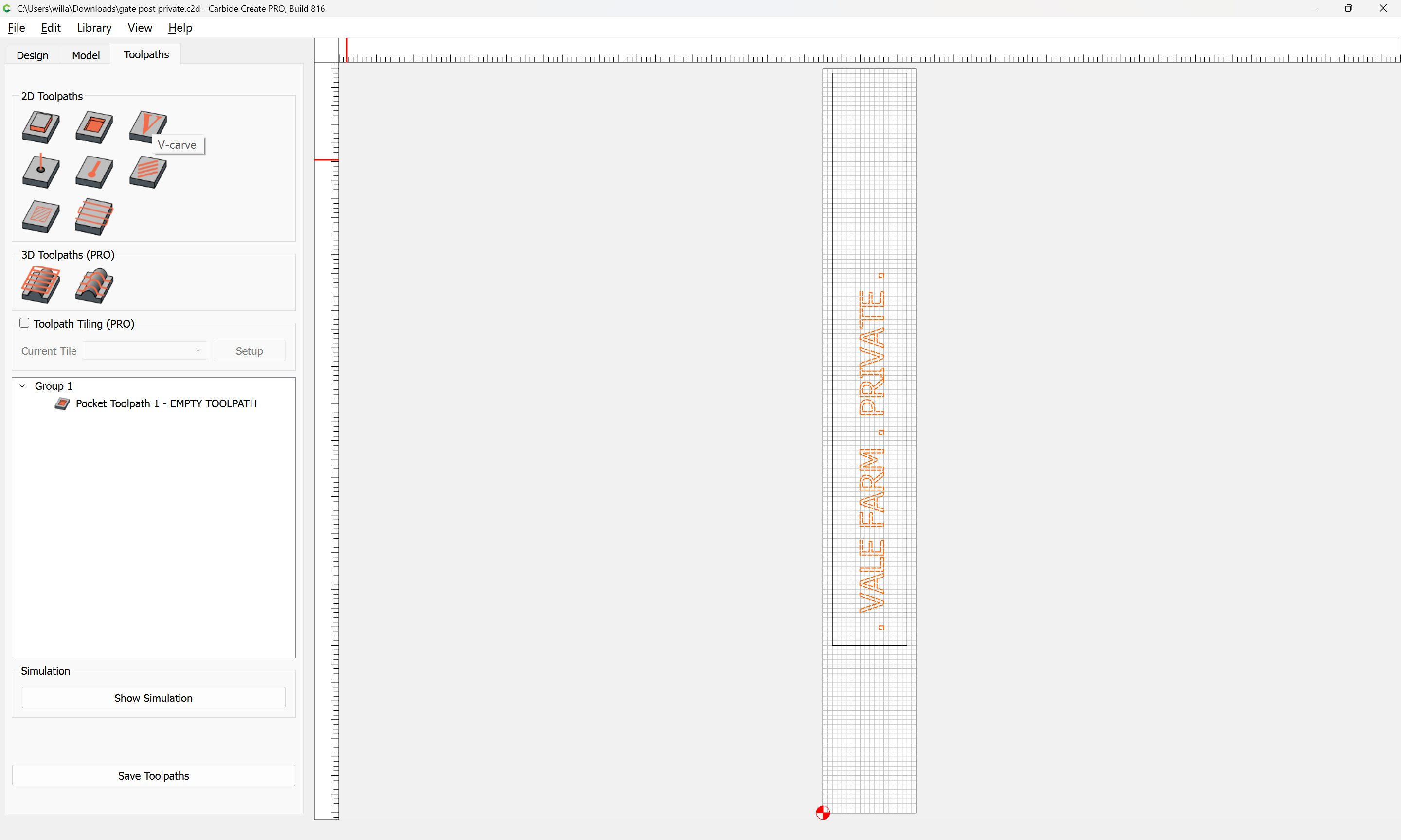

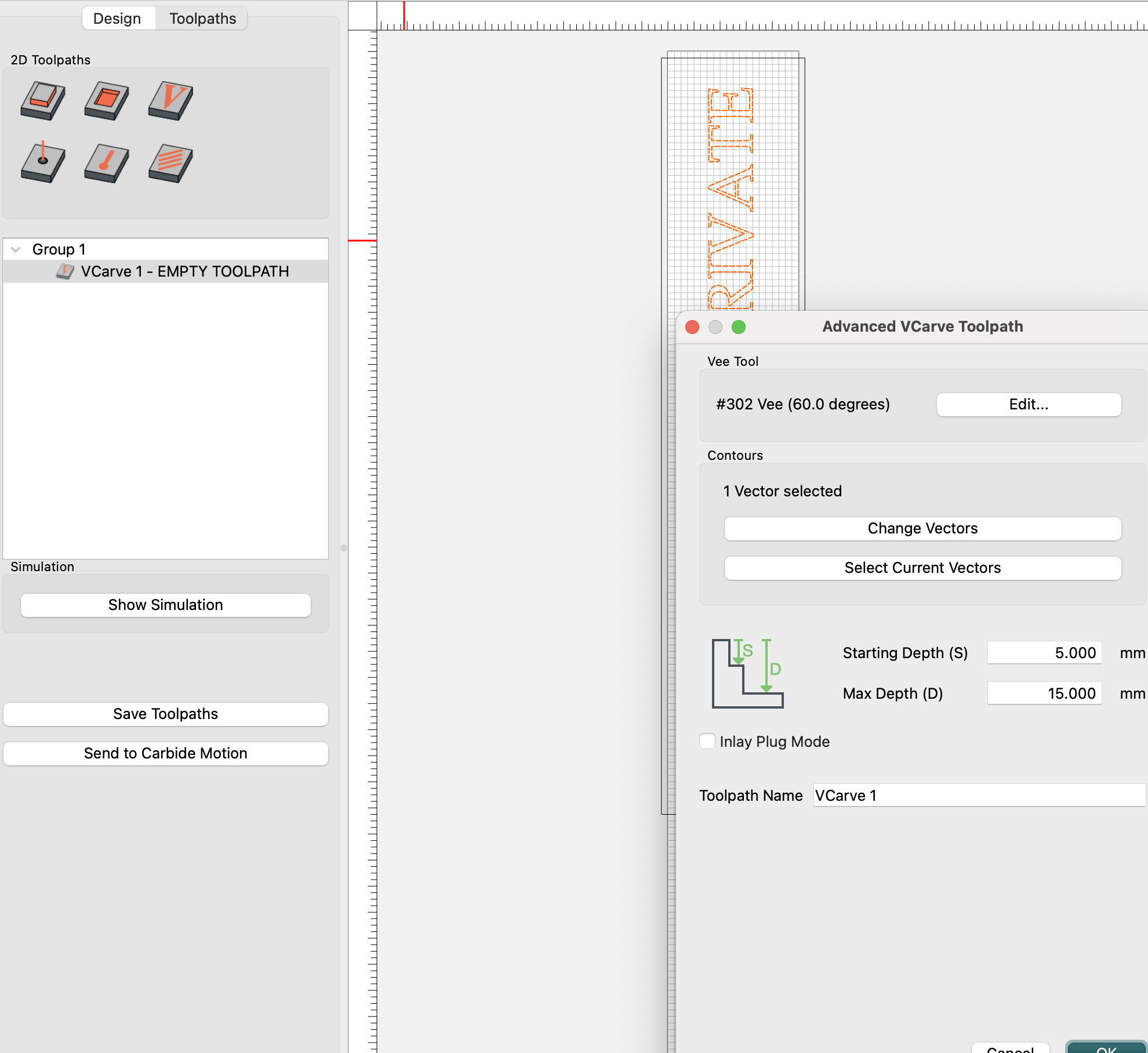

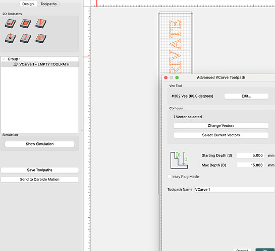

I cannot get the plain vcarve to produce a tool path
So yes maybe I change the v-bit for a flat bit and go with the embossing. The v-bit could be problematic because the font will go fat and thin due to the uneven surface.

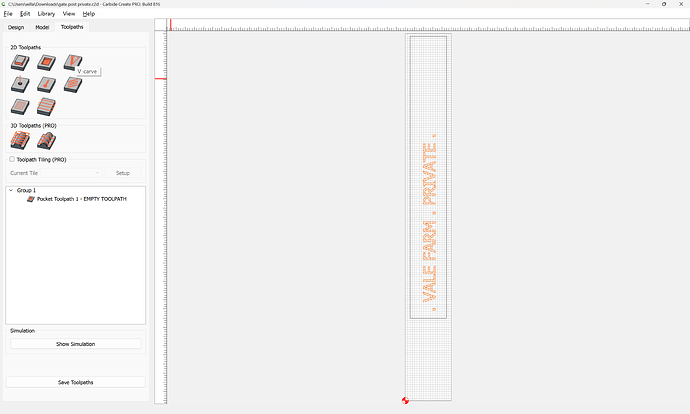

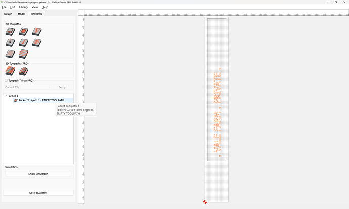

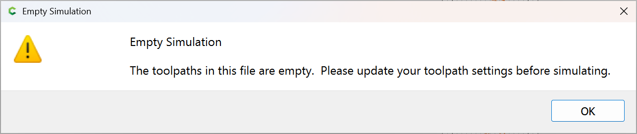

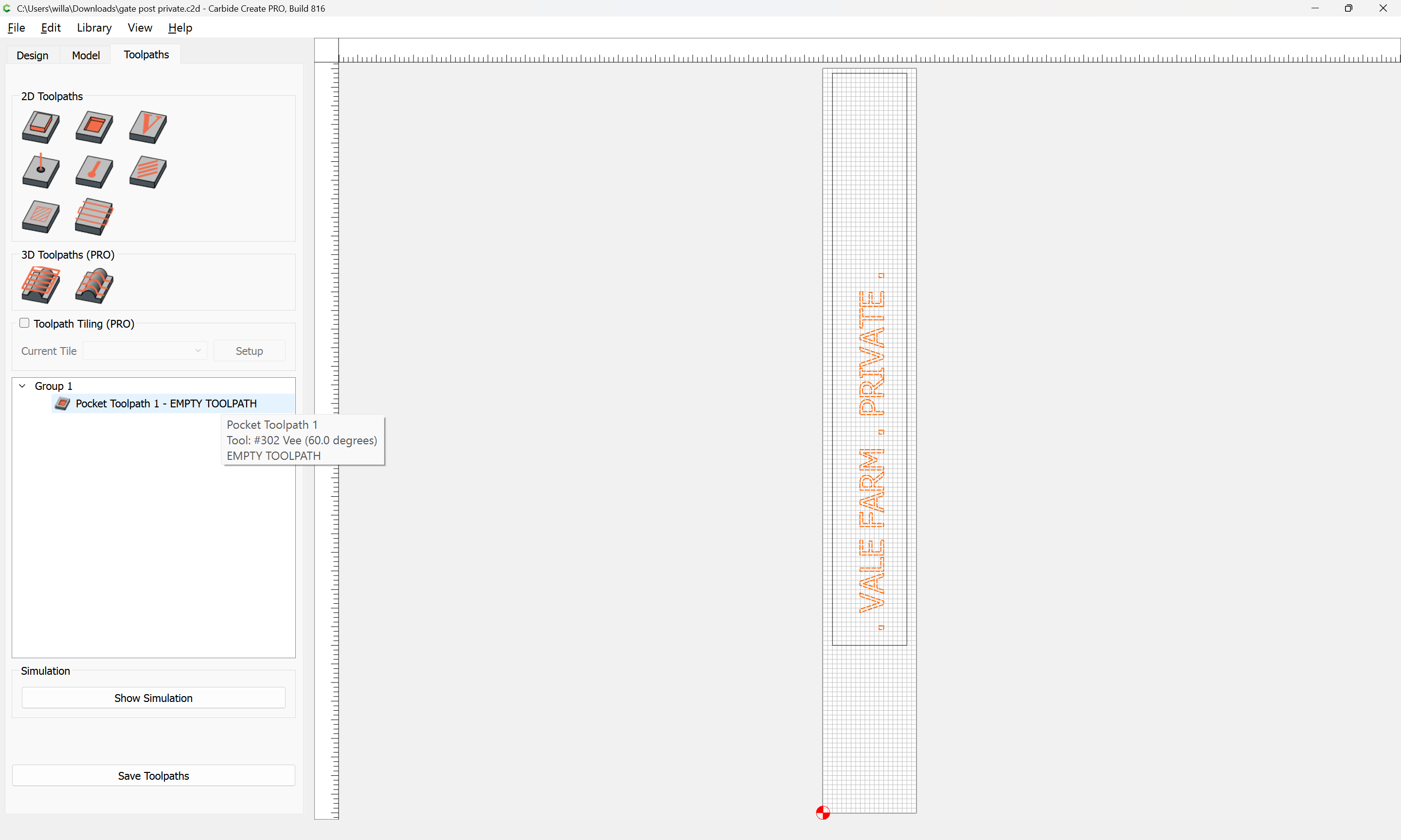

You are trying to assign a Pocket Toolpath using a V tool:
which does not generate a preview:
see:
https://carbide3d.com/hub/courses/create/simulation/
and if sent to the machine would immediately end.

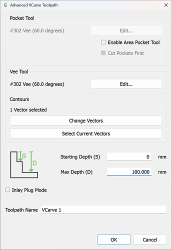

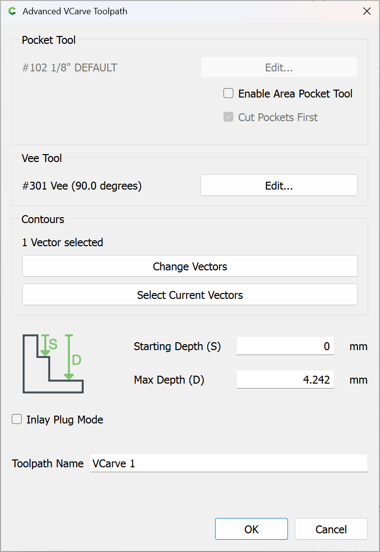

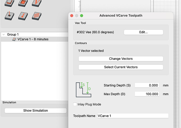

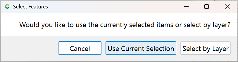

You want to assign a V carving toolpath:
Use Current Selection
I find it best to enable Pocket Clearing:
and assign the same tool which will be used for the V carving if one is not actually using that feature
(it may then be disabled)
which then previews as expected:
attached as a v8 file:
gate post private_v8.c2d (76 KB)

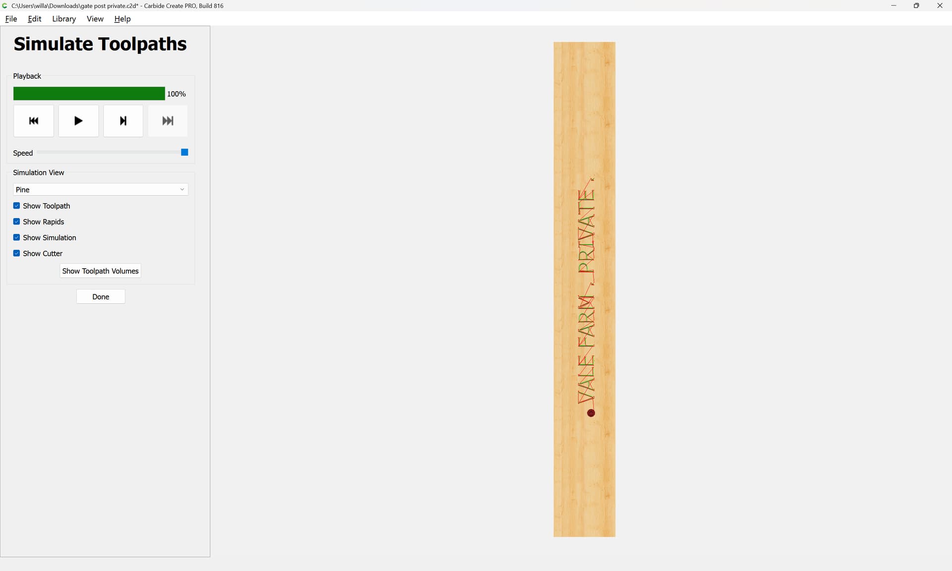

Thank you. Because 9mm is so large compared to the V60 bit, I will need to flatten the surface a bit. The dream would be to be able to sample the surface which is what I do with my xtools laser cutter for example.
There is a 3rd party tool, bCNC, which will allow probing the surface and which will then map the V carve to that surface — probably there are others, but you’ll need some sort of probing setup (covering in alu. foil and using a conductive probe is the usual approach).
