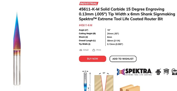

newfylukey
(Luke Harris)
November 7, 2024, 6:30pm
9
This is the 30 degree bit. Does anything there seem off to anyone?
WillAdams
(William Adams (Carbide 3D))
November 7, 2024, 6:33pm
10
I would recommend using a #302 , 60 degree V endmill — the more acute angle means that the width variation as height/depth changes is less.
Tod1d
(Tod (with 1 'd'))
November 7, 2024, 6:39pm
11
I don’t think the angle of the bit is the problem. You should use the same bit for both sides, and for programming & cutting.
I meant an actual picture of the tool you are using on your machine. This was to verify the angle, and to make sure the point is actually “pointy”
