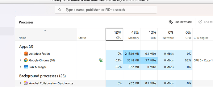

Watch the Task Manager and confirm if CC is using the nNvidia GPU.
My Dell have two , an Intel and a nVidia. Your maybe GPU 0 or 1
On this PC, the nVidia is GPU 0

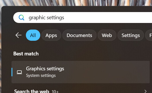

Graphics Settings

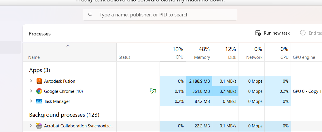

Recheck the Task manager.
Even when this is set, you sometimes have to Reset and then select the nVidia gpu again.
I have also had to remove the application and reselect it sometimes.

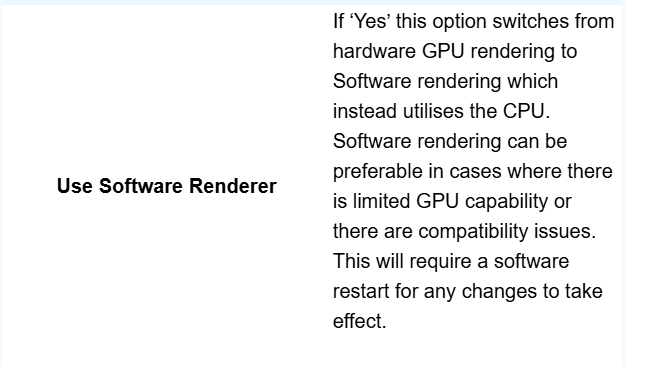

In 11 or newer there’s an option to use hardware GPU vs software render. There’s no universal answer what works better. Varies by machine. Usually in Vectric forums when someone says super slow its when Software Renderer is set to Yes and huge 3D toolpaths. Setting it to No will use GPU.
Under Edit > Options > 3D View Settings scroll down to Use Software Renderer. Whatever its set to can’t hurt to try switching and restart VC.

Started a tool path, 3D, and was very slow again. Went to Task manager.
GPU is NOT being use, however, Very high power was being used.

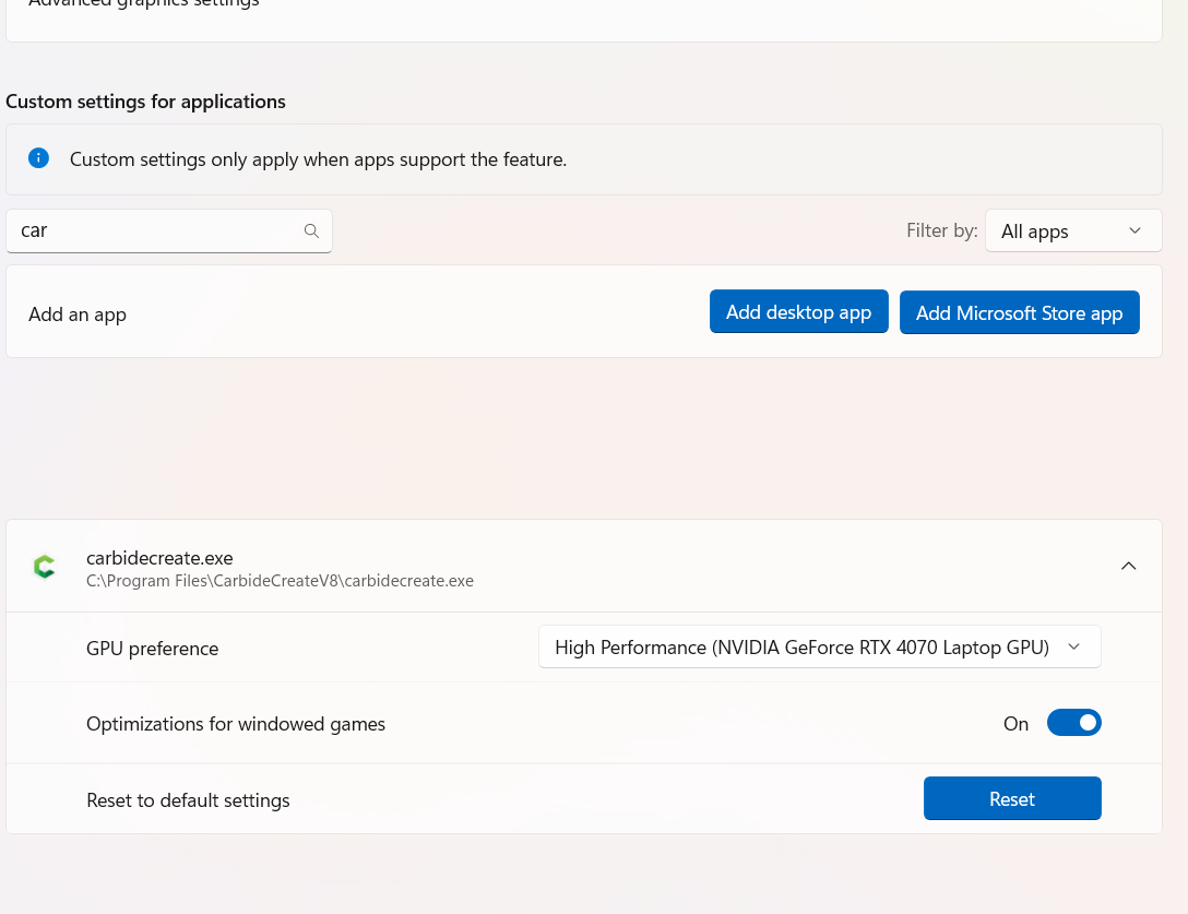

I also did what Jim suggested about the advanced GPU settings and added Vcarve to it.
No change, GPU still not being used.
Also checked Carbide Create, it is using GPU.

There is a setting in Aspire
https://docs.vectric.com/docs/V12.0/Aspire/ENU/Help/form/options-dialog/
Looks like this should be NO

I also confirmed in my Task Manager, it IS bring used.
