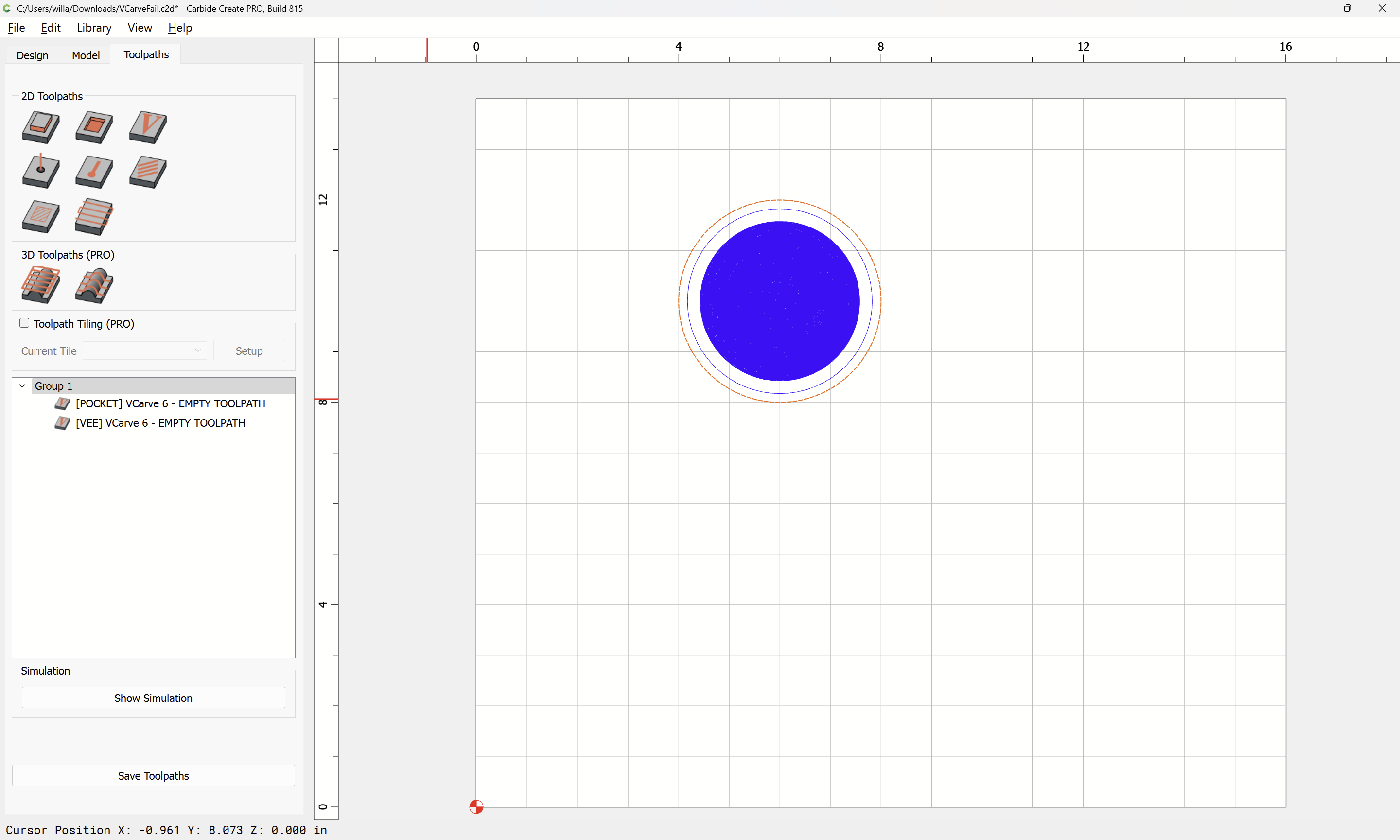

I’ve done a lot of projects on my Shapeoko 3 over the years but have never tried VCarve until today, and for the life of me I can’t figure out what’s going on with toolpath generation. I can create an arbitrarily simple shape, say a 5in diameter circle, select the #302 V bit and accept the defaults, select the vector, but when I hit OK and wait for the tool path to generate it leaves me with “EMPTY TOOLPATH” forever. I can create contour and pocket toolpaths for the circle with no problem.

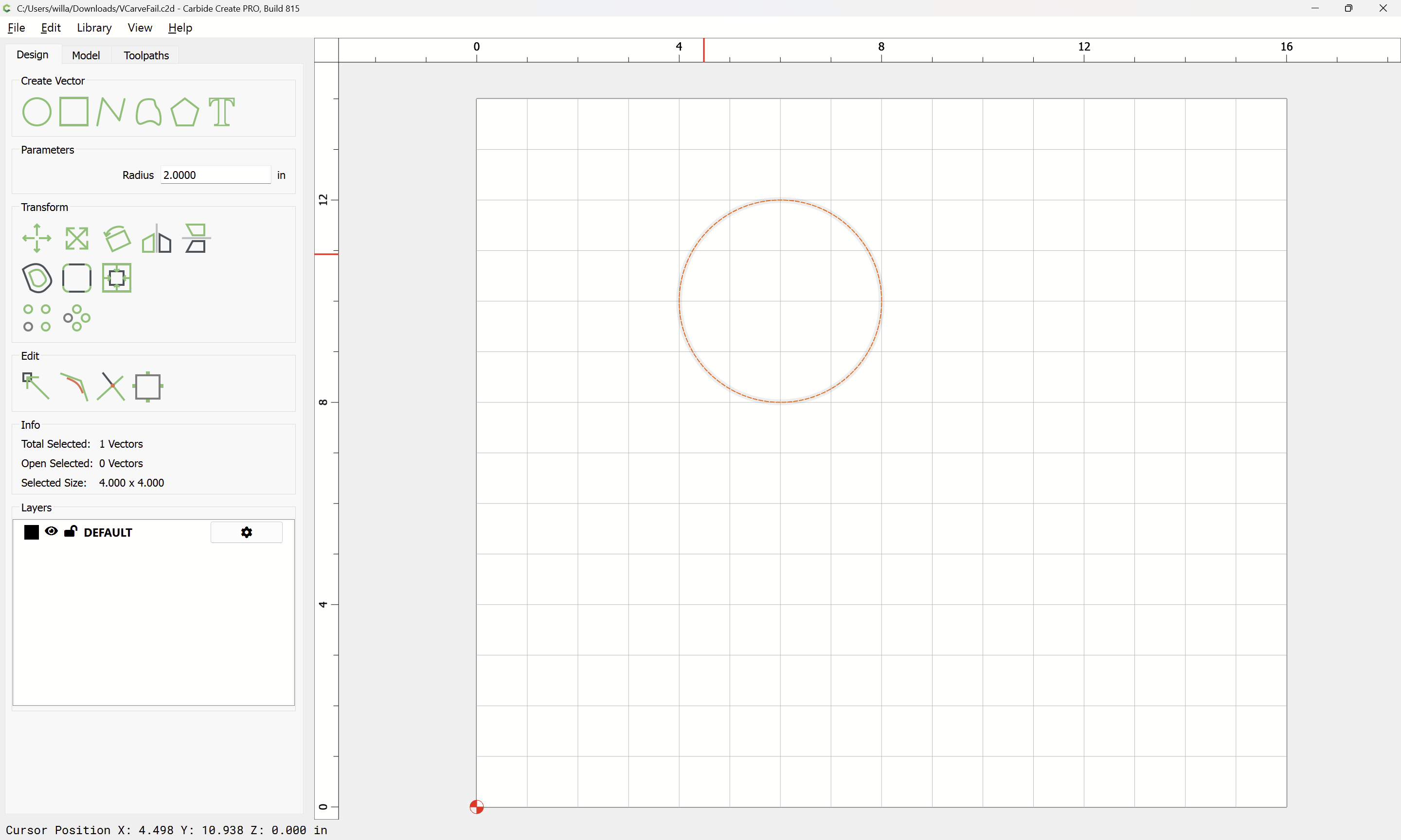

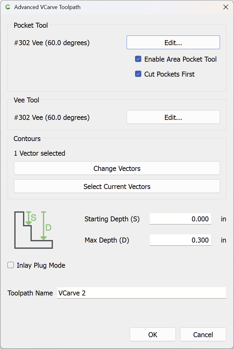

Okay, we select the circle:

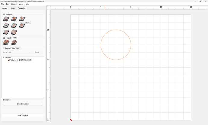

Switch to Toolpaths:
click

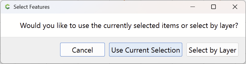

Use current selection

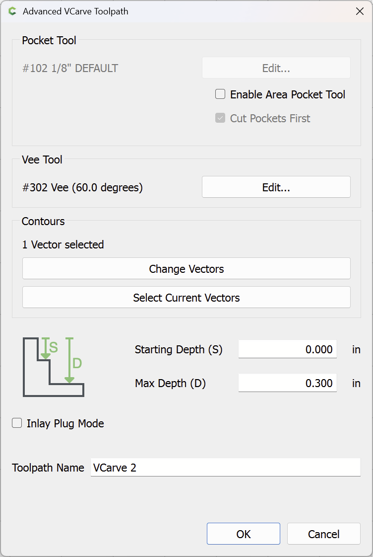

Fill in all the possibilities:

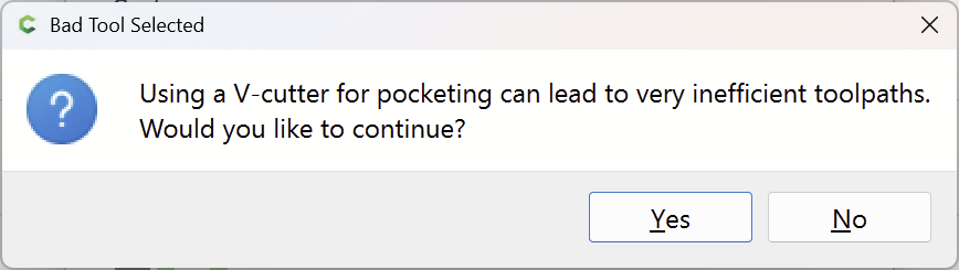

Yes

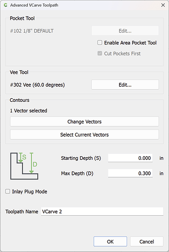

and make certain that the “Enable Area Pocket Tool” (after filling in that tool option and okaying the use of a V tool) is checked:
OK

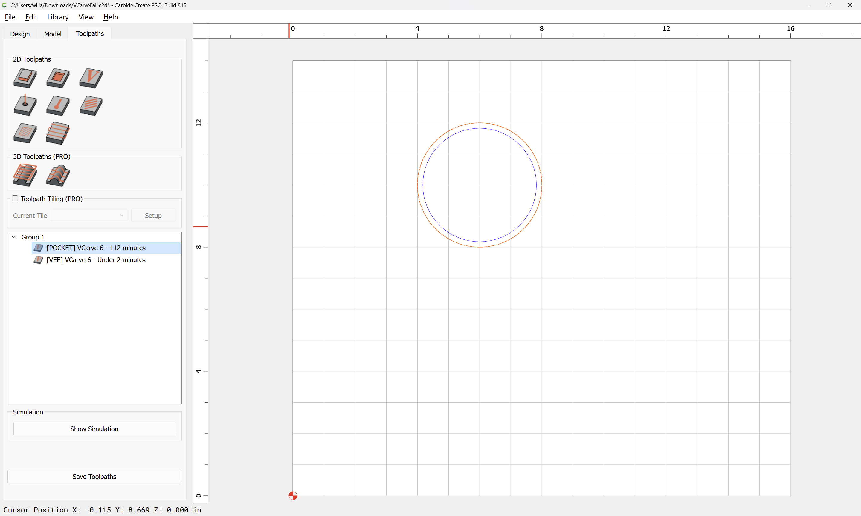

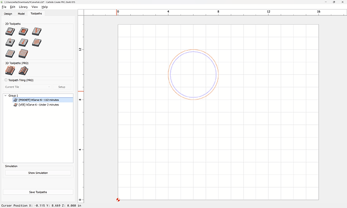

Disable the Pocket toolpath:

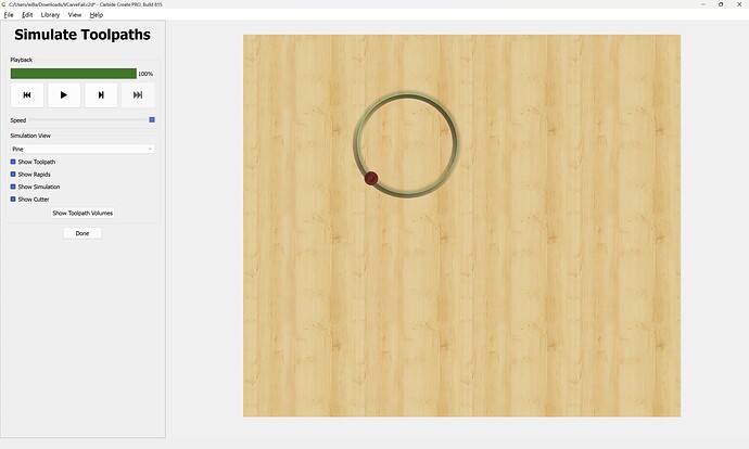

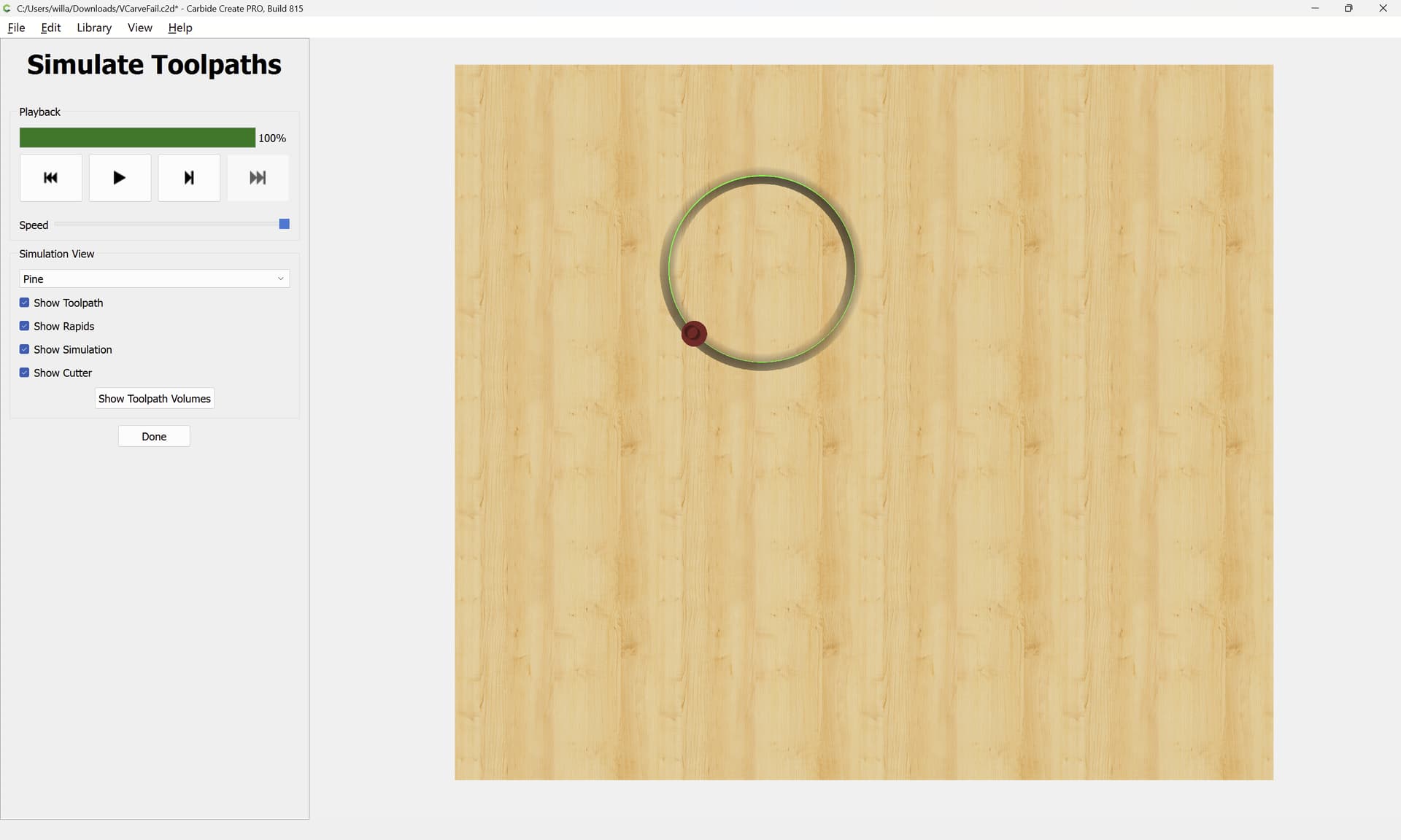

and one gets the equivalent of a V carve toolpath:
