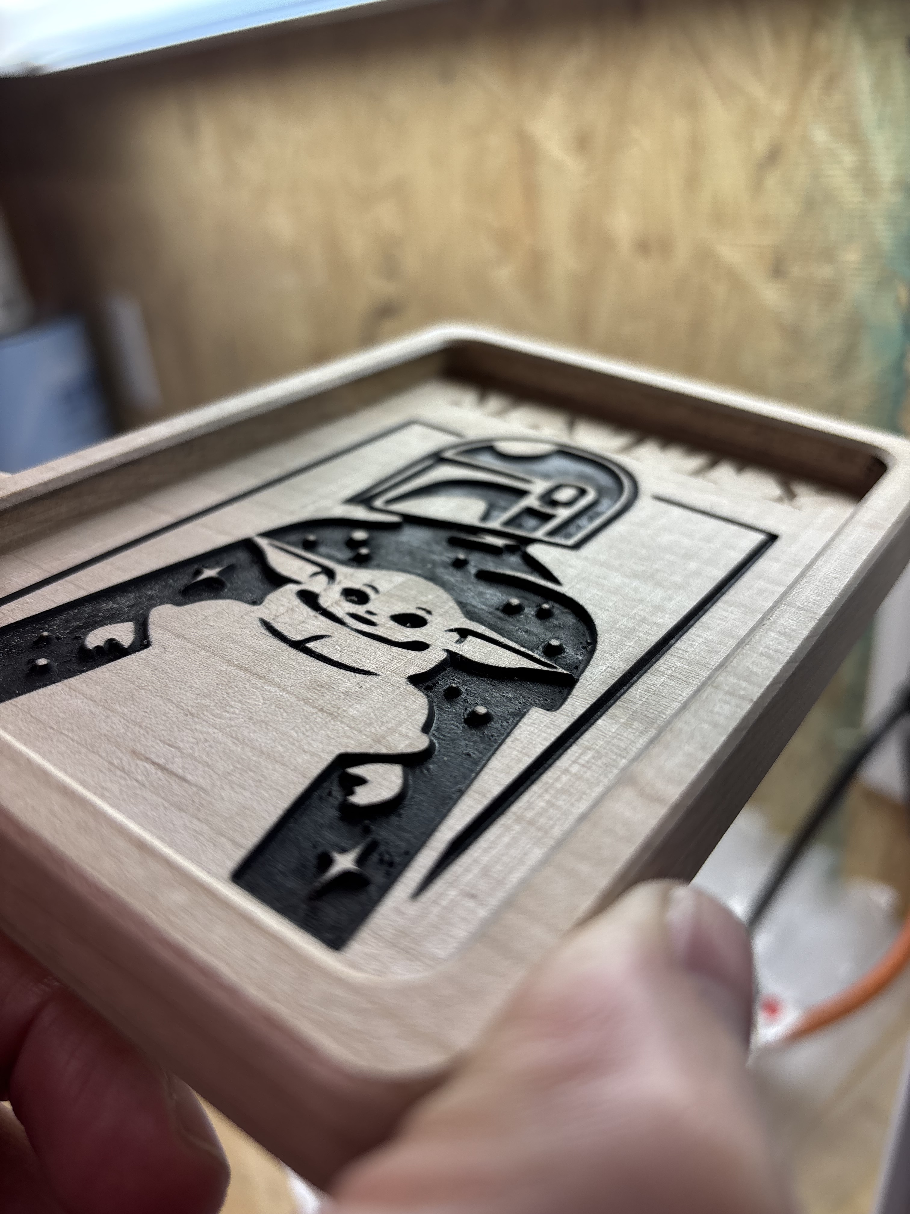

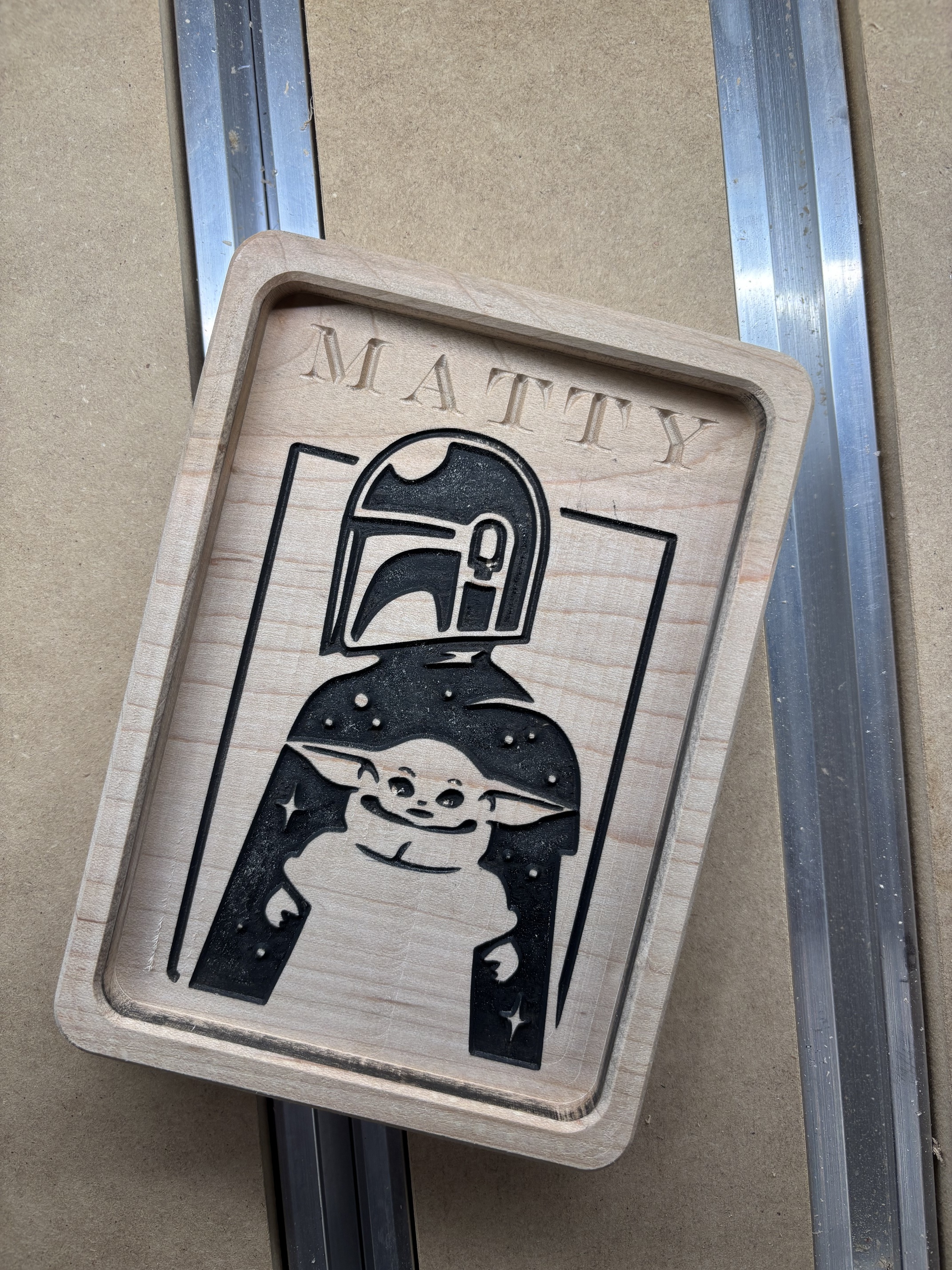

Advance Vcarve with a 60° Vee groove bit and either 1/4" or 1/8" Endmill works great for me.
One method I used with success for the darker color is black paint. Carve the image out (assuming your doing a vcarve of the image), spray the paint and let it dry and then take a mm or less off the surface. I would do it on a trial piece to see if you like it. I did that in this project:
I will definitely do it again and it’s a QUICK way of accomplishing a very cool effect.
Very nice!
BTW, some people use a “sanding sealer” like Zinsser, which I believe is a dewaxed shellac, prior to painting and resurfacing as it will stop the paint from bleeding into the wood grain.
@beep_beep_morales
That is a fantastic tip!! I will be utilizing that information even today.
Thanks :blush:
The Zinsser Universal Sanding Sealer is dewaxed shellac. The good thing about this product is you can use it with water or oil based top coats. On very light colored wood like maple it tends to give it a slight yellow (warm) tint which I like. However if you dont want any change in wood color use Polyurethane Polycrylic sanding sealer which is water based. It does not change the color of the wood. If using water based plan on the grain raising so you usually apply a coat, let dry, then sand and apply a second coat of water based sealer. With the shellac it does not seem to raise the grain.
The sanding sealers do tend to keep paint from soaking into the wood grain. Around the edges where the grain has been opened is where the paint can soak up inside the grain and make your project look muddy. By sealing up the capillaries of the wood grain you help prevent the paint from soaking up inside.

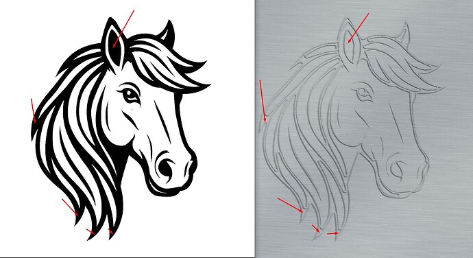

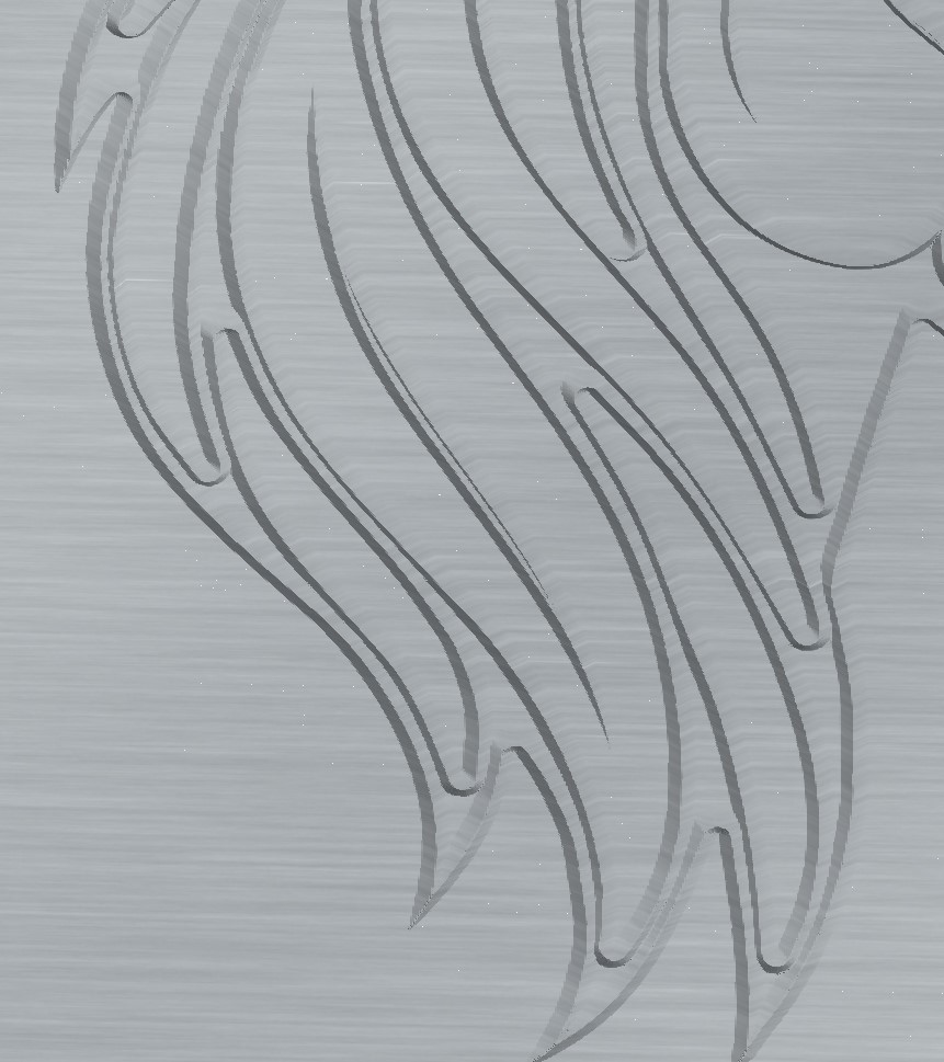

Here’s what I mean, see image. It looks really bad.
You’ll notice there’s tons of problem areas and overall it just looks terrible the way it’s choosing to carve out certain areas improperly.
What’s the process when vcarving an image like this?
Should I be unlinking the image and then modifying areas / hand selecting where to pocket out with the vbit, then do contour of other areas?

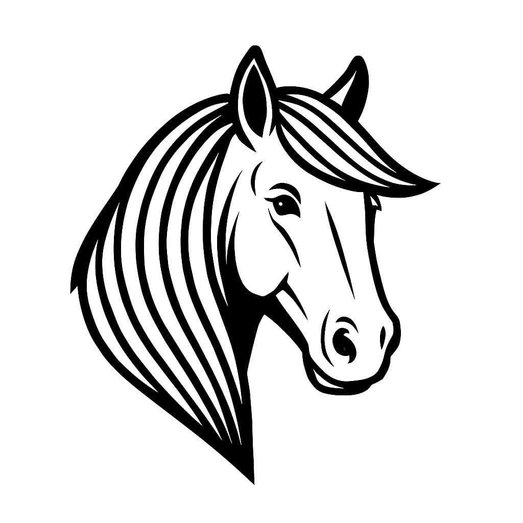

Just for clarification. All areas of the original image that are BLACK must be carved out, that’s all I want. If you look at the result and the project file it’s not doing that.

It’s a piece of walnut that was surfaced with high step over, it’s perfectly flat and then I zero’d off that. It should be alright on that end. From my perspective there are 2 possible issues:
  1. When I’m loading the image into carbide create I’m not doing something right and it’s creating bad pathing and traces from the image (I tried inverse but doesn’t work either)
  2. I’m supposed to manually choose areas to pocket and contour
I’ll upload some more images showing the problems
You can see it’s not targeting all the black parts of the image. Instead it’s doing contours and stuff when it should be pocketing out all the black.
Enable the option for “Pocket Clearing”.
Perfect, Thanks that’s the fix!
