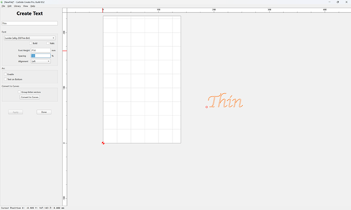

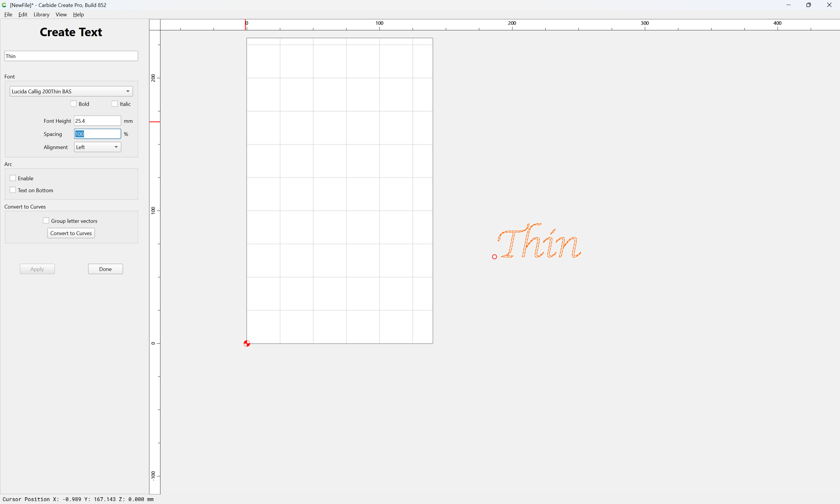

Carbide Create uses the fonts which are on your computer (in addition to some number of fonts which are bundled with it and only accessible in it).
This means that you can install any compatible font and then access it in Carbide Create. Another option is to use the About dialog’s “Open Data Directory” button and place fonts which you only wish to have available to Carbide Create in the fonts folder inside the Carbide Create folder.

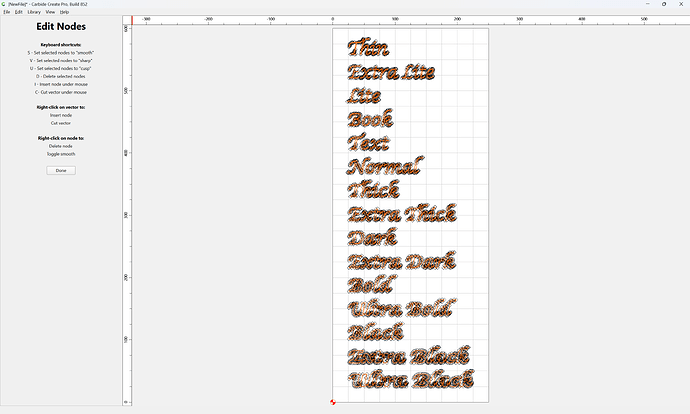

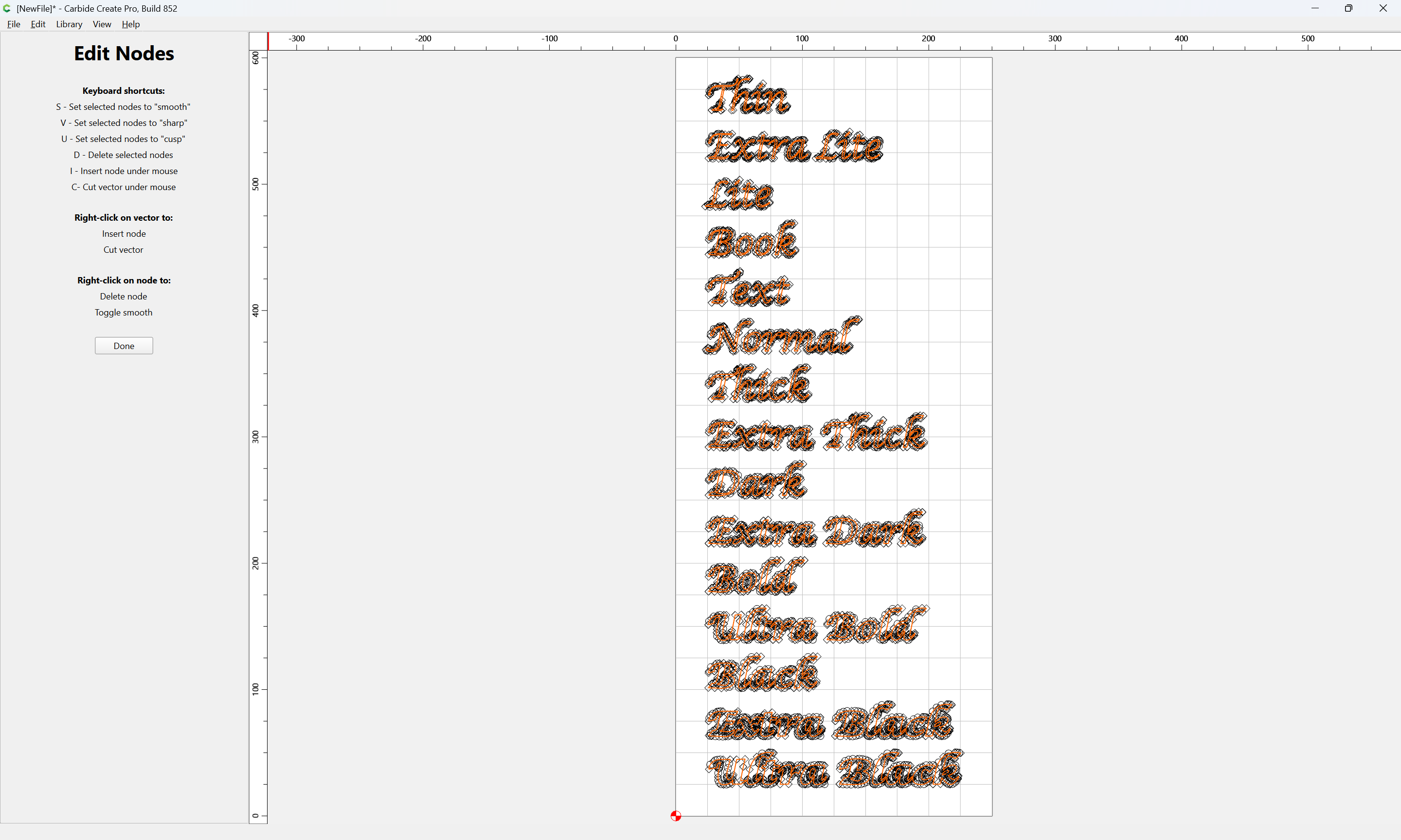

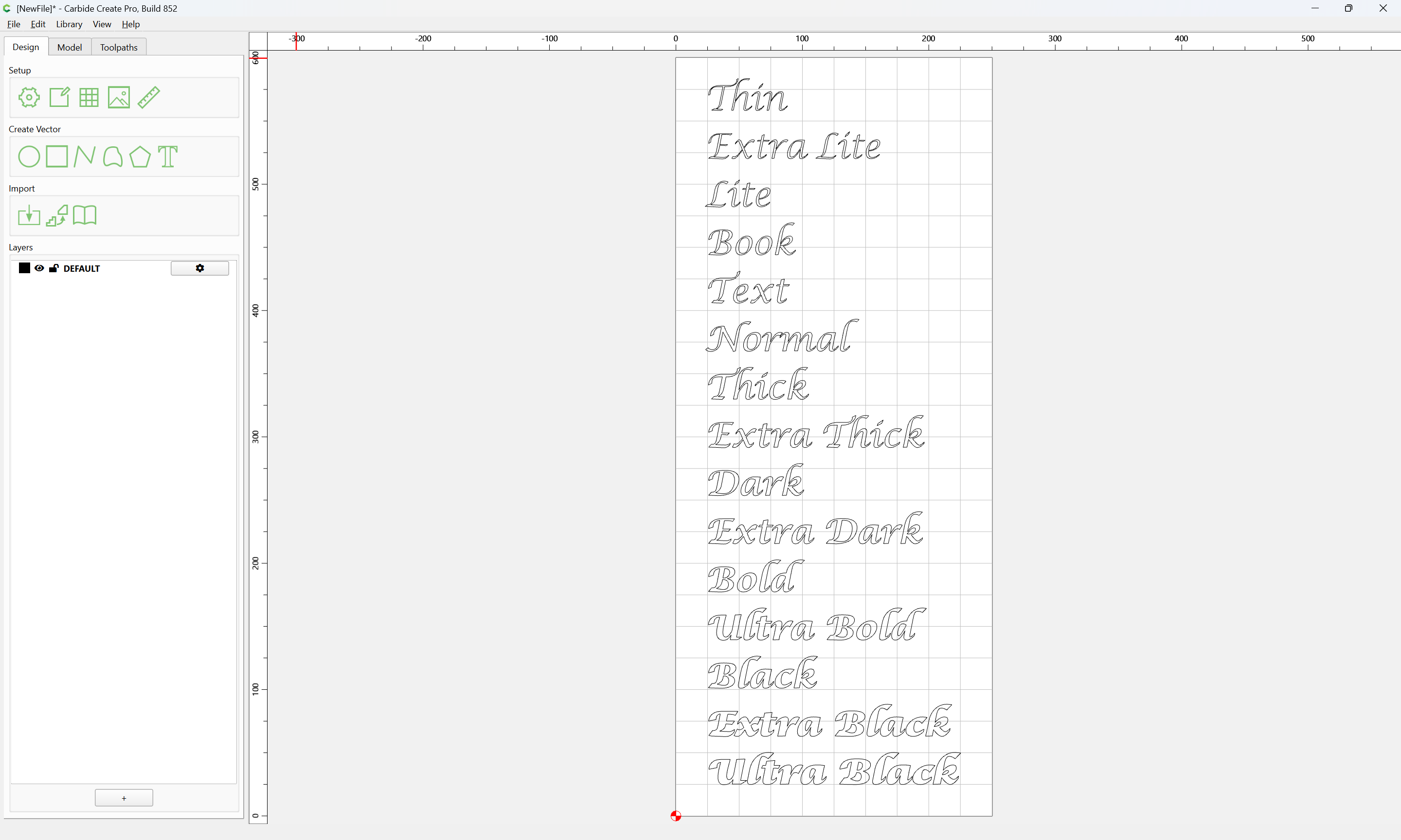

Lucida Calligraphy by Bigelow & Holmes:
is available in a range of weights from Thin through Ultrabold — it might be that one of the heavier weights would work for your epoxy usage.
Here is a file of the weight names set in the matching font at 1" height and converted to outlines:
Lucida Calligraphy Weight Samples_v8.c2d (672 KB)
If your purchase one or more fonts (I’d suggest getting the entire set — gotta catch 'em all), please give my compliments to Prof. Bigelow and Ms. Holmes.
