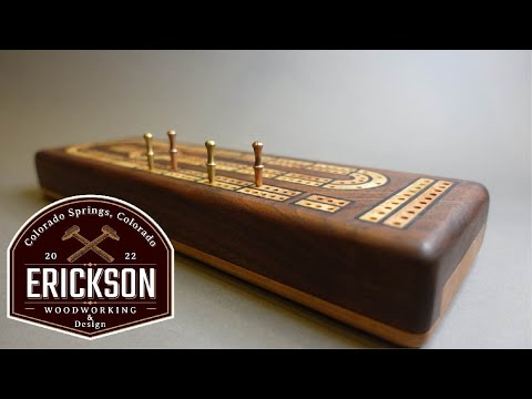

Well….I’ve been playing with this idea for a long time. Let’s see if it turns out.
I cut the player track on my laser. I’m going to fill the gap with clear epoxy and then face it down to .005 to protect the veneer. Then cut my black lines and fill with black epoxy.
After that cures, I’m got a super nice 1/32 spiral up cut bit to cut the letters and numbers and then fill again with a silver.
Fingers crossed :crossed_fingers:

Done for the night. I really like the burl veneer. Super excited to see this come together.
So glad I encased the veneer in epoxy. No tear outs and everything is crisp.
I still have my final depth to clear out after the pour tonight and tomorrow, but everything is moving along quite nicely.
Decided not to cut the letters and numbers and go only with the holes.
Still holding up :nerd_face:
First time doing a track underneath, liking the dovetail look
Super please with this experiment. Not happy about the E, but in the end, everything turned out. Veneer is so delicate and I’m actually amazed it came out on top.
Material: Walnut, cherry, Fir Burl, Pepperwood Burl
I’m putting together a YouTube video of the entire process from start to finish. I’ll post it once I learn how to video edit. :nerd_face:
Cheers and thank you Carbide3D for making such a great machine!!

Very nice work! Did you do the sliding dovetail on the cnc also? Cant wait for the youtube video of the process, im looking at making one for an xmas present for my father in law.
I used my router table for the sliding dovetail. Walked it in for a tight fit. It really helps when you cut to exact dimensions. Total width was 4” and the dovetail is cut right at .5” on both sides.
I’m hoping to get the video out this weekend
Alright….take it easy on me! I just uploaded my first ever YouTube video of the Inlayed Veneer Cribbage board. Please check it out and like / subscribe! Super excited as this is the first video I’ve created.
