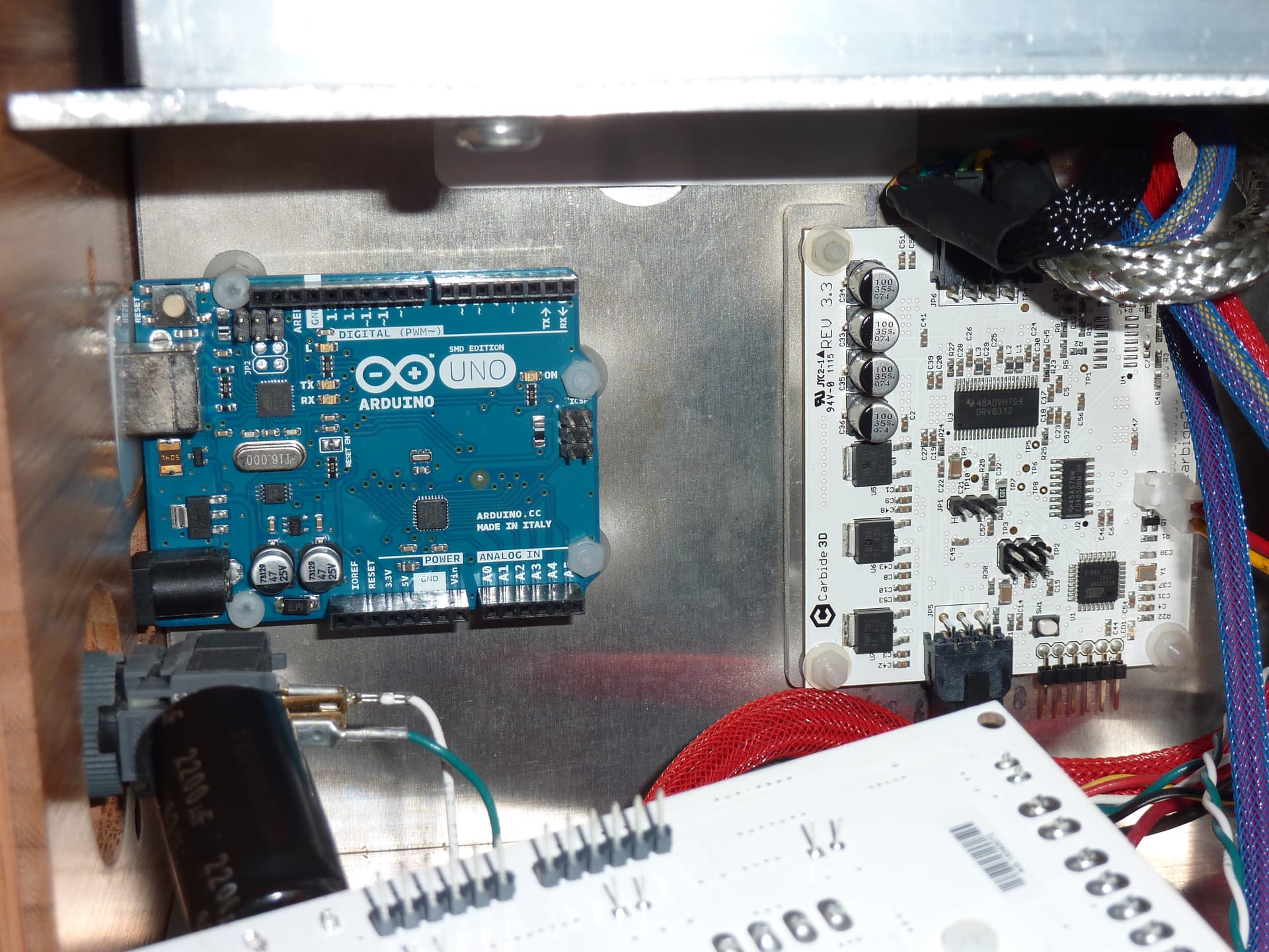

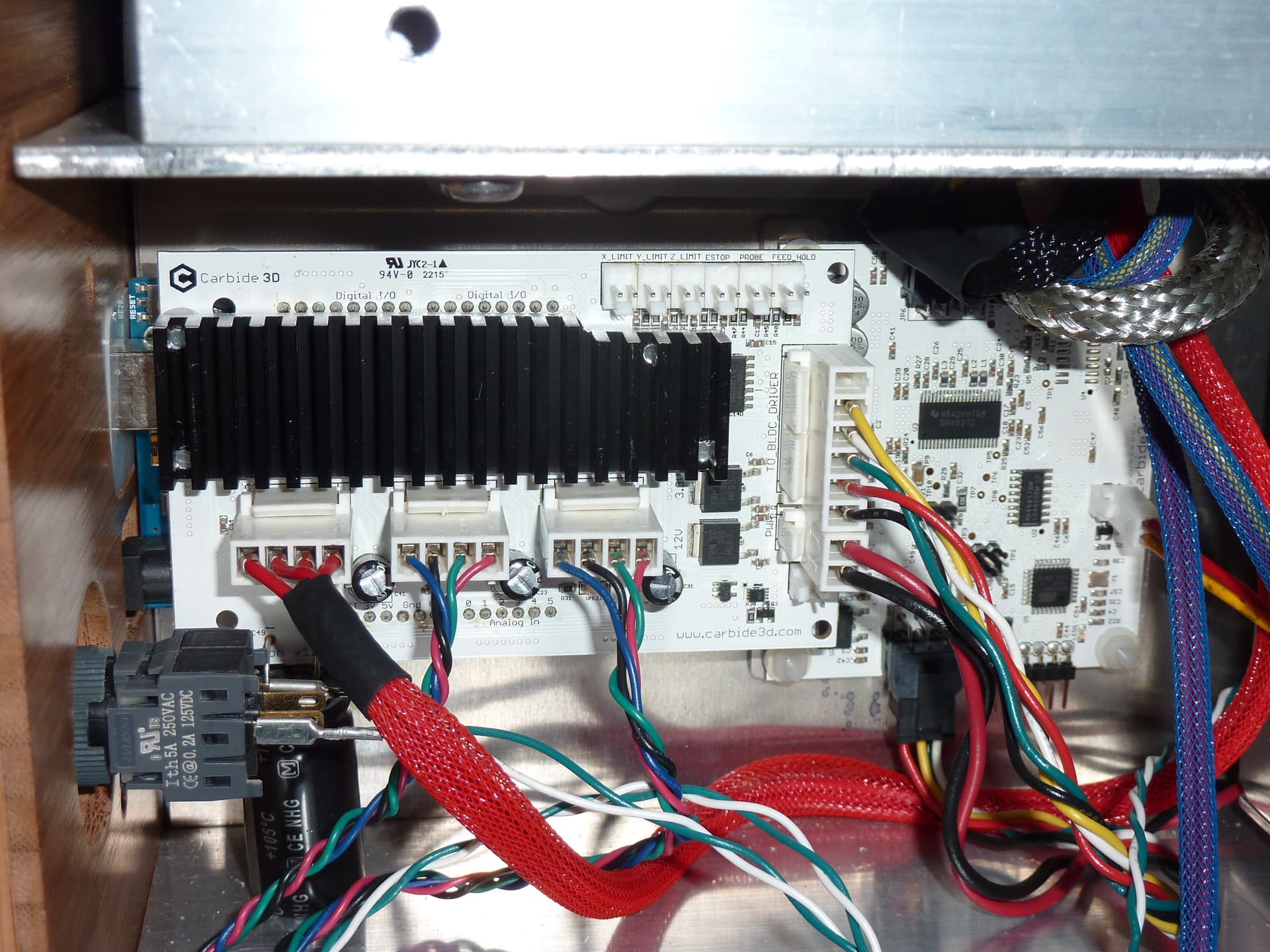

As amends for the hijack :slight_smile: , I will add this. Brandon at Carbide Support (thank you for the call, Brandon!) told me that the early Nomad 883’s with the Arduino Uno and Carbide Motion stepper motor shield:
and the internal power supply, can’t have the current integrated Carbide Motion board swapped in,
I’ll point out that the photos are of my somewhat-modified “Classic Plus”, notably the heatsink and cabling…
