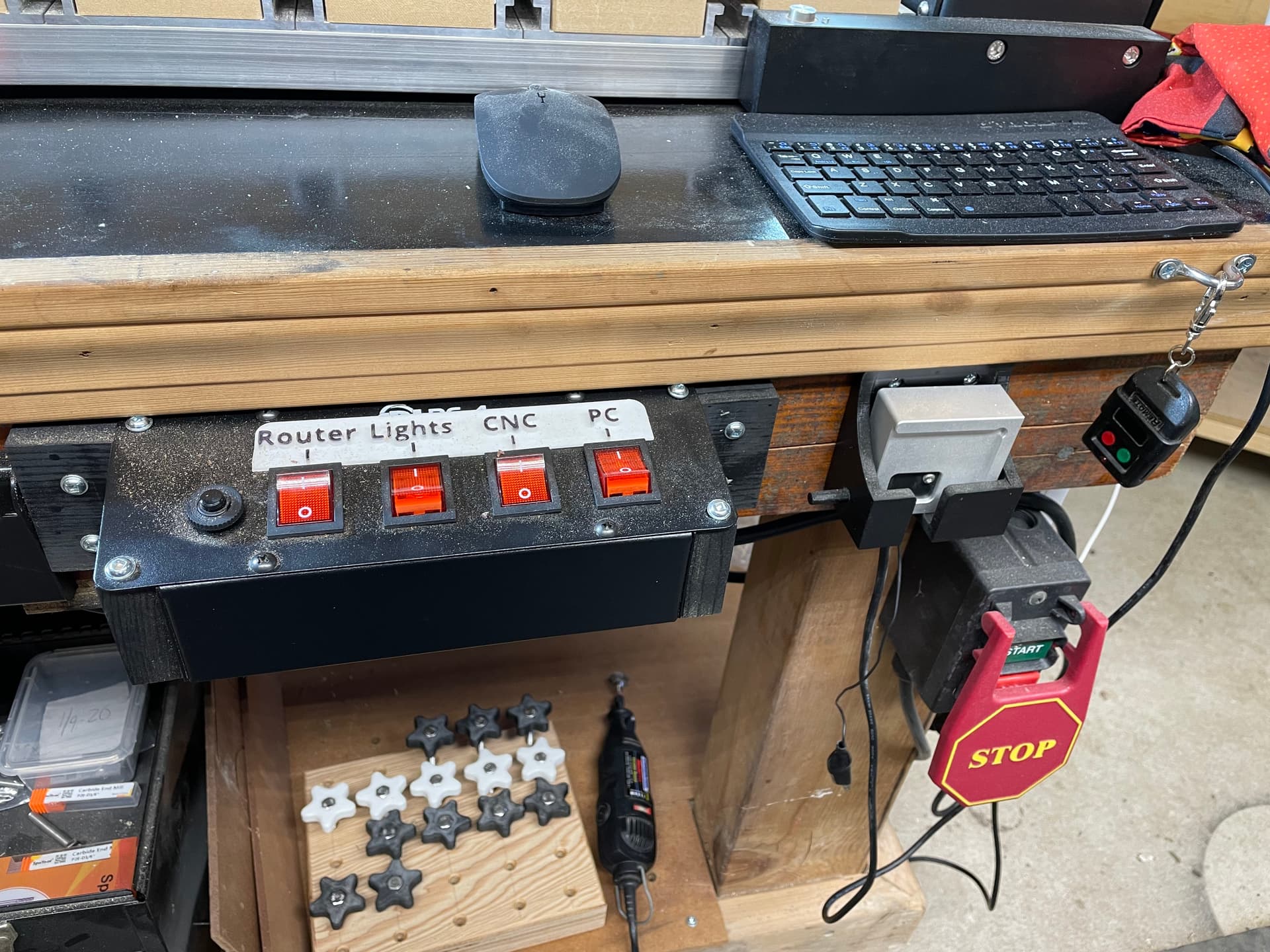

I have an E-Stop that shuts down everything (knee height, easy access, and luckily
only used it once or twice in the past six months), as well as four individual switches - one for each of the Router, the CNC itself, the LED lights and the PC (although its a Fusion Tablet and switches to battery in any case).
My knock-off Bit Zero and wireless keyboard sit in 3d printer holders right there.
Also, on the Shapeoko table I have mounted a hook for the remote that controls dust collection, which is overhead (20x20 extruded aluminum and 3d printed brackets/clamps) and then drops to the back of the table to the main pipe, which I swap occasionally with my table saw and route table.
Also have a desk lamp rigged with super bright led panels, as well as LED strips along both sides of the machine, and the bottom of the gantry. Can never have too much light in a shop!

I don’t have any of the elaborate consoles as our Shapeoko fraternity brothers. I use a foot pedal I bought from Harbor Freight for around $15 and have it mounted right next to my work area. I even designed my own STOP sign and mounted it. I’ve used it many, many times and it works great.
