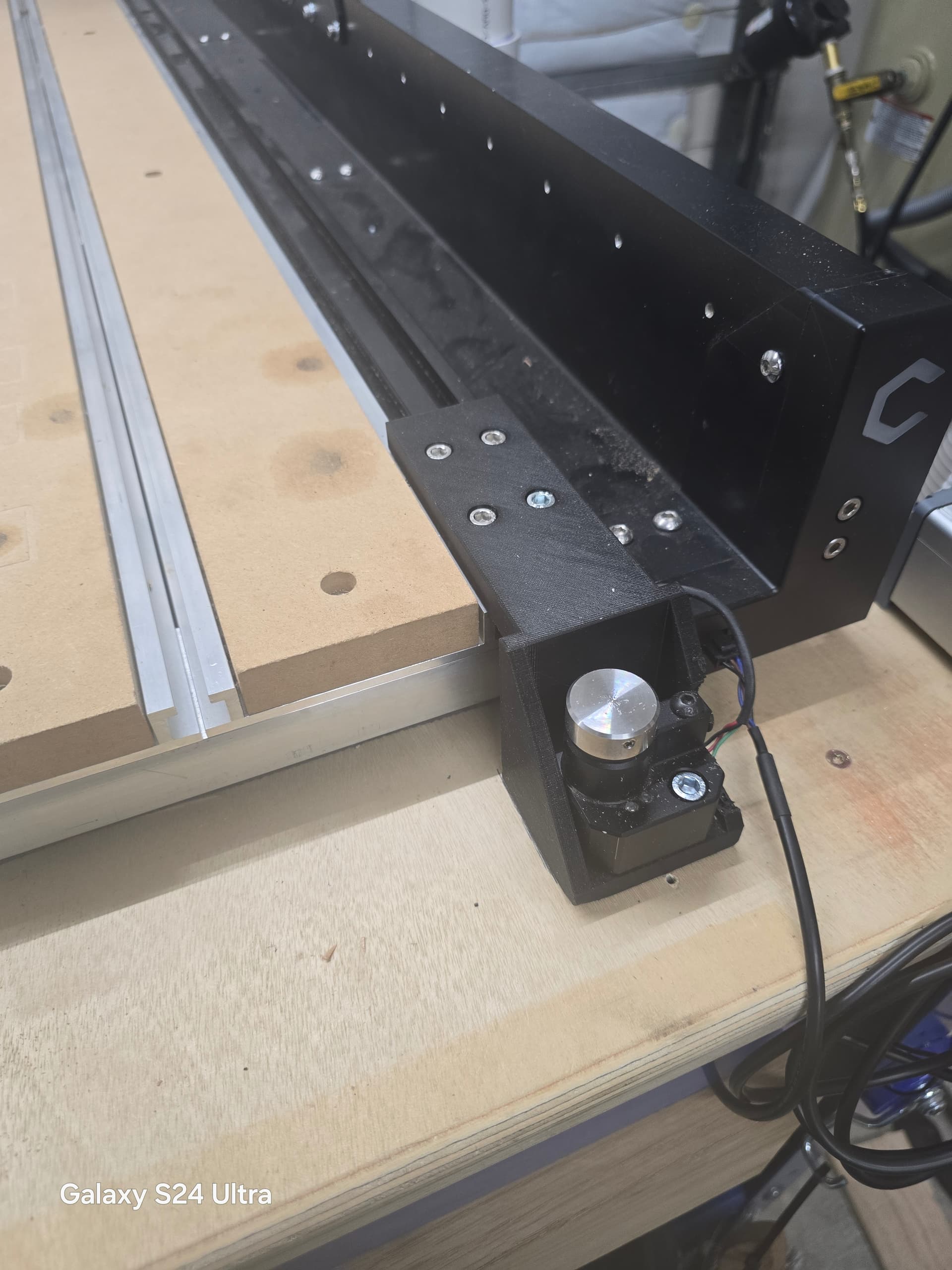

In the past, with my SO4, when I had a tool change in the middle of a job, when prompted to “Insert the next tool”, I would remove the magnetic Sweepy dust boot bottom, swap the tool, press confim, and then the bitsetter would do it’s thing. The router would return to the position just to the left of the bitsetter, and prompt me to set the RPM on the router. THIS is when I would replace the dust boot bottom, Confirm, and then… happy days, the machine goes on and cuts.
So, my question is now with the VFD Spindle on the SO5, once I change the tool, the machine goes to the bitsetter, measures, and then the Spindle starts and it goes to cut - how do I “pause” it to replace the dustboot???
