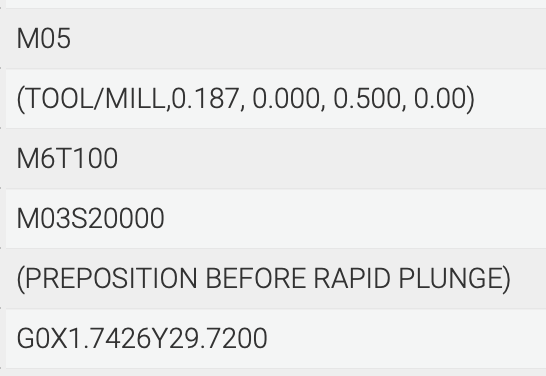

My VFD stopped spinning mid-cut and I’m lucky I saw it stop before it plunged again. No idea what happened that would have caused this problem.
I double checked the VFD and sent the MDI code:
  • M3S18000 reads 275.5 RPM
  • M3S20000 reads 305.0 RPM
  • M3S24000 reads 396.0 RPM
M5 sends it back to 0, as it should. Needless to say the VFD doesn’t spin at all at these low of RPMS.
My VFD runs at about -10% of the G-code RPM, which I’m told is normal. But this makes me very very worried for future cuts.
What is happening to the VFD?
The G-code in my file reads M03S20000 - and it has the same RPM.
