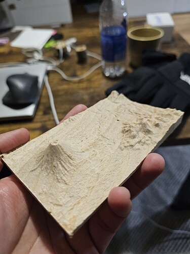

First test is done, feels like I can definitely push the machine a lot more. Was running it at 4mm DOC, 2.54mm step over and 3000mm/min feed rate at 18000rpm using fusion 360’s adaptive clearing toolpath with the #201 endmill. Spindle was only pulling ~120-150watts.
