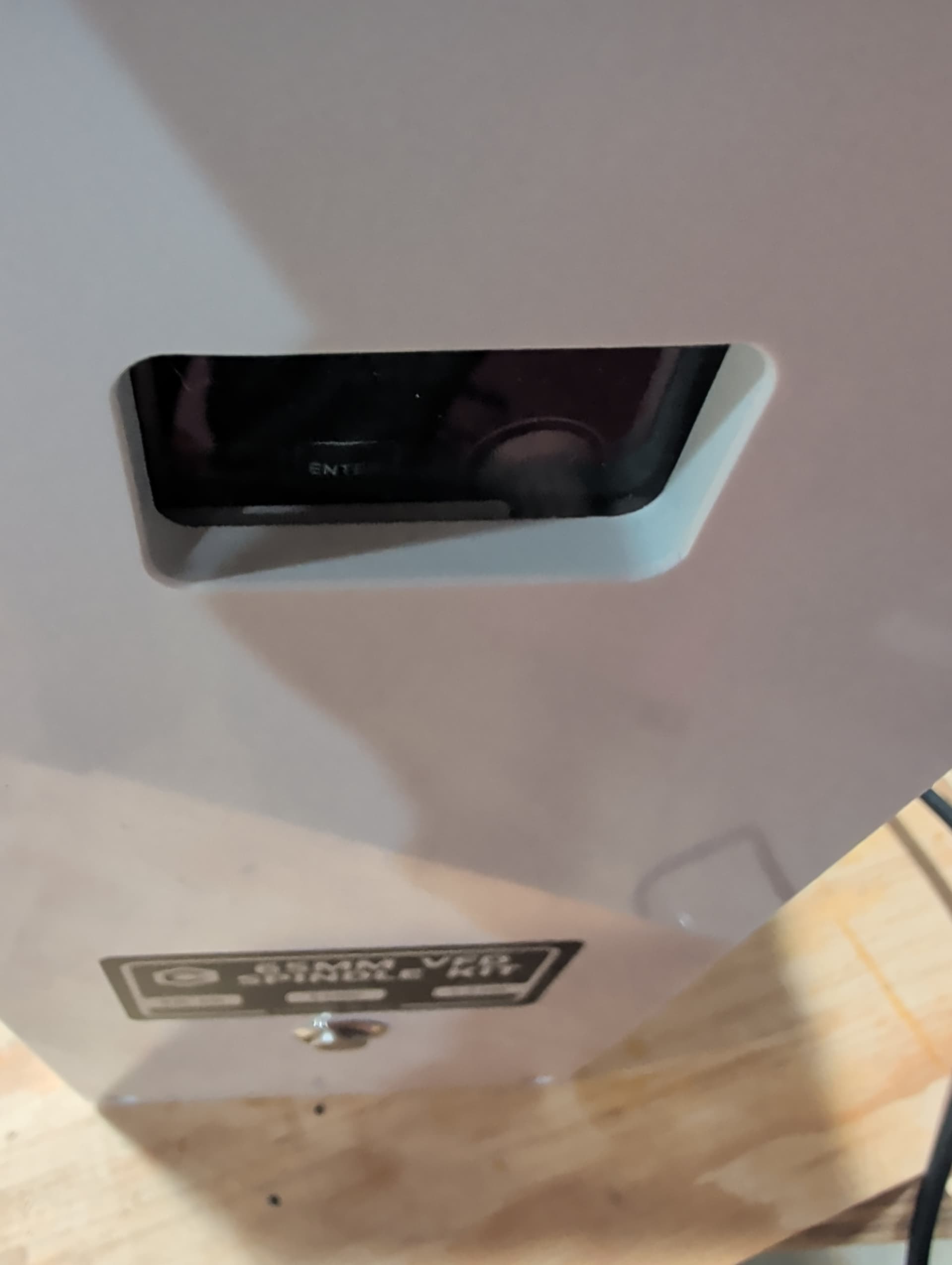

I just noticed there is a nob behind the front plate. Do these do anything?
They do, but nothing you care about. In general you don’t want to go poking at the VDF unless you really know what you’re doing.
I’m not sure if the VFDs settings are locked these days but they definitely used to be so you wouldn’t be able to do much with it anyway.

Vfds have to have several things changed on them to switch between g code controlled via 0-5pwm signal and manual control via a knob. It’s a couple settings, a jumper and a wire that need to be changed from my experience.
From what I’ve read carbide locks their vfds down with a password so you couldn’t change it if you want to. I understand why they do this because you can easily let the magic smoke out of the vfd with a setting change.
