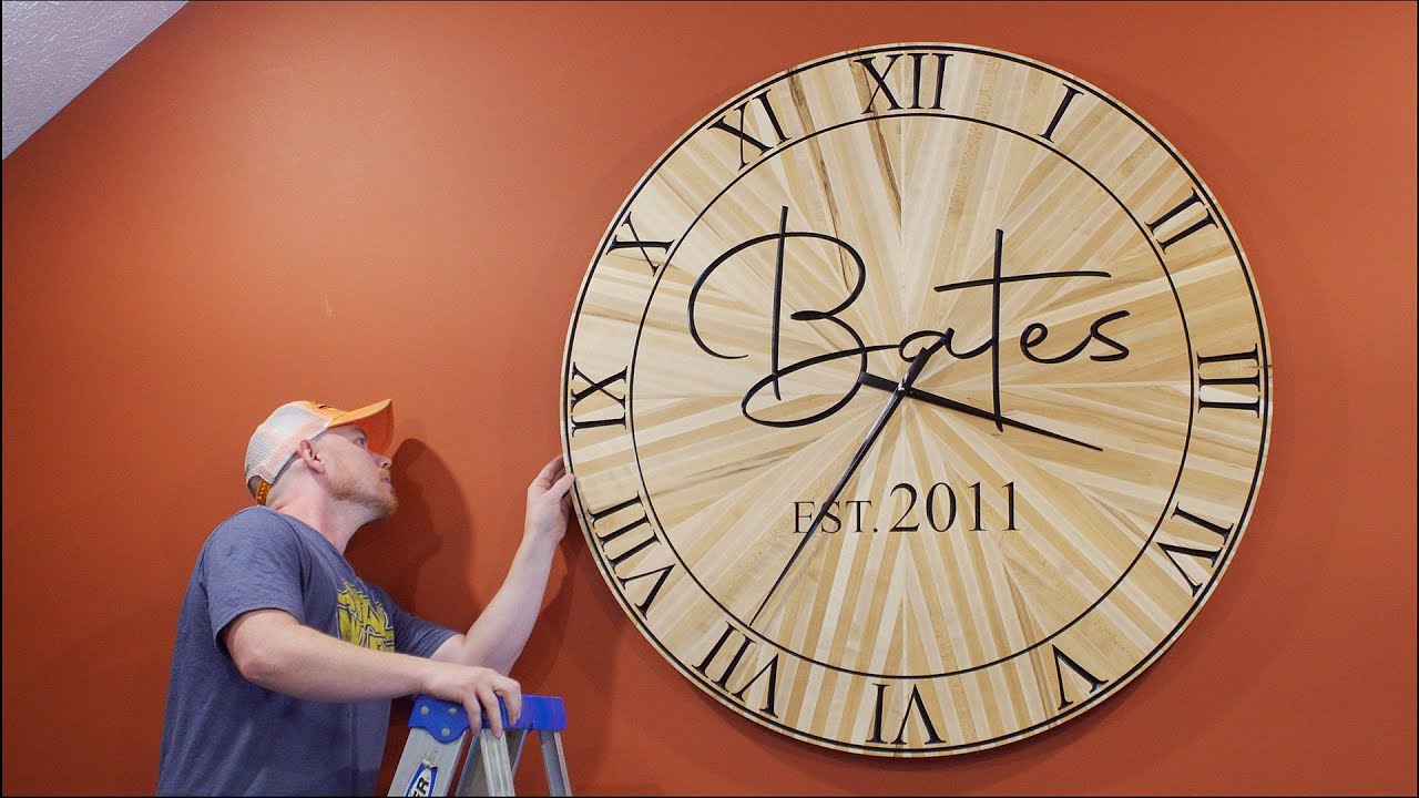

I went on a clock movement hunt yesterday and discovered there’s something called ‘high torque’ movments. Now I want to make a giant clock. :grin:
Here’s one Jay Bates made. He has great videos, I highly recommend checking out his channel.
