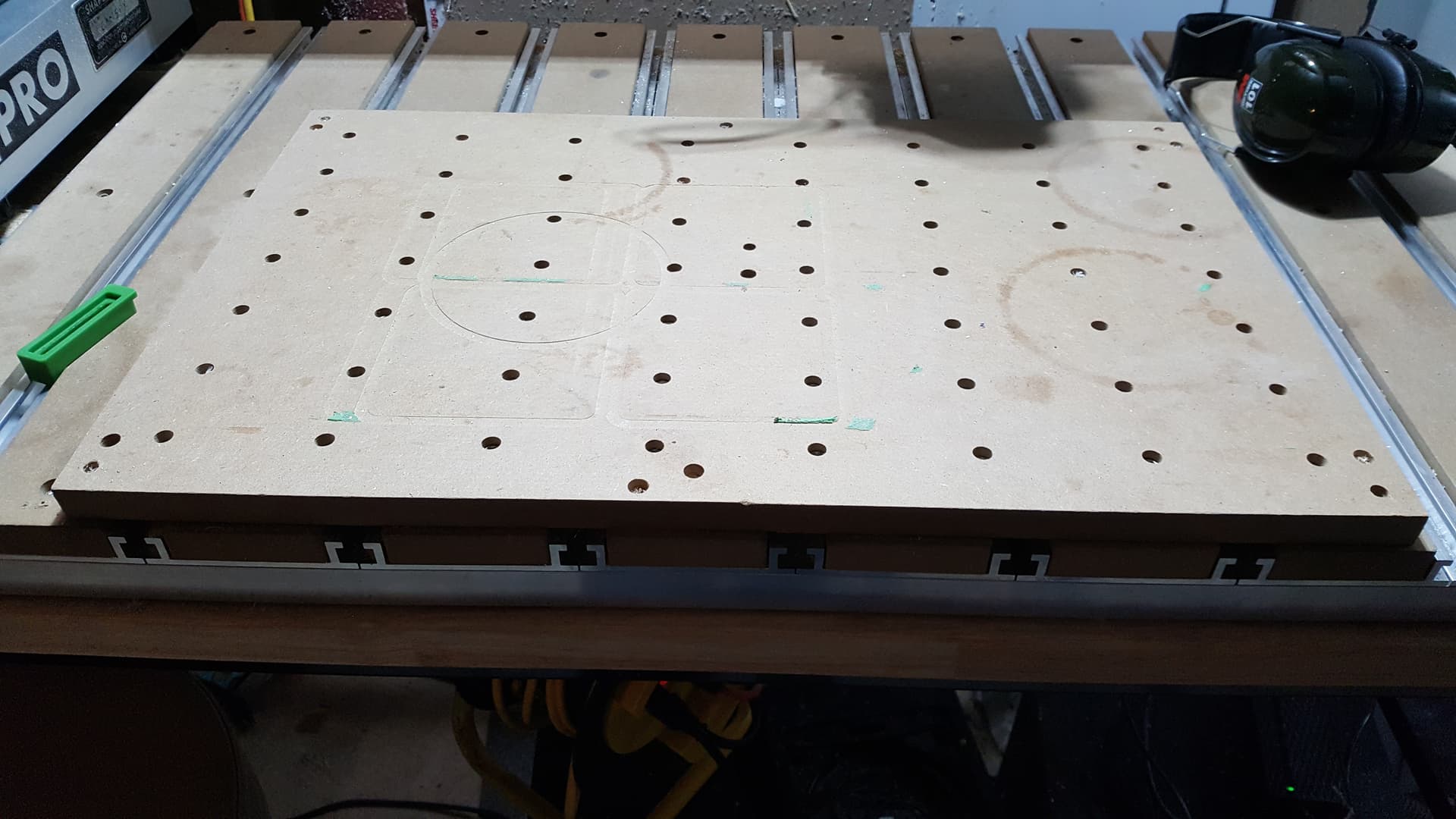

I’m hoping to get a little advice here. From the day I got my pro xl, i’ve had trouble trying to get a perfectly level wasteboard. I use a secondary mdf wasteboard that i screw down to the mdf slats and surface that on a fairly regualr basis. For most of what I do, regular surfacing has been good enough but i’ve started making epoxy coasters and after running one or two surfacing passes to remove the epoxy, i end with a inconsistent surface, typically a difference of .01-.02. Any tips on what i can to do improve this? Would tramming help? I’ve always been scared to attempt that in case i make things worse.
Could you post a photo showing how the secondary MDF wasteboard is attached/mounted?

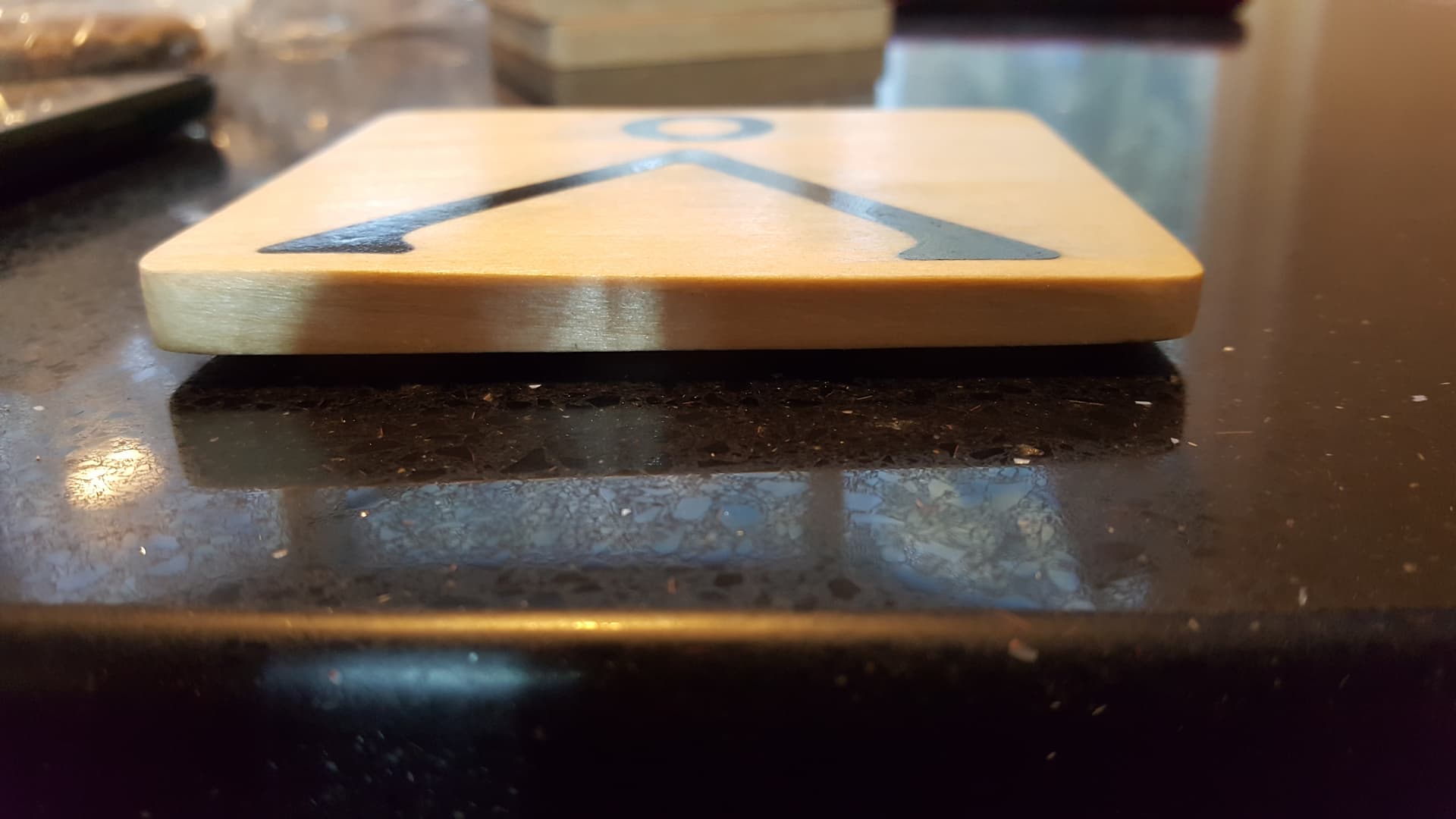

Ive just attached it by screwing it down to the mdf slats. Ive also attsched a photo of what happens after a couple of surfacing passes. The weird thing is, i can run the hello world test and it looks great yet i have problems like this when cutting.
How do you attach your coaster stock to the upper waste board? Reason I ask is that it may be possible that your waste board is flat, but the coaster stock is not being held down flat against the waste board.
If the coaster stock is being held down to the waste only at the corners, it is possible that you are creating a bow in the coaster stock because the downward force is only at the corners so the middle is higher than the corners (does that make sense?).
If the pictured coaster was originally in the upper left corner (from your waste board I assume you make 4 at a time) then that would explain why the lower right corner of the coaster is thinner than the upper left corner.
The green stuff on your waste board also makes me wonder if you are attaching via two-sided tape. If that is the case the tape may be slowly letting go over time. That assumption is based on the epoxy that you may have this stock on your waste board for several days.
While it’s somewhat tedious, you can measure the Z height at multiple points on your coaster stock and see if there is a variance that you can’t measure on your waste board.
Thanks for the tips Robert. I’ve been using painters tape a glue as my work holding so my stock should be staying flat. Since the picture posted, I resurfaced my waste board again and tried to surface another coaster and while not as bad as the photo, there is still some inconsistences. You may be on to something however, looking at the new coaster a little more closely, it seems that it’s one corner that’s sloping slightly.
Just out of curiosity, i just surfaced off 1 more coaster on a different spot on the waste board. Both coasters are slightly sloped in the top left and bottom right corners, about a .01 difference on my calipers. Measuring from the 4 sides all read equal. What do think think this tells us?

Have you tried using a dial indicator or test indicator and running it across the fresh surfaced wasteboard to see if it is actually facing the top flat? You might need to get some cheap screw jacks and mount under the bottom wasteboard and jack it level and then re surface. You might of already tried this but hope this may help
With a recently surfaced spoilboard, I see very little possibility of anything coming off the machine not being of a consistent thickness. Can you try a different workholding method like double sided tape? And also, I second the dial indicator idea to confirm both the flatness of the MDF, but also your workpiece. Is it possible that the epoxy and finishing has caused the coasters to warp at all?
Just curious if you ever surfaced the hybrid table MDF slats because if not and you surface an extra wasteboard as you have it would be parallel/flat at first (with the spindle), however if you move or rotate this extra wasteboard the result could be the unsurfaced hybrid table coming back to haunt you. I’m thinking when you screw the mdf board to the hybrid table it’ll bend and take it’s shape and if it’s uneven then your extra wasteboard will not have 2 parallel faces and could cause issues if not installed in the exact same location/way as it was during the last surfacing job.
